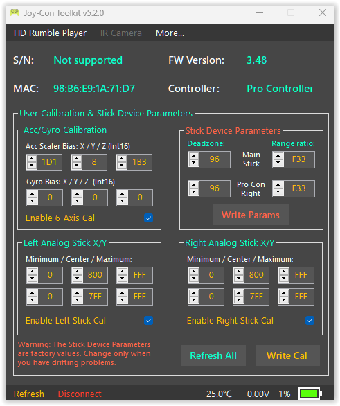

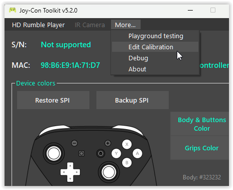

How to change deadzone? There is no guide for this, I'd like to decrease deadzone after installing Hall effect joysticks. Also: does this overwrite firmware? Making them unable to update through switch software?

Can anyone explain how the center point calibration works on Pro controllers specifically? Am I understanding correctly that the Pro has a native dead zone that it applies to output, and that the "center" values in this tool just move where that zone's center point is... not the actual center points of the sticks themselves?
I installed the Gulikit TMR sticks and have been having center point issues with them and the guides provided on the Aknes discord aren't the clearest to follow. As far as I'm aware, there's no way to change the actual center points apart from maybe just stretching the overall range of the stick in one direction or the other, but I don't really notice any movement even after doing that...
