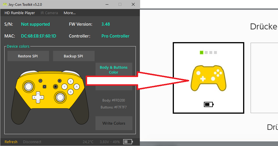

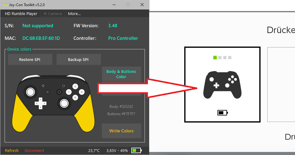

Hey uhm... so my Switch is on the latest 8.1.0 Update and all of my controllers are up-to-date,
but when I change the colors of my Pro Controller, the Switch only takes the colour of the body and displays the grips in it aswell..
Here are some examples:
Why is this and is there a way to make it as before?
View attachment 177018 View attachment 177019
This is a known issue that the OP claims he'd address next time he worked on it, but he hasn't been active on this for quite some time, so it appears that this project is dead at least for now and we just gotta deal with the pro controllers sadly not able to show the correct grip colors.
