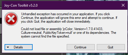

Hey so I click "Body& Button Color" and an error pops up (attached). Any help would be appreciated.
-This happens with both joycons
-A SPI backup has been made for each
-When I click continue, nothing happens
