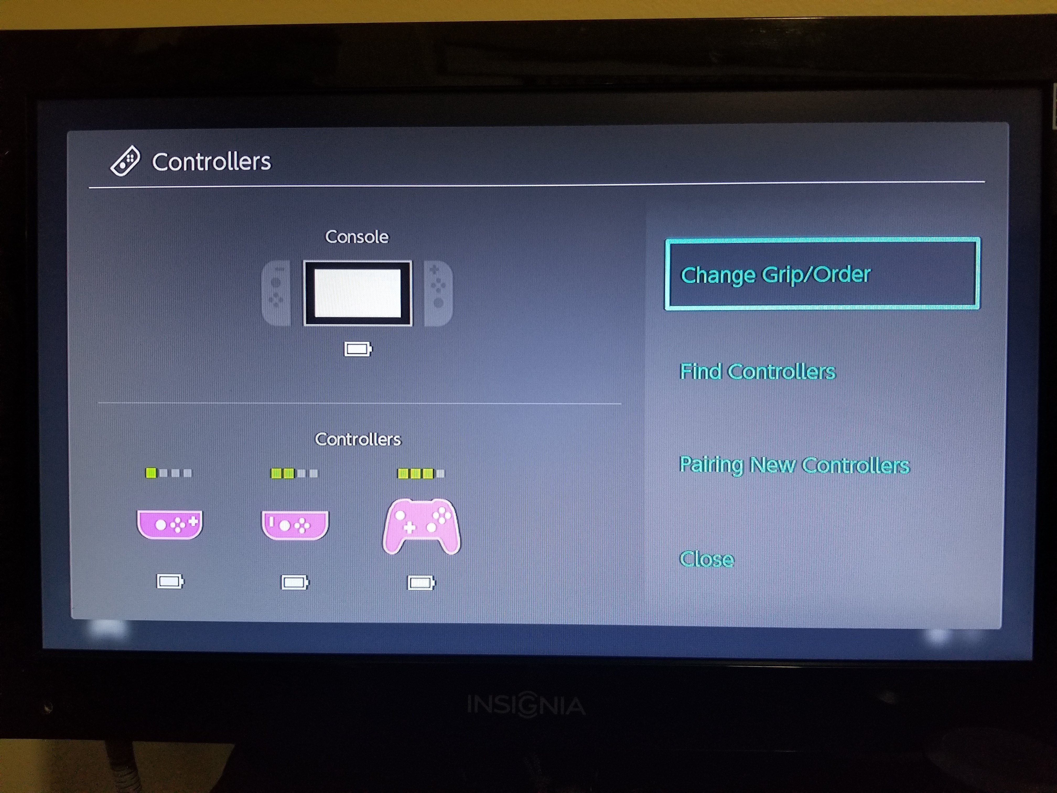

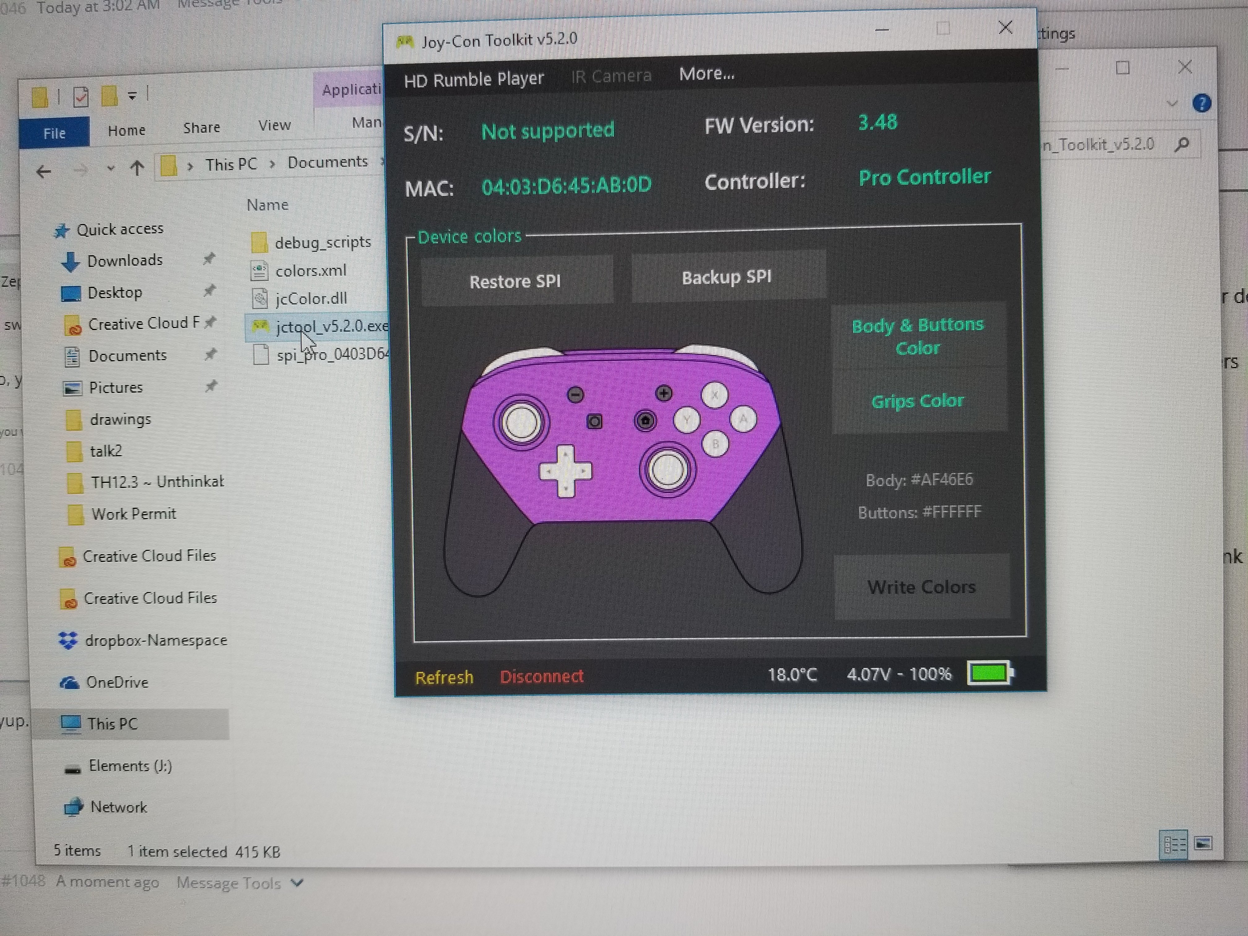

I'm having some issues with my pro controller. For some reason, my switch does not want to recognize the grip color changes. Instead, it takes the body color and covers it everywhere. I find this very strange because I was able to do it before where the switch recognized I changed the grips to white and it was working fine for a while. At least until I switched to the 5.2.0 update.
yup. the tool shows a controller with different colored grips. the switch shows a single colored controller. I already tried changing the colors of the body and the grips around but all it does is change everything to the same color on the switch.

What were the grip colors?
Maybe they changed the algo again in 6.0.0

the way I had it before was with white grips and buttons (so that I could tell the difference from my third party controller.). I recently got a faceplate and wanted to make it match, but instead, I got what's in the pics
Well it's easy to have the white grips. You just change the button colors.
But in order to have grips, as I said, the only thing needed is 0xFFFFFF buttons and whatever body/grips colors.
Probably something changed in 6.0.0.
EDIT:
Play a little with button combos. Like giving a color or black (0x000000)
If I remember, newer versions of switch fw, disable the led.
Try to press the sync button and reconnect them. The button remaping has nothing to do with that. It's more because of the reconnection, which you can do it from switch also (by removing it as a registered joy-con and attaching it).
Switch fw 5.1 and up required.
so youre saying i cant have the grip colors cause my controllers are up to date and my switch is at 6.0

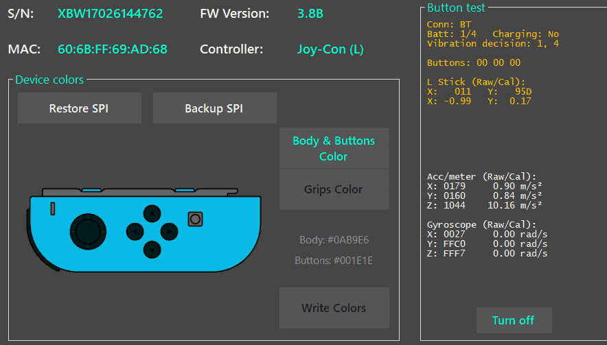

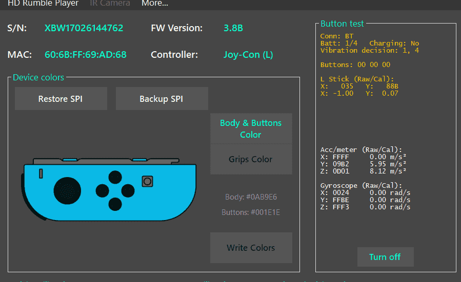

Here are the screenshots of the config in my left joycon, which stick I wanted to effectively "kill".
I put the deadzone to FFF. And these are the screens after putting the stick deadzone to FFF, and after writing to the SPI.
This happens in neutral (when not touching the stick at all in the Caibration Test):
This is making the stick all way to the right (the problem is it always goes to the left):
And here, the params of the stick calibration:
Is there any settings I'm missing? Thanks everyone.

Yes, ever since the 6.0 update. Whatever color you choose for the body it will automatically select that for the grips color, regardless of what color grips you choose in the program.
this is great!!! there is a little problem with pro controllers tho. when i change the grips, it changes nothing to the controller. but the body changes the entire controller with along with grips (on switch).
Well, it seems that 6.x changed the algo. So until we check if there's a way, probably not.
What it seems, is the case now, is that it only supports the official grip colors now.
