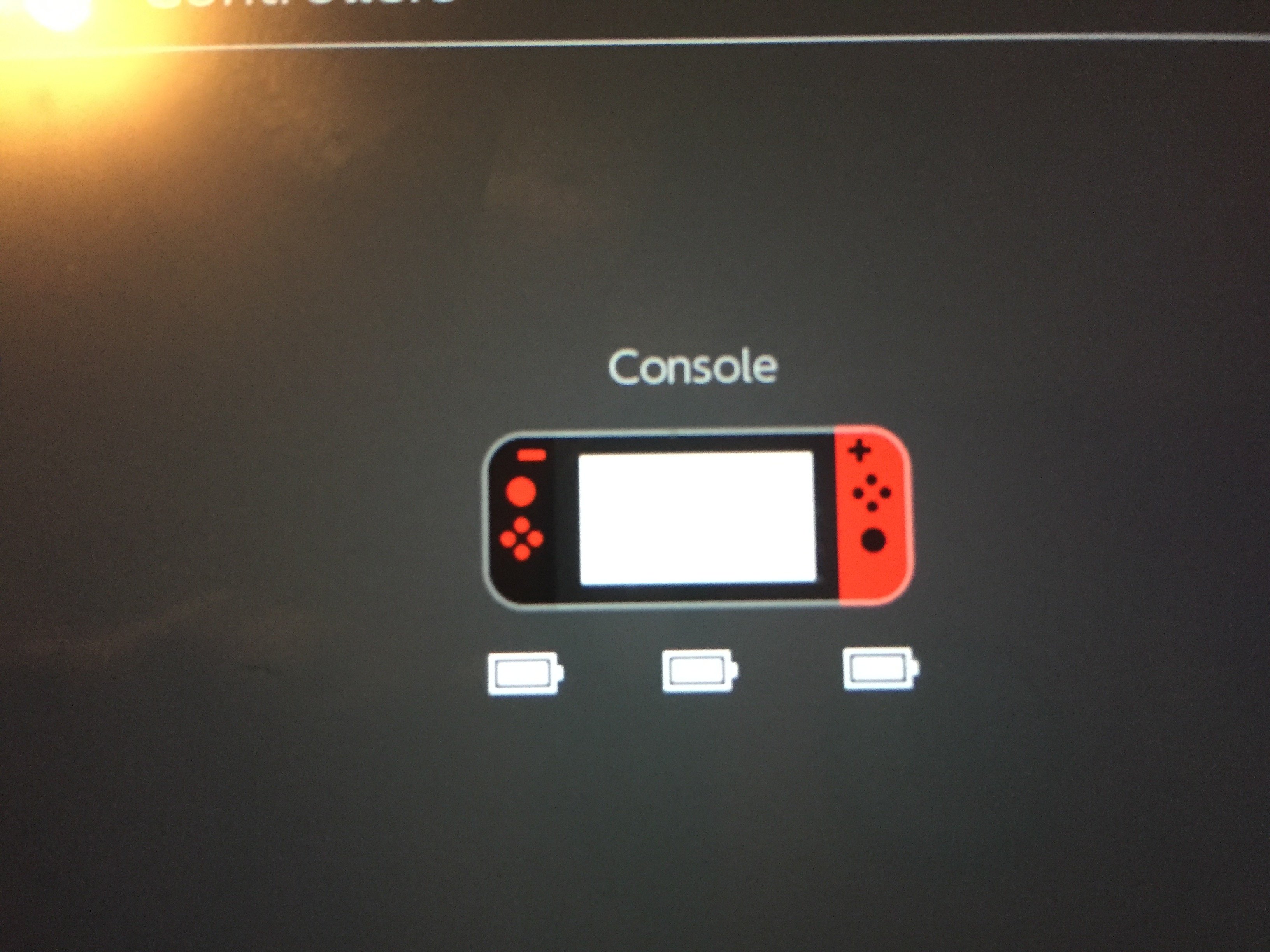

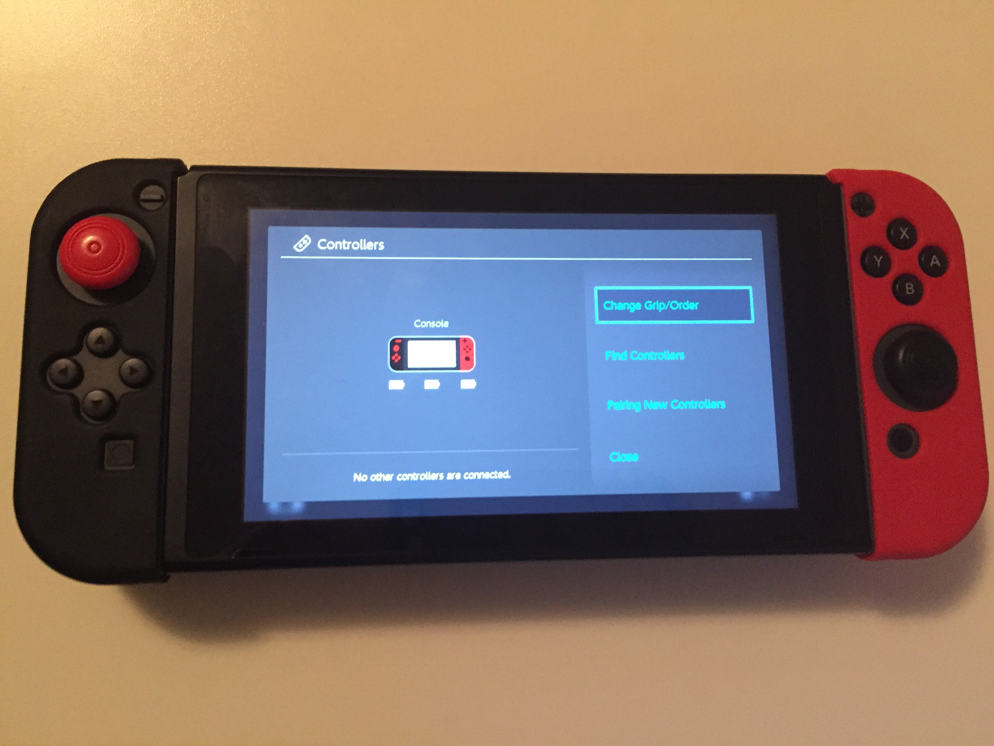

I dumped both my original joycons and my custom joycons, but when I attempt to restore the backup it claims that the SPIs are corrupt (including the one I just dumped). Is it affected by the fact that I renamed the dumps?
If so, how do I differentiate them without a stupid amount of folders?
Thank you in advance for any answers!
If it helps, here are my Joy-con (L) dumps in a zip.
I see that these are fairly new batch, correct?
I will need to change my validation logic because there are joycon with only one fw ram patch.
For now wait. I'll release a hotfix when I can. Also, keep the backups, they are correct.
EDIT:
The file name, does not matter.
I suggest renaming. It keeps your backup from accidental overwriting.
