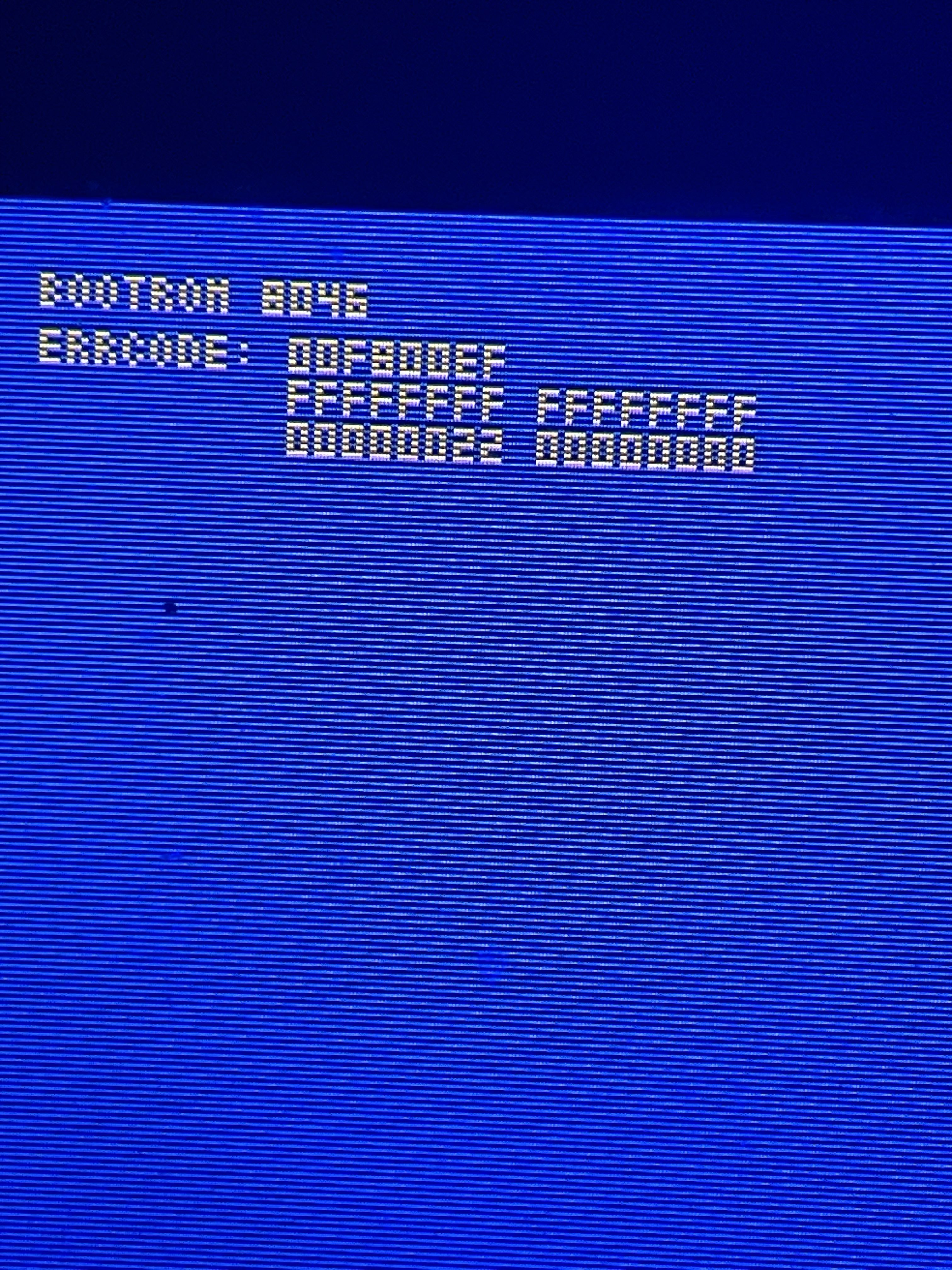

My og 3ds was having a "write protection has been enabled" error for years with 4 different sd cards. Sometimes it would load and I'm pretty sure i modded the 3ds but the error still happened form time to time. So i decided to replace the sd reader. After I ordered a new reader i installed it but got a Black screen and a pink led. After looking online for a bit i decided to just resodder the metal plate below the reader because i did a bad job the first time and now i get this error (Bootrom 8046 Errorcode: 00F800EF FFFFFFFF FFFFFFFF 00000022 00000000. Idk what to do now and i'm stuck

After researching online, Looks like you can save it with a ntrboot compatible card like r4i gold 3ds
You likley have a faulty nand NAND though. I assume you have a backup of your original NAND? If you don't there's not much you can do from what it seems
With a NAND backup you could create an emuNAND and boot directly into that from ntrboot.
Otherwise looking at 3DBREW - getting this error means your firm0/firm1 partitions are corrupt you should be able to fix this with a ntrboot compatible cart, using it to either reinstall b9s or restore a NAND backup.

Have any idea what caused this? I was just changing out the sd card reader and it happened. And i also looked online but from what i saw no one had the "000022" error i have. I think i modded it a year or 2 ago. Other than that I don't think i have a nand backup

If you have a spare DS, flash ntrboot onto a compatible flashcart and see if you can unbrick your 3DS.

I do have a spare ds but i don't have a flashcart nor do i know how to flash ntr boot. do you have any card recommendations? And a how to guide to flash ntrboot?
