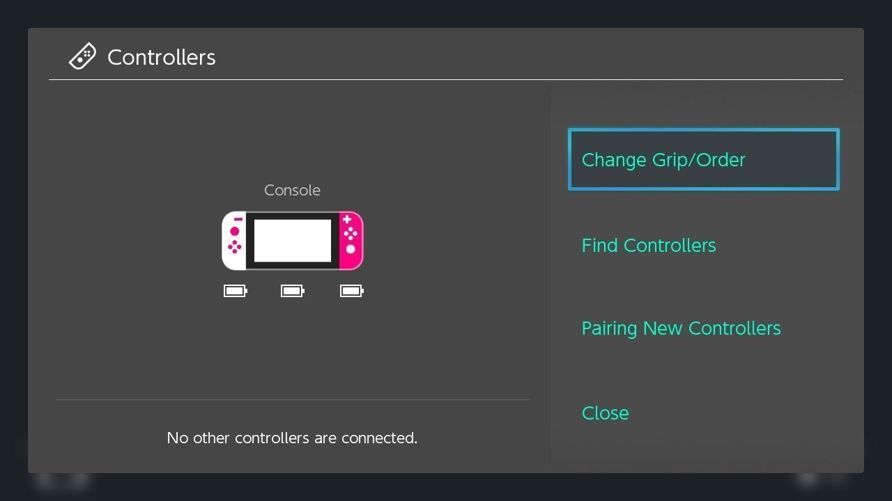

View attachment 94746 now the controllers are not pairing
You need to press and hold the sync button on the joy-cons as stated in the screen pop-up.
