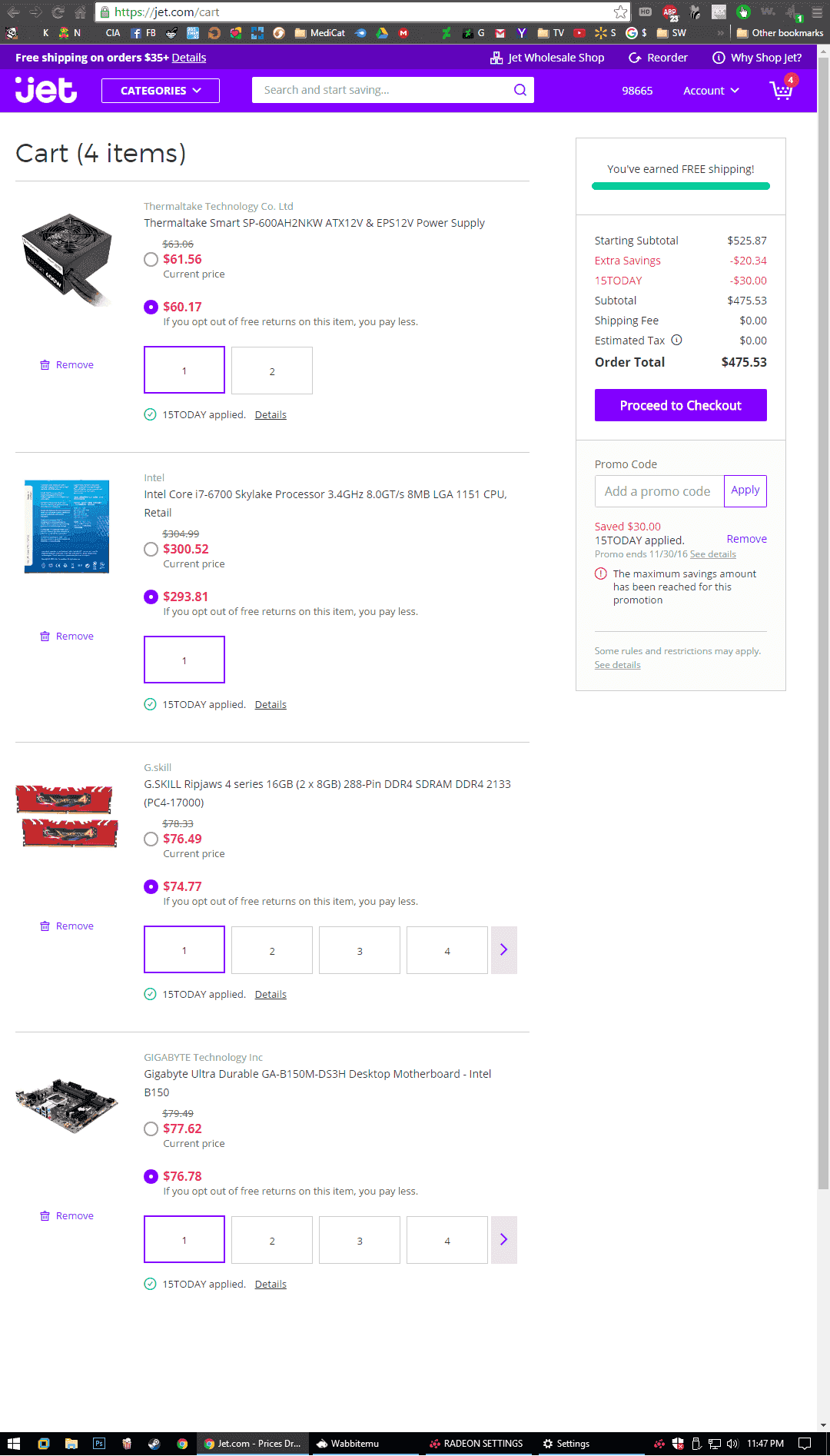

Ordering these parts tomorrow night to replace my current build, but keeping my crappy case and AMD R7 360 2GB video card for now:
By the way, I don't need the overclocking capability, so that's why I skimped on the K version of the 6700. I don't think any other site can offer me these low of prices with free shipping and no tax. :)
