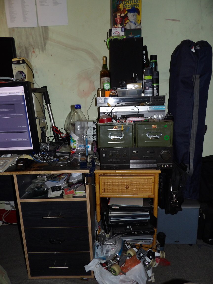

Bad week for my junk collection really, however accepting that my destiny is to become a hoarder I say yes when people ask me if I want their old stuff.

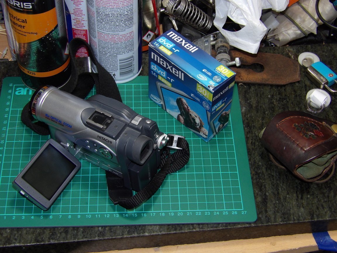

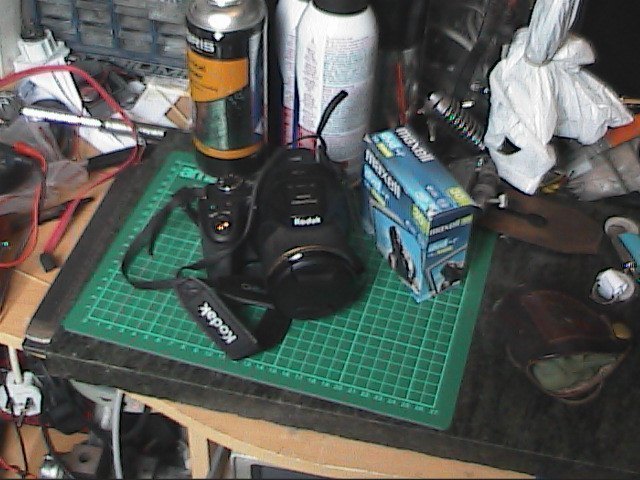

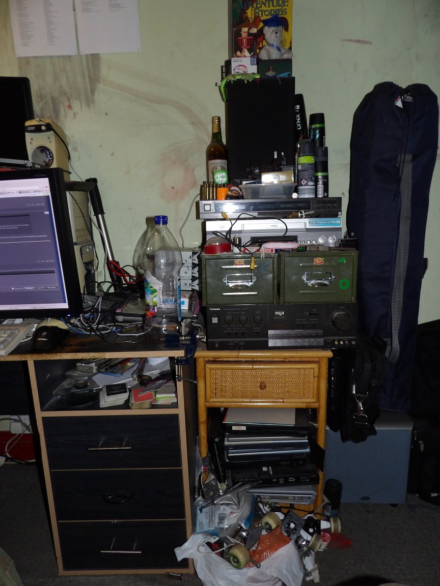

Sadly the folks at hitachi did not envision a time in which anybody would want to record to SD card so only stills can be taken with that and I would have to feed it miniDVDs to record video (less than 20 minutes of 480 vertical, though it does do 16:9, at a hit). Amusingly it does have a manual focus as well, digital rather than ring but still has it. Along with that also came a box of writeable mini DVDs (some have cases in that, it otherwise has some nice paper label ones stuffed in there). Might be time to chip a gamecube.
To sample the full glory of the image quality I thought I would swap cameras, even busted out the monopod for this one.
funny, i remember the "show your junk in table" thread that i created, and i could see how you where one of those guys which the house looks like a garage, full of old tech and cool stuff but obsolente, like several VCR, a very good old sound stereo probably from sony like this one, old computer running windows 95 or even DOS, a box full of walkie talkies, a box full of broken radios etc...
Have you been hacking my webcam? In most of the shots I have done of this you would not see it but that is a fairly accurate description of the area you would not see, though the only old machine you see there runs XP as it is my video capture machine, the one in front of it the video editing machine.
Also it is not that my place looks like a garage, just that a lot of garages look like my place. It is not a bad thing.
Oh and so as to get it a tiny bit on topic. Got a fairly fancy scart switcher from a box of junk as it seems most modern TVs decided to do away with having 5 scart ports and 1 is not enough, and I certainly don't want to have to put a VCR in the chain. Also found some supposed diamond plate sharpening things for next to nothing (£2.99 for 2) but have not tried them out yet.
