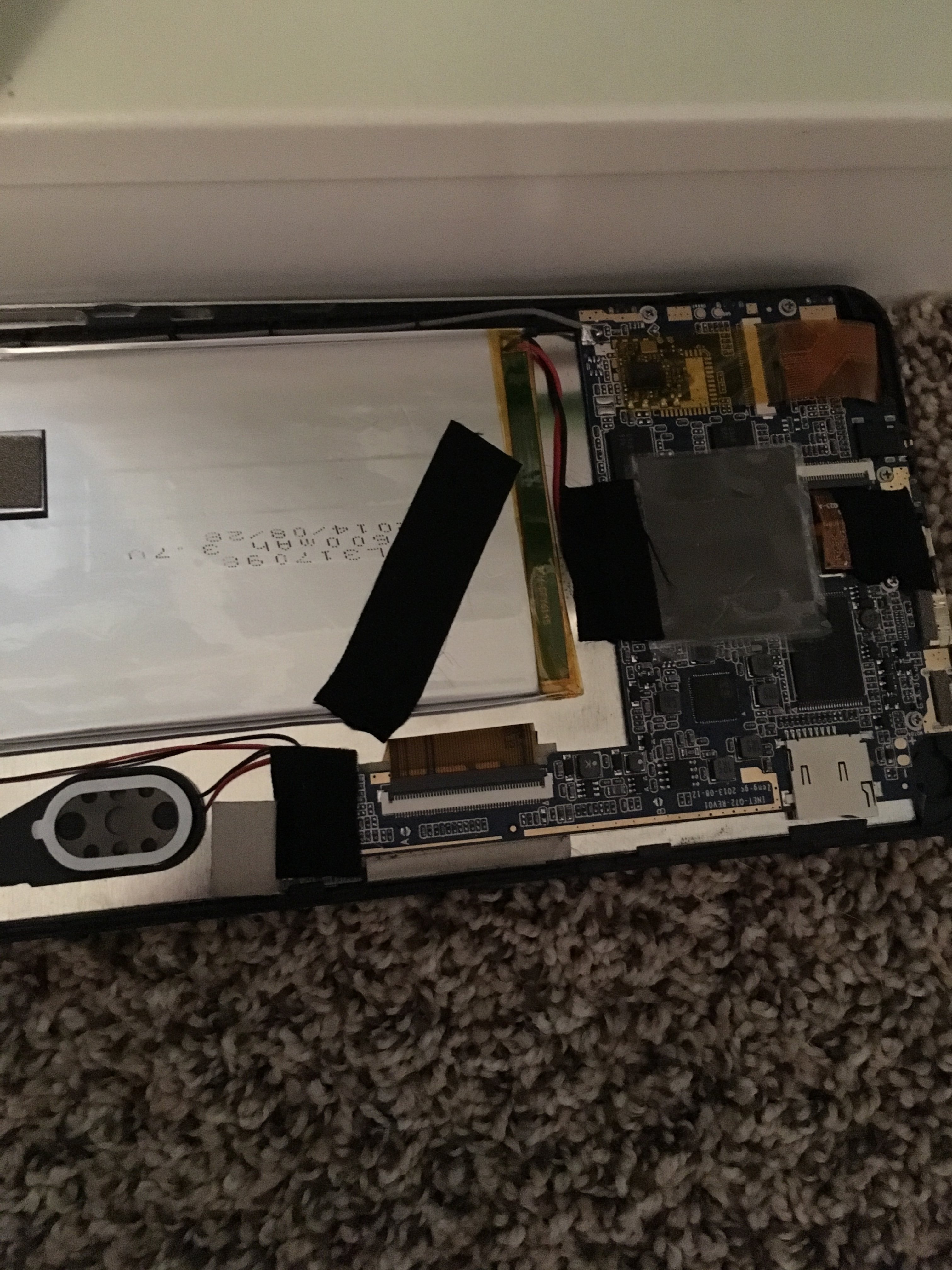

Try putting in different Sd cards in . it could be a failing card reader. My phone lags heavily and eventually crashes when i put in a card because its not working.
Where the card tho?

Card? If you mean card reader then i would assume its on the lower right of the picture. Unless thats a sim card slot. A faulty reader wont be visible though. Unless its obviously damaged.
That's the external card reader actually

I reboot and it shows the setup. I can get to the menu just fine but all my data is gone.
That's what is meant. Maybe it's your External sd card that is causing you problems.
Is switching external sd cards doing anything?
The external sd is what's forcing me to reboot the tablet, however it's not what makes it reset.

Seems to me like you bought some bargain tablet and the flash media used for the NAND is going bad. Rooting it won't fix the issue obviously.
