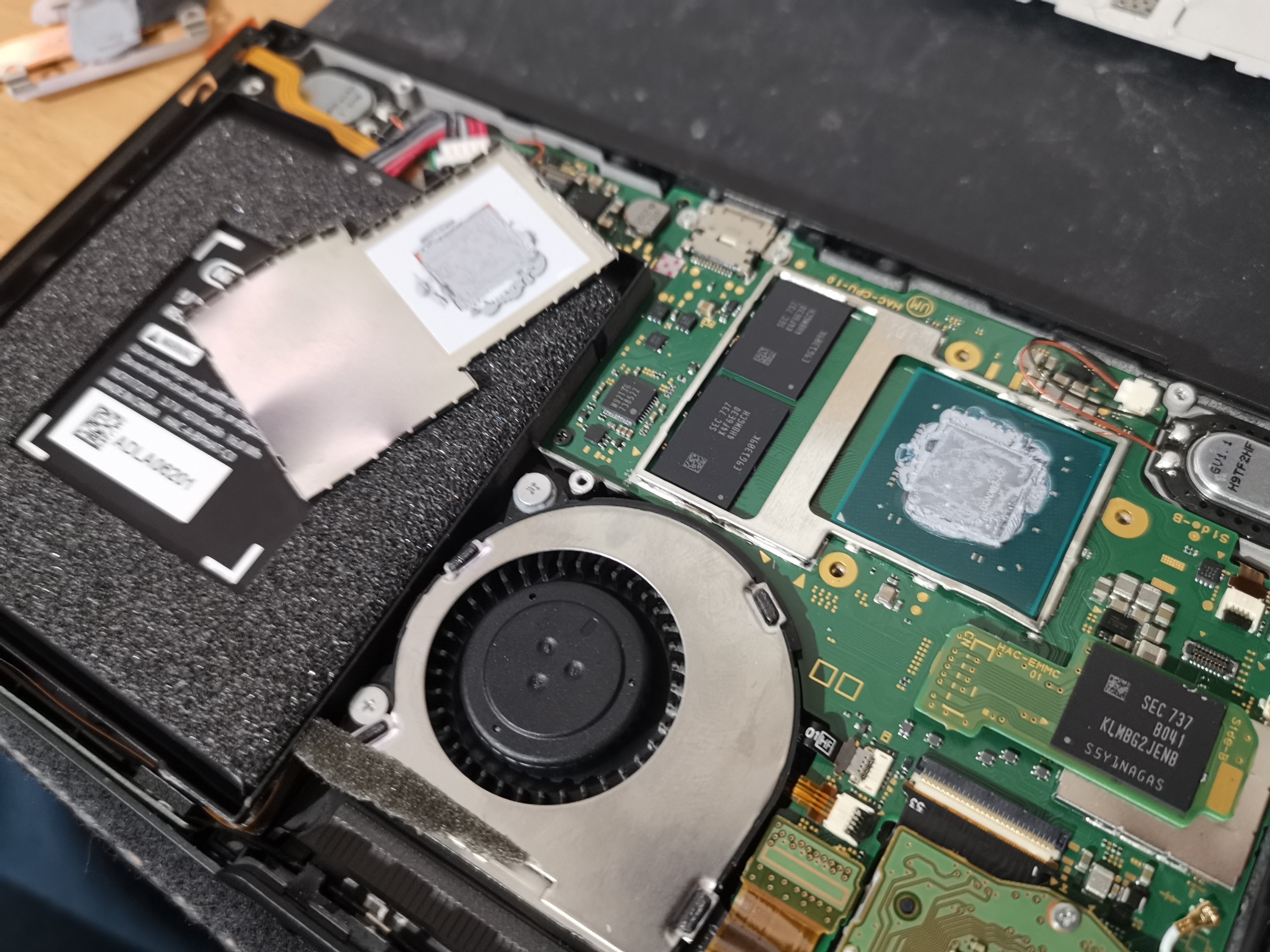

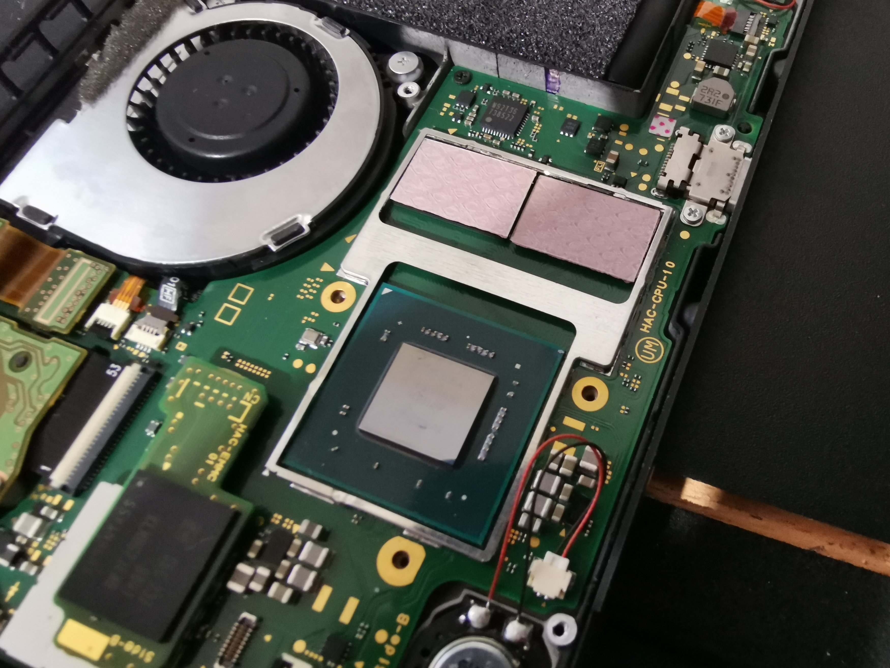

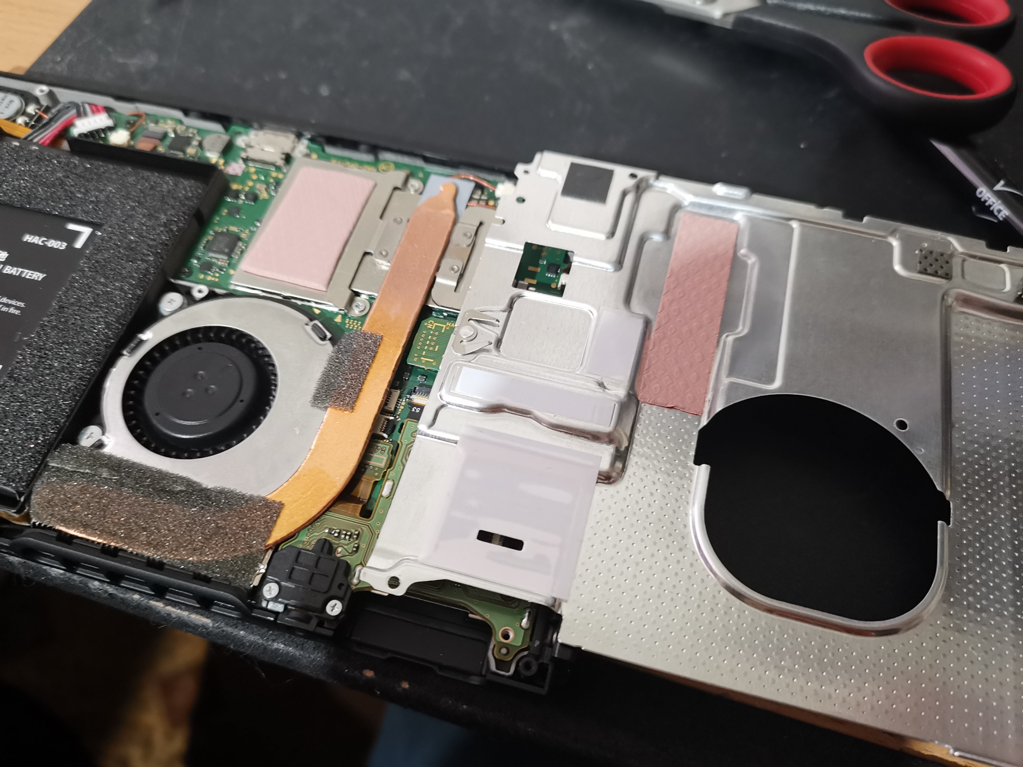

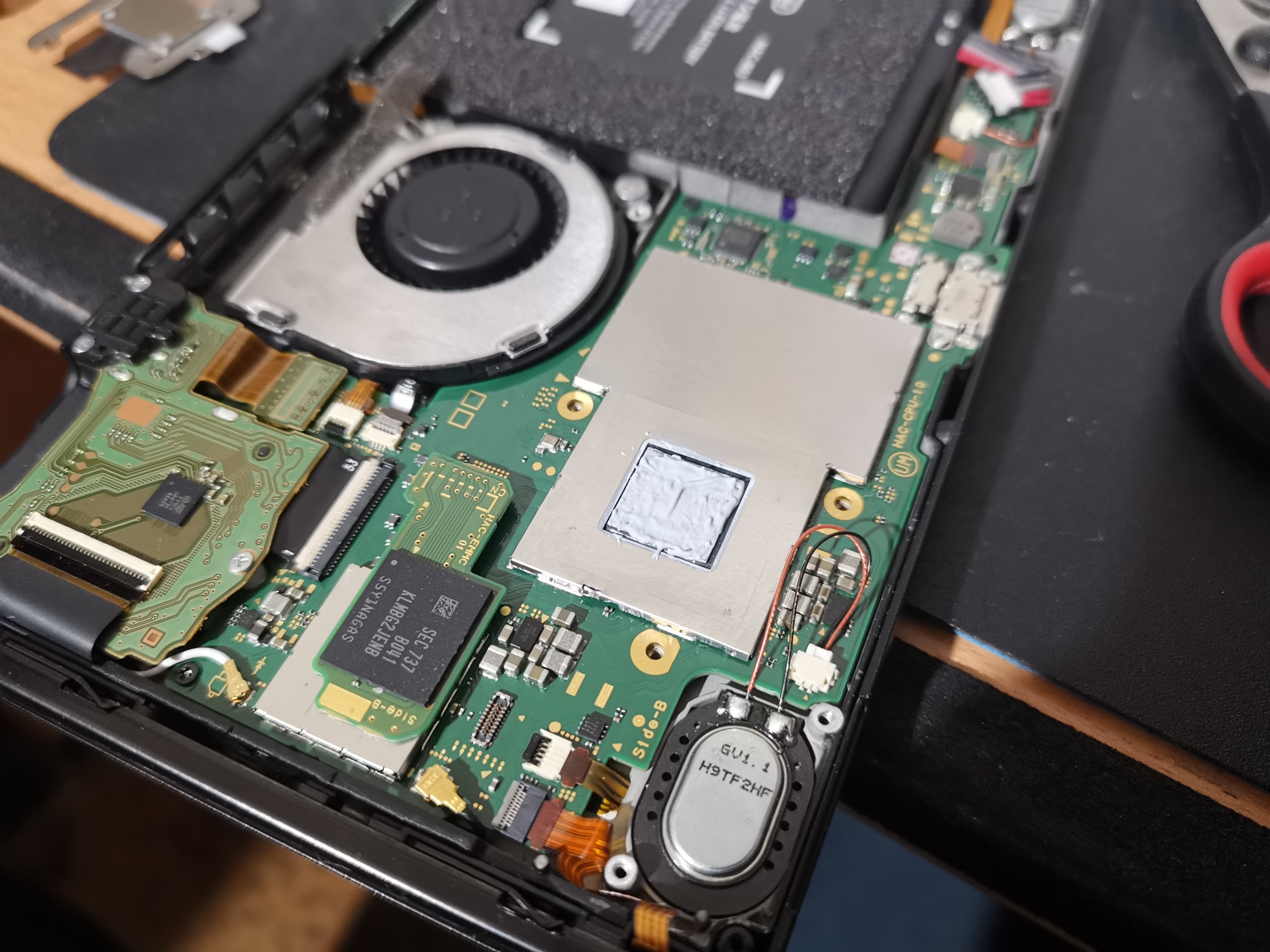

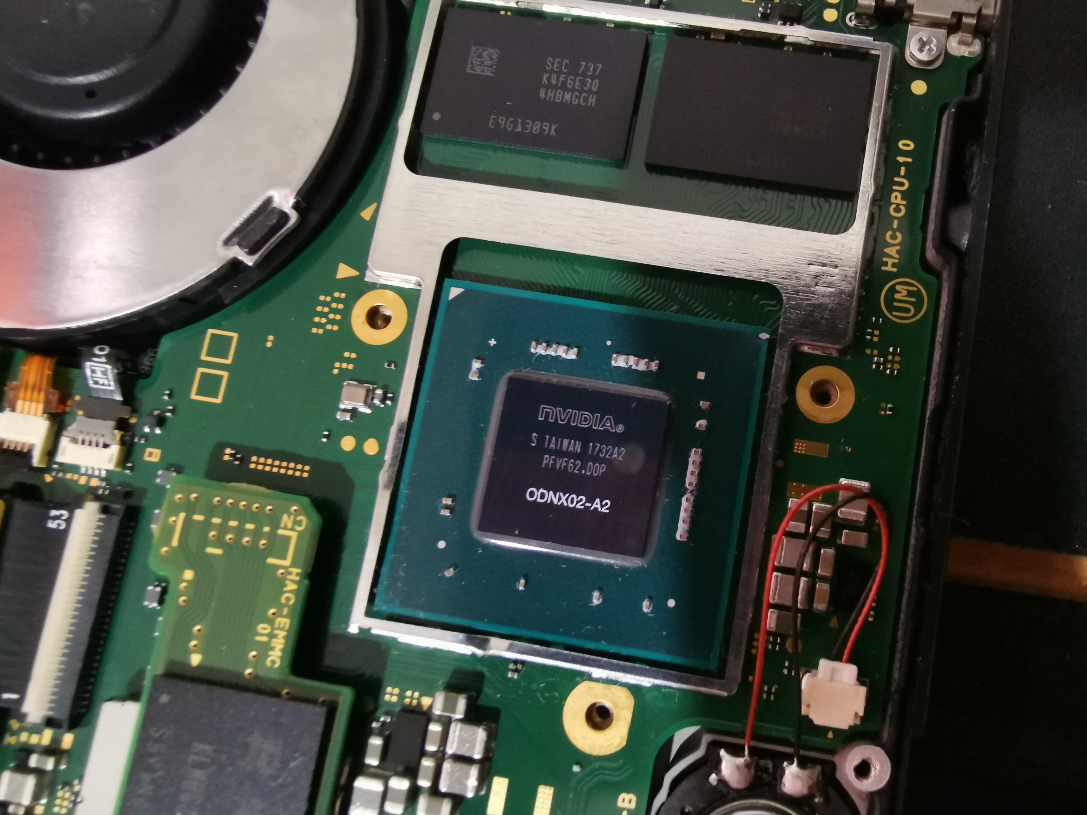

Otherwise, thats what i did:
IMG_20190516_200521.jpg IMG_20190516_201302.jpg IMG_20190516_203550.jpg IMG_20190516_204728.jpg IMG_20190516_210731.jpg
Okay, ill try. (Horizon? How can, i if i have autorcm, and always needs payload?)
View attachment 167252 View attachment 167253 View attachment 167254 View attachment 167255 View attachment 167256
Not bad... But you still have compound between those ceramic caps. Use a stiff(ish) non-metallic brush (toothbrush) to get it off. And isopropyl.
Actually, I use EGR valve cleaner for initial cleaning and then an isopropyl rinse after. Keep away from the plastics though!
Its the rest of the factory compund. And its there before repaste,so i think its not the problem,but okay ill try more cleaning.

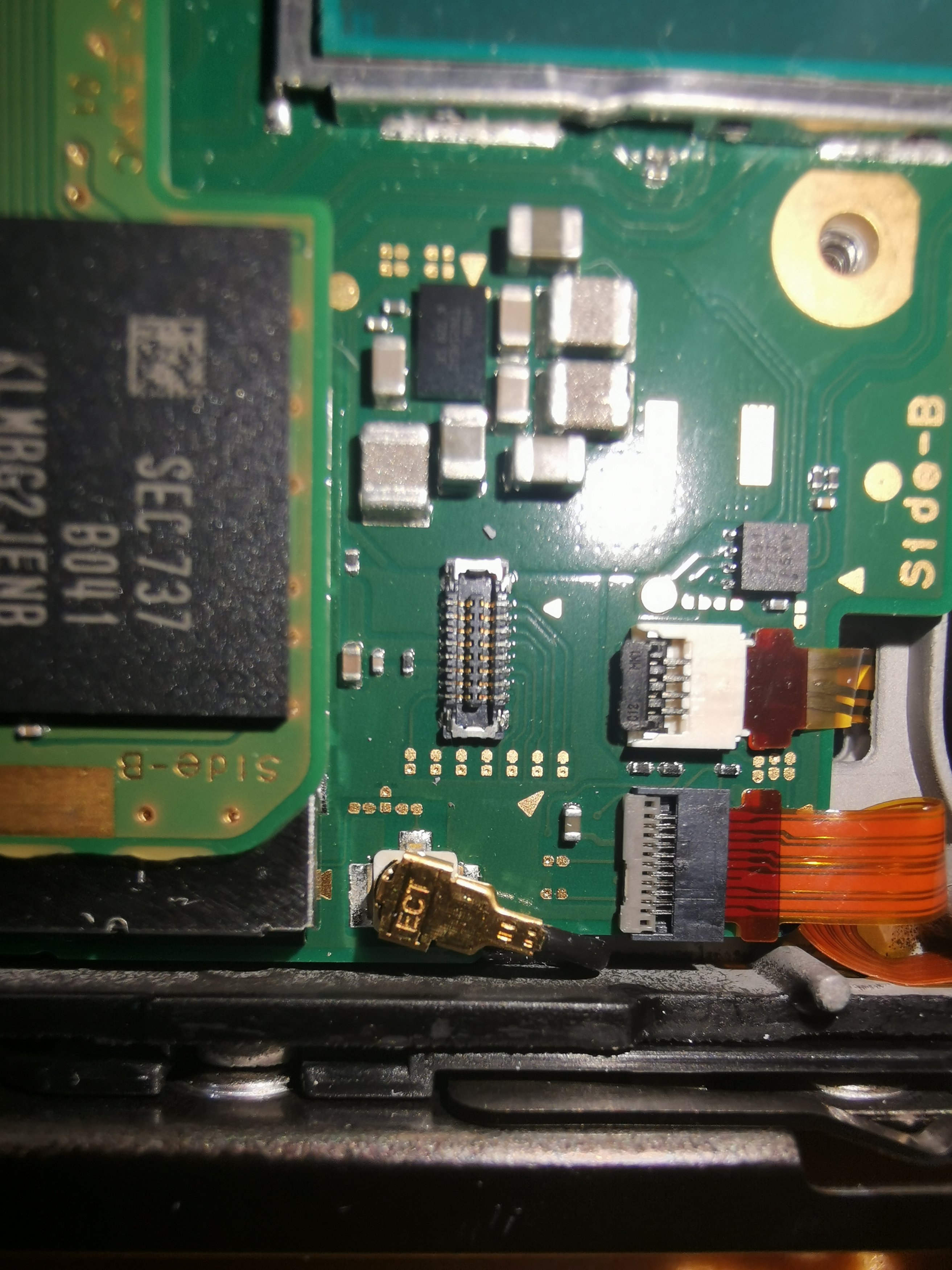

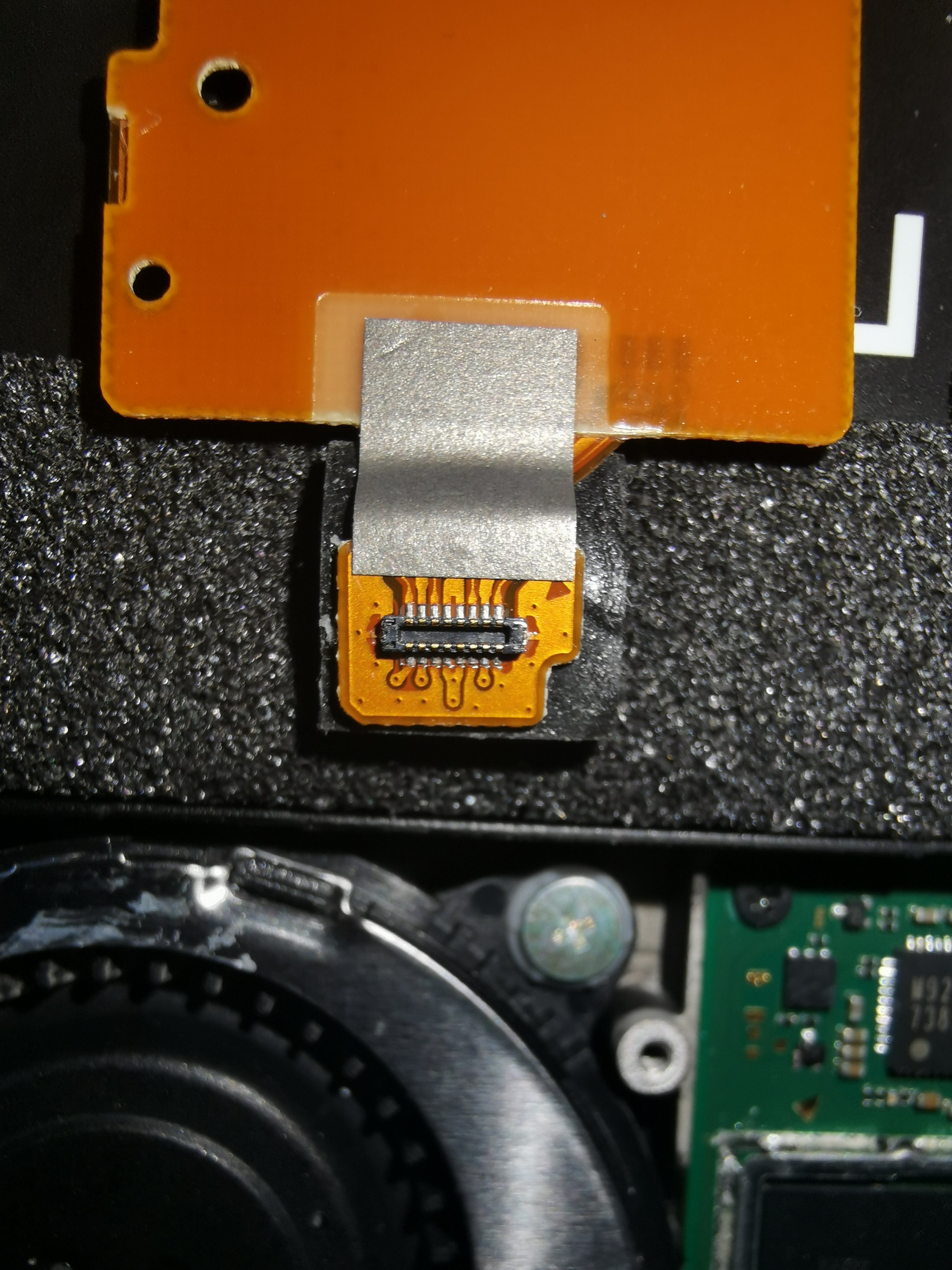

I can see where this is heading... You need to disable autoRCM (if your fuses are low and firmware high, you might need to burn your fuses to rule out anything with the SD reader). But thats the nuclear option. Have a real close look at the SD BTB connector. The slightest bit of crap in there will cause issues.
I see nothing,maybe tomorrow at work with magnifying glass...?
But if the sd is the problem, why can i enter hekate,and why can i load the payload?

Check the SD flex for any damage, I remember when they used solid boards and flex circuits on the N3DS XL, absolute horror, tiny tears and etc, look for it; connectors look fine.
