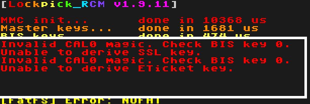

Yeah, i know i need an emmc programmer for my later projects, but is an emmc programmer necessary if im able to write to the emmc with hekate? I dont think so, correct me if im wrong.
Saved a screenshot of lockpick_rcm.
I don't know what you're trying to achieve but your keys you're grabbing from another console are utterly useless. They are only good if your raw dump is good because then you could grab the prodinfo and use as donor.
My Goal here is to get the oled at least run cfw. i got a backup from donor with raw dump and keys.
Current status:
Emmc replaced
Boot0 and Boot1 generated with emmchaccgen flashed to emmc
Obtained prod.keys from dead switch
Im currently following this guide here: Nand Rebuilding
im still waiting for my screen connector, so i can actually see whats going on.
