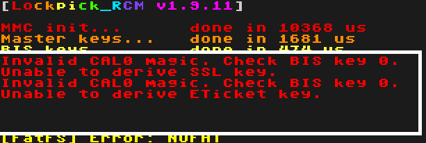

I now got the prod.keys from my dead switch. stupid me that i broke screen connector -.-
So now i need to rebuild nand with my just obtained keys and flash it back to emmc, right?
Yeah, i know i need an emmc programmer for my later projects, but is an emmc programmer necessary if im able to write to the emmc with hekate? I dont think so, correct me if im wrong.
Saved a screenshot of lockpick_rcm.
You can load up hekate without the emmc on the OLED?
dumping prod.key from different emmc wouldnt work since cal0 unmatch. But dumping anything raw should be fine.
