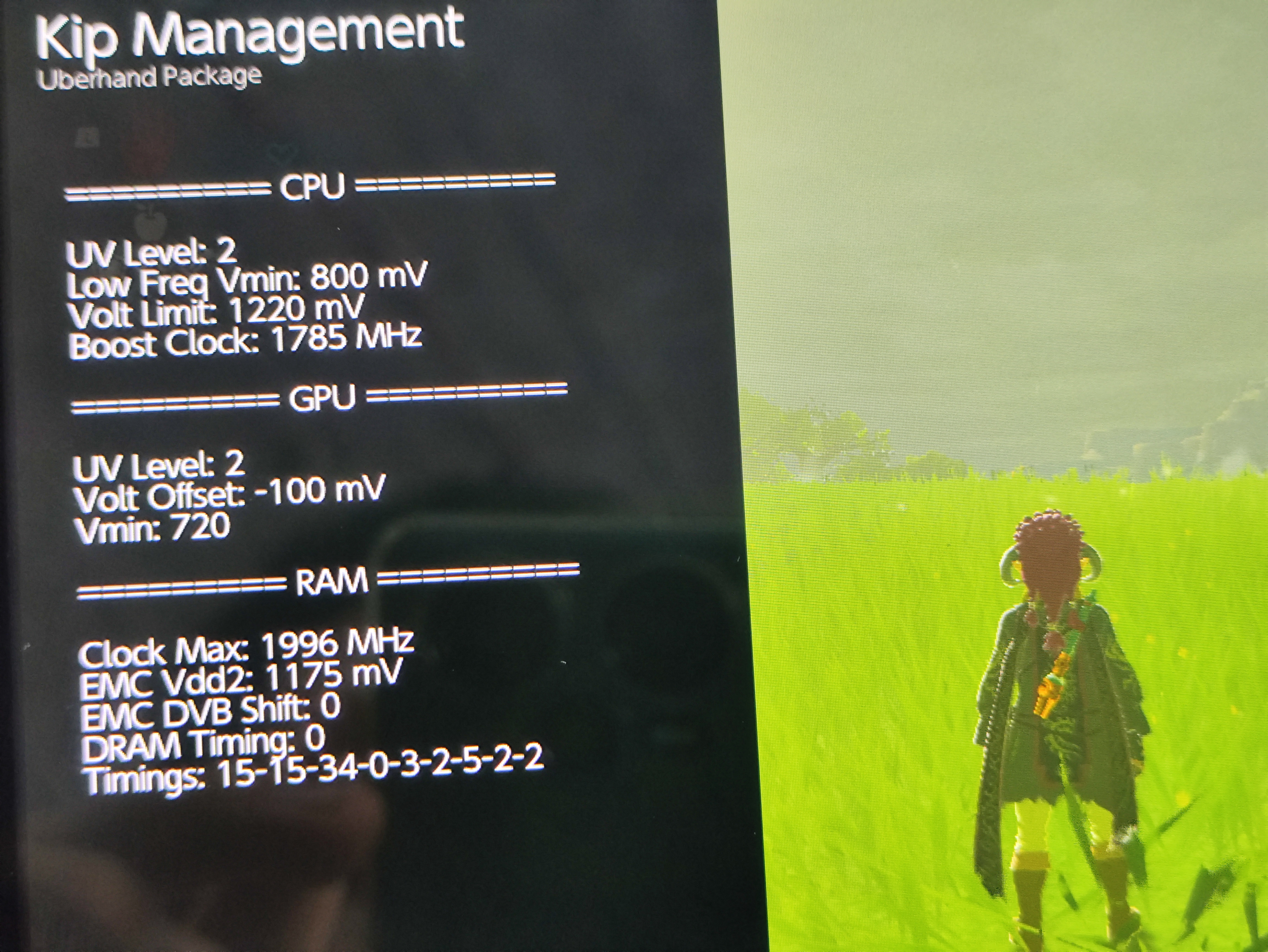

Una duda, si está bien las configuraciones... Me base más en la intuición que en la cosa jejeje.
UV3 en CPU dejo de iniciar HOS, la GPU ya no dejaba valores más bajos, pero no obtuve artefactos y la RAM bajarle más causaba cierres.
A doubt, if the configurations are correct... I based more on intuition than on the thing hehehe.
UV3 on CPU stopped starting HOS, GPU no longer left lower values, but I did not get artifacts and RAM lowering it more caused crashes.
If you are not aware of what you are doing, then just use the default settings, they are optimal for 99% of consoles.If the console does not boot when the UV level is raised, use the boot mode without a kip via Hekate INI folder and roll back this setting. Happy overclocking.
