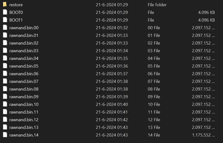

hello i got i small question i opent my cfw sysmmc and downloaded a pirate game
is there a way to restore your sysNAND with a back up i did right after i modded my switch (clean sysNAND)
to avoid a ban (i havent connected tho the internet yet)
sorry fore my English
this is the back up i have i hope i can save my switch
Place all of those files onto your SD card and restore them via Hekate.
