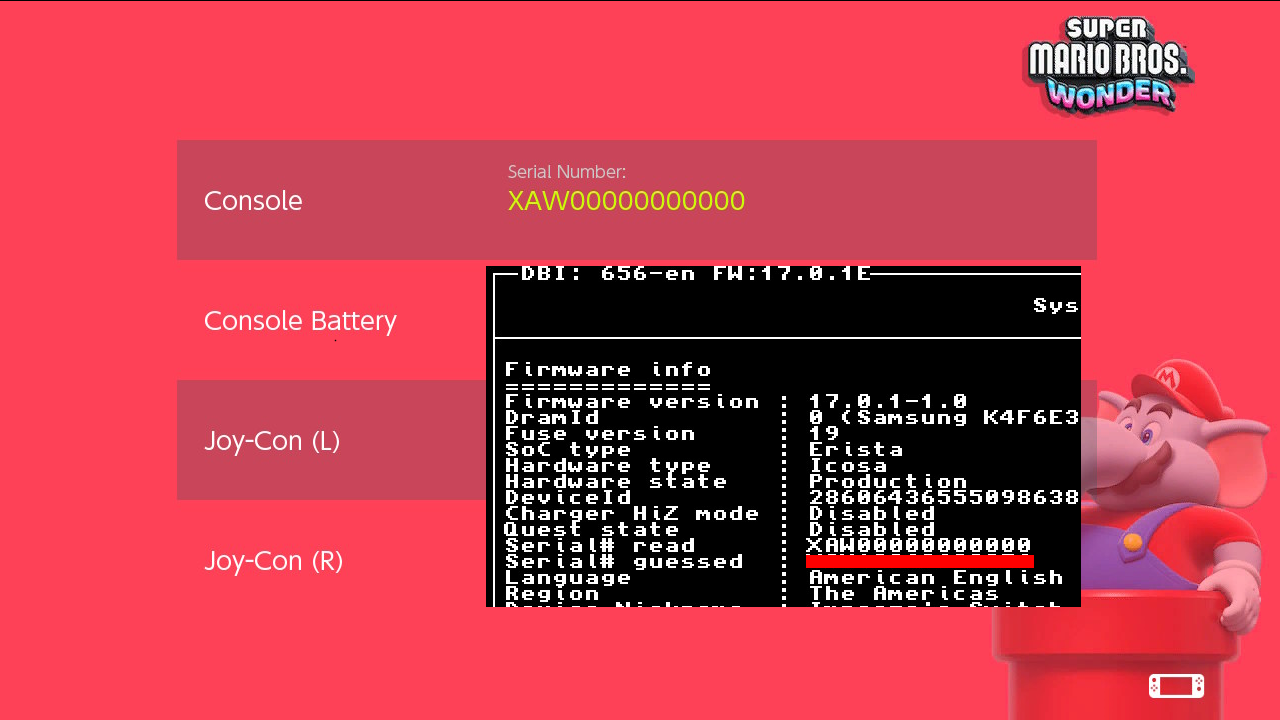

My console just now:
On settings applet, and the black rectangle is on DBI System Info Tool. the guessed one is exactly the one on the box.
I hadn't seen that while using DBI. :O Duckbill is such an awesome coder! Too bad he's given up on DBI. I just hope he'll release a quick fix, if it ever breaks in a future firmware update, or else, we're in trouble, as Draxzelex mentioned earlier.
