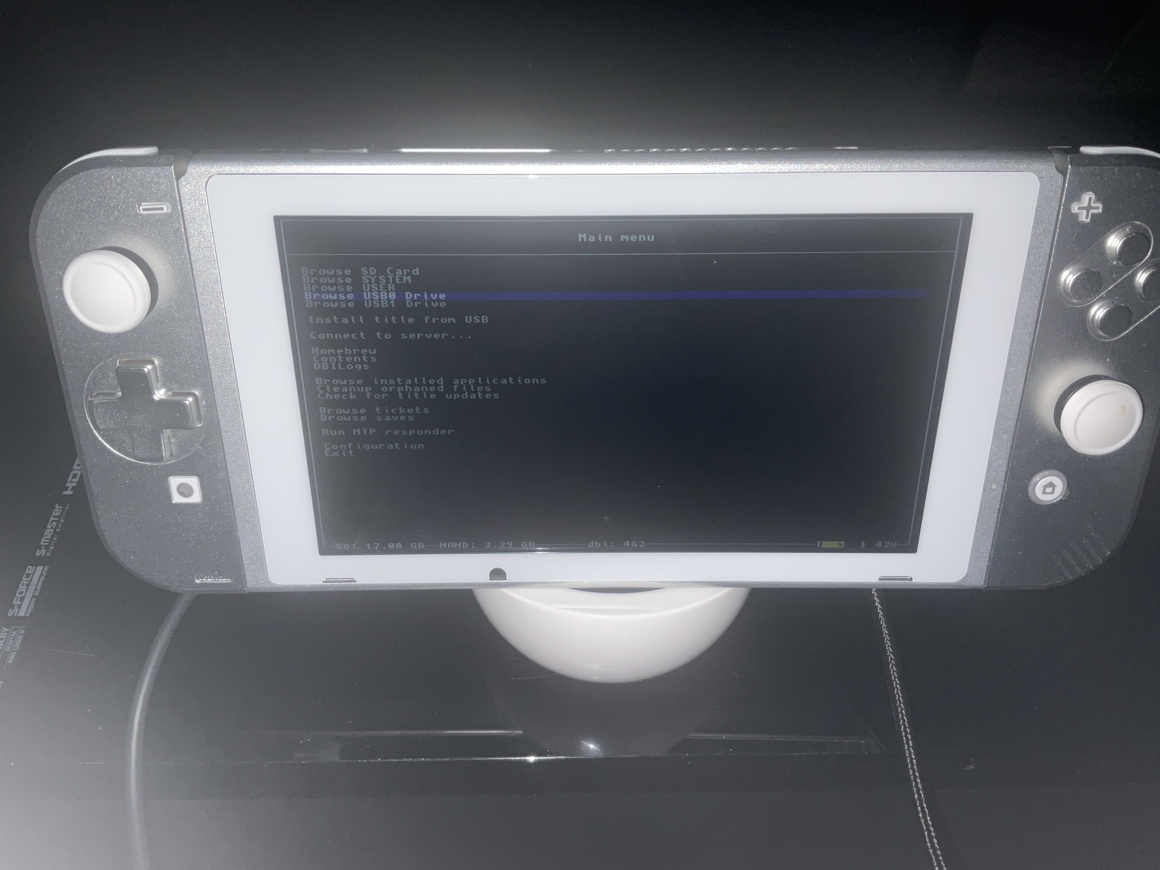

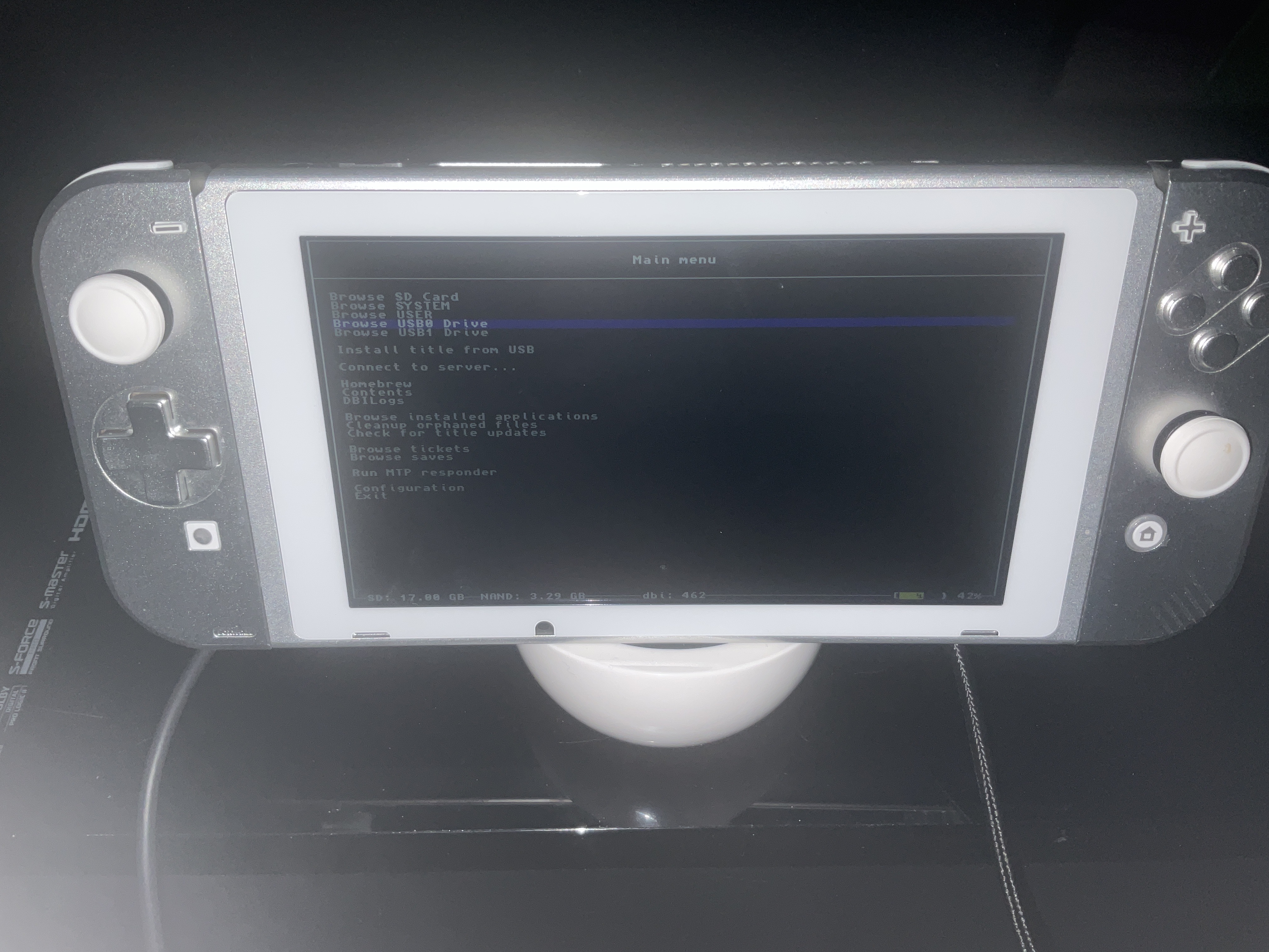

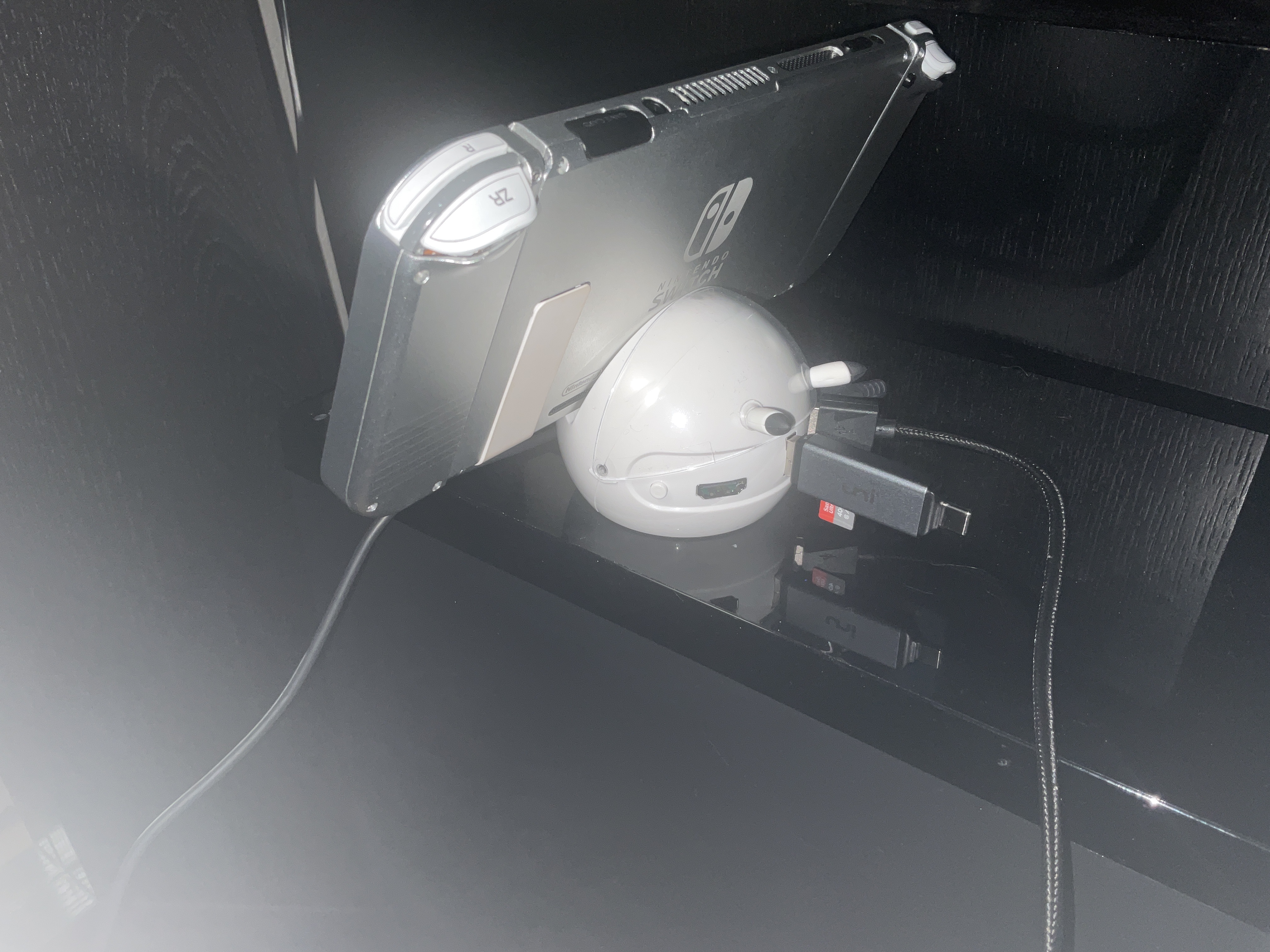

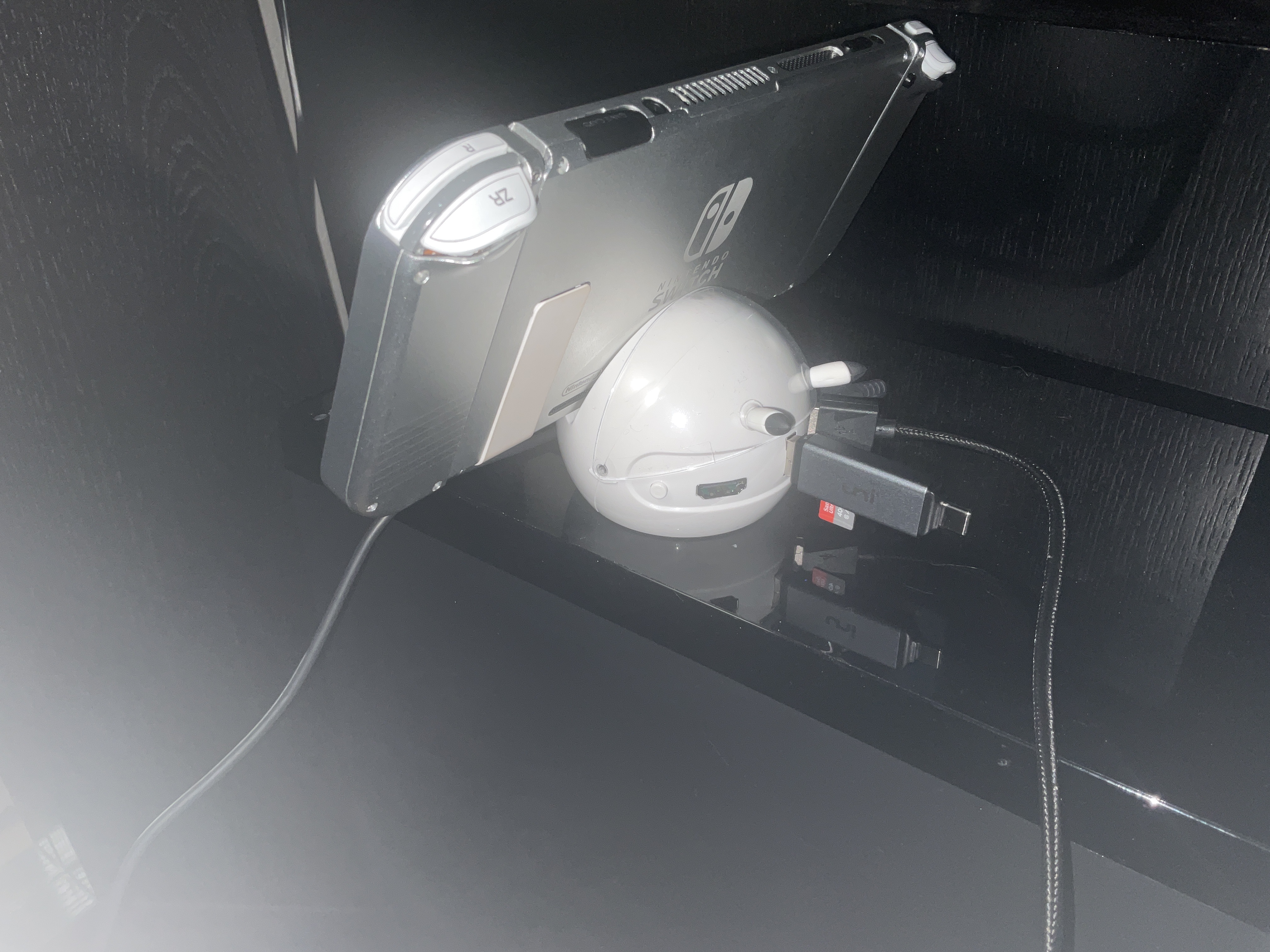

I'm about to transition to using DBI to install my games and there's something I'm wondering about how the install-via-USB functionality works. Does this only work by directly connecting to the Switch's USB C port or does it also work via either of the USB ports on the Switch's docking station (when the Switch is docked, off course)?
Install via USB expects to connect to something like NS-USBLoader running on yiur PC.
That said, if you plug in a USB drive into the dock you can browse it and install any .nsp/.xci files you might have backed up there.
Even 3rd party docks w/ Pokémon ears that somebody gave you for Christmas so you have to use it. (STFU. Nobody asked you.)

First off, that docking station looks nice! That said, that sounds positive for the odds of using DBI installer via USB straight via the docking station.

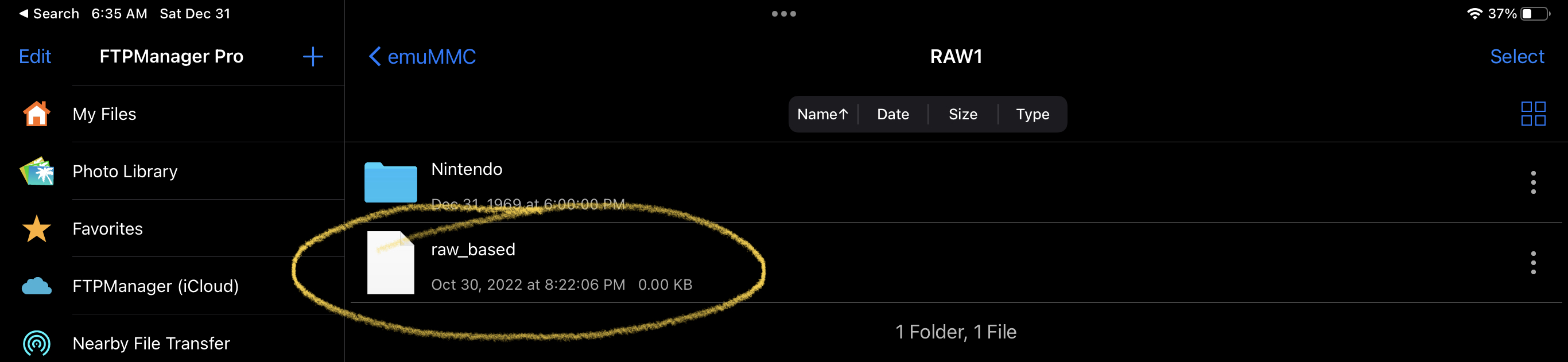

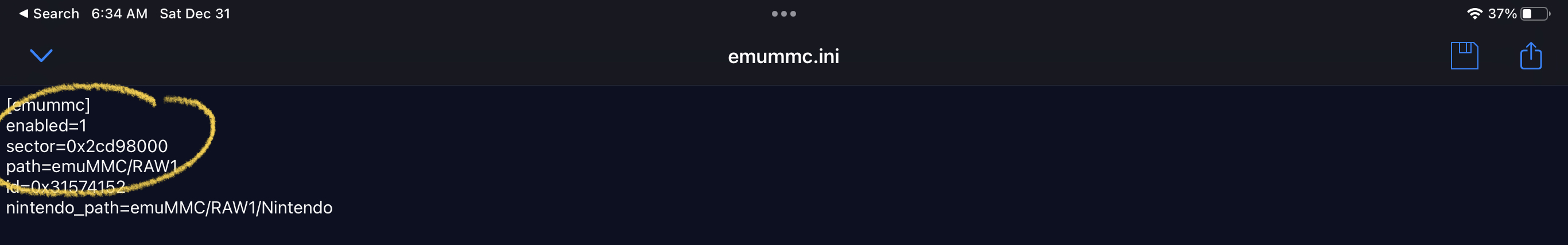

If you have a second 30G partition it’s highly likely you have a hidden partition.
One way to be sure is to look in your /emummc/emummc.ini file and if it shows a sector then it’s a partition based emunand.
Also if you go in to the path= directory you can look for raw_based (or files_based) with raw being a raw partition and files being…well…files.
Appreciated.
Odds are 100%. I just used it to install an nsp and it worked great. Super fast and convenient way to install.

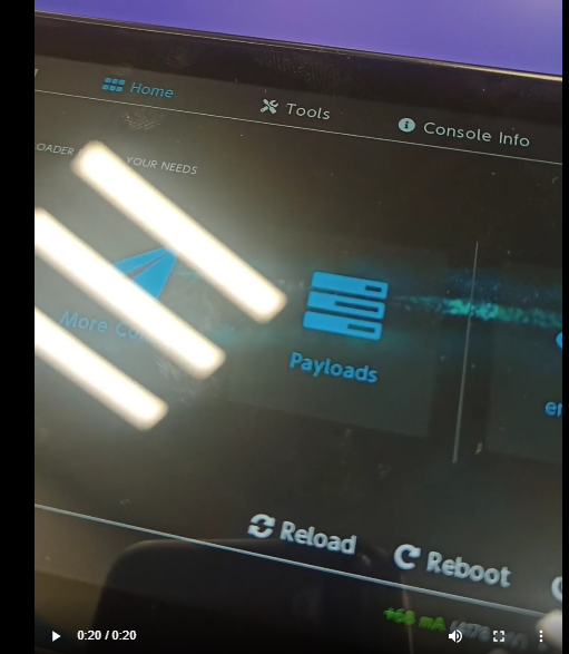

I read through it but still didnt find anyone with the issue I had.
My RCM Loader cycles through colours and does show things like BOOT.Dat not fount ( something like that).
The fact that Fusee was able to launch from the HEKATE_ATMOSPHERE folder as apposed to USER2 which both had the same file, tells me that there is an issue with it.
To be clear, I was able to update the to the 2.02 firmware, at least by the guide on the website, that's what it showed.
In any case, I haven't gotten closer to the problem here since I haven't found anyone with the exact issue as mine, but my question is this - Is there any disadvantage in using the Fusee.bin payload as apposed to Hekate? I find it bizarre that most guides show Hekate file stored in the loader rather than Fusee(Atmo).
In any case, I was able to set up Rekado on my phone, though OTG on my Realme6 is a knob which ones turned on, goes off after 10 minutes, don't know why that is and I haven't been able to find answers as to why that is either.
@Soler37 did you get any pics of anything else working? Are you saying injecting fusee.bin works w/o issues? Please post a pic of that if you can.
Hey bink, if you look at the page previous, I uploaded a video of Tegra rcm launching hekate. For fusee, I just launch with the RCM Loader and it work, would you like video of me launching with the loader?

First off, the doot.dat thing is you launching the sxOS payload. You should delete everything except hekate, as you can load any payload you want via nyx anyway. You can even place hekate as payload.bin in ALL of the folders of the dongle if you like. Just use 5.8 or 6.0 (not 6.0.1 since it sounds like the dongle you're using is one of the new clones/fakes).
Oh wow!
That clearly shows that there's nothing wrong with your hardware. That's clear as day!
I take back everything I said about you.
So I'm using hekate to boot my switch but I have fusee.bin inside my hekate_ipl.ini file.
[config]
autoboot=1
autoboot_list=0
bootwait=1
backlight=55
noticker=0
autohosoff=2
autonogc=1
updater2p=1
bootprotect=1
[Atmosphere CFW]
payload=bootloader/payloads/fusee.bin
emummcforce=1
kip1patch=nosigchk
kip1=atmosphere/kip_patches/*
logopath=/graphics/splash/atmosphere.bmp
icon=/graphics/icons/current/atmosphere.bmp
This ini file will:
autoboot=1 (automatically boot the first entry)
autoboot_list=0
bootwait=1 (only wait one second until it automatically reboots)
backlight=55 (tone down the bright display)
noticker=0 (allow the cool time ticker bar)
autohosoff=2 (when shutdown it will stay down…no bouncing around and 1/2 booting)
autonogc=1 (turn off the game card)
updater2p=1 (check if there is a higher version of Hekate to use instead of what was injected)
bootprotect=1 (protect my boot files from malicious homebrew and me being retarded)
[Atmosphere CFW] (first stanza)
payload=bootloader/payloads/fusee.bin (boot using fusee.bin instead of Hekate)
emummcforce=1 (force the use of emunand)
kip1patch=nosigchk (Sigpatches)
kip1=atmosphere/kip_patches/* (Sigpatches, damn it!)
logopath=/graphics/splash/atmosphere.bmp (splash logo)
icon=/graphics/icons/current/atmosphere.bmp (icon for use in Hekate)
Basically what this means is you can use any damn version of Hekate in your RCM loader but it will use the latest Hekate installed on your SDCard.
So downgrade to Hekate 5.8.0 on your RCM loader, integrate so,e of the changes above to suite your needs but particularly use the bold lines above. That should fix what ails you…
