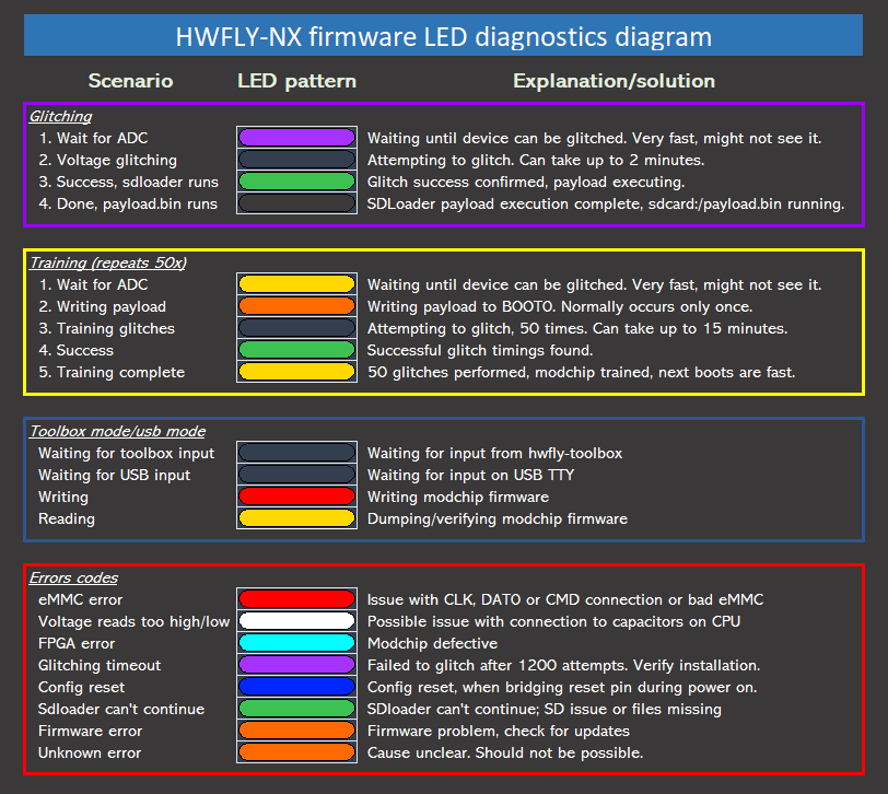

I just installed a mod chip on my switch. I followed this guide on how to set it up
I followed it exactly. Even though the guide didn't tell me to I did add a boot.dat file on the sd card because my switch wouldn't get past the boot.dat screen if I didn't. I when I tried to launch atmosphere the slash screen shows up for a second, but then it just goes to a blank screen. Also in the video it shows that he's able to boot into the stock firmware, but that option doesn't show up for me. I'm trying to use atmosphere 1.4.0. My switch is probably on the most recent firmware. This is the mod chip I'm using
https://a.aliexpress.com/_mtvZ2N6
I don't really know what I'm doing, so if you can be as noob friendly as possible I would appreciate it.

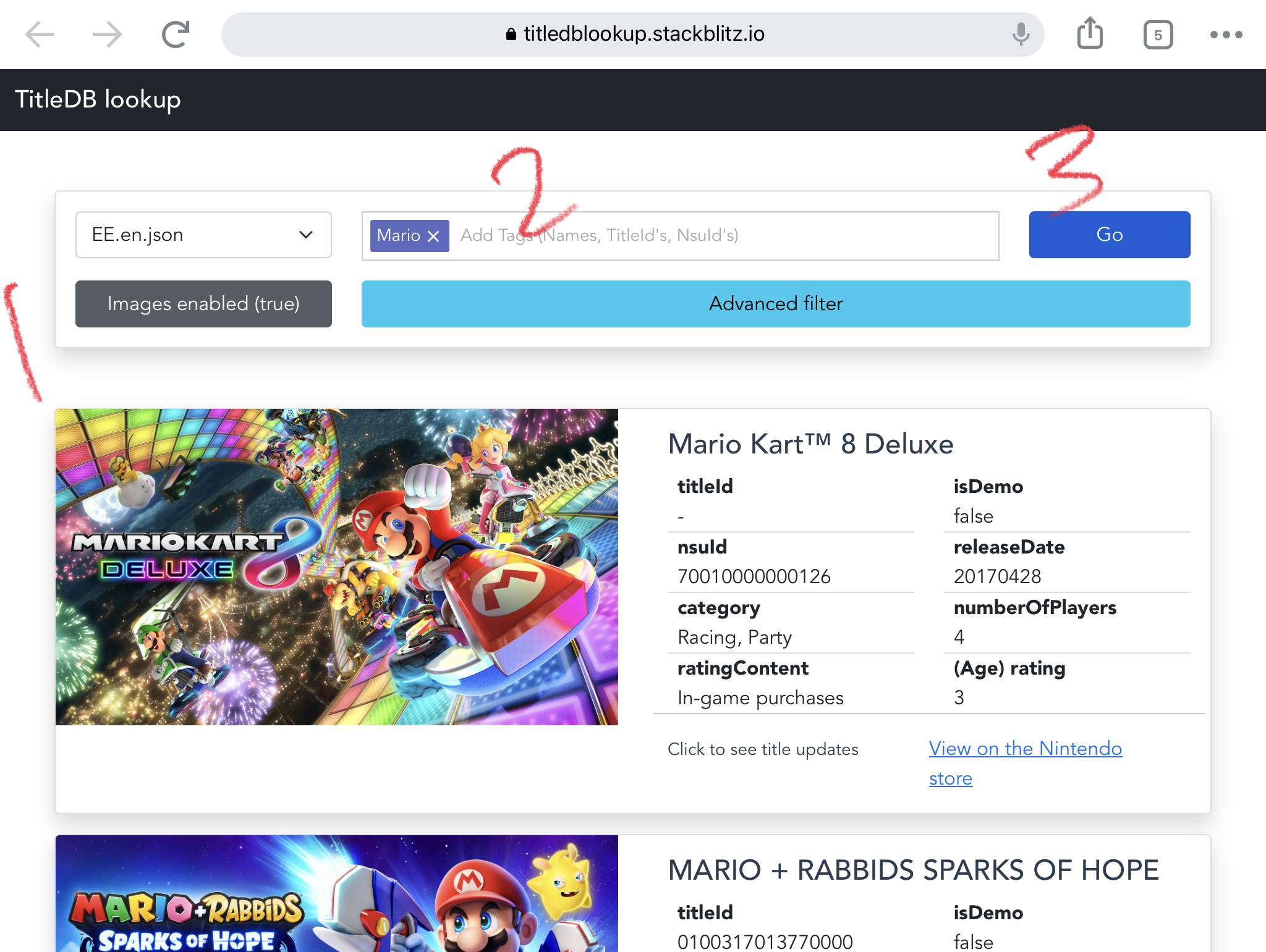

You are spot on, you need to run the game once to create the game save hierarchy.
You can find game titleIDs here:
https://titledblookup.stackblitz.io/
1) select language file
2) add a search term
3) Lets’a Go!
Are you on a V1 or V2 Switch?
That video is a mess…trying to cram so much important information into a short ADHD video with cut scenes, Picture in Picture and distracting music in the background. WCGW?
Try going through a written guide and see if it helps clarify some things:
https://rentry.org/SwitchHackingIsEasy

You will have to look up the titleID and put it into the appropriate game title. Here’s a lookup link:
titledblookup — listing game titles with titleid

I used your link and the title of Cuphead in your guide example is 000000000000003b but TDBLookup says the title is 0100A5C00D162000...

The 00000000000003b is just a folder name inside of the :USER partition. It’s a dynamic number and will be different for each *nand. It’s not the actual TitleID.
I'm almost 100% sure its a V2. I followed the new guide and the same thing happens.
It flashes blue, then it turns solid green, and then it turn off. I don't know exactly what my switch firmware (since I don't see an option to boot into the OWF), but I assume its a more recent one.
I was referring to the chip firmware. Are you certain it’s not flashing purple first? Since this came from HWFLY you should check the firmware and make sure everything is responding properly w/ the chip and upgrade to latest if applicable.
Side note: still not sure why you had to add boot.dat. Did you used to have SXOS installed?
