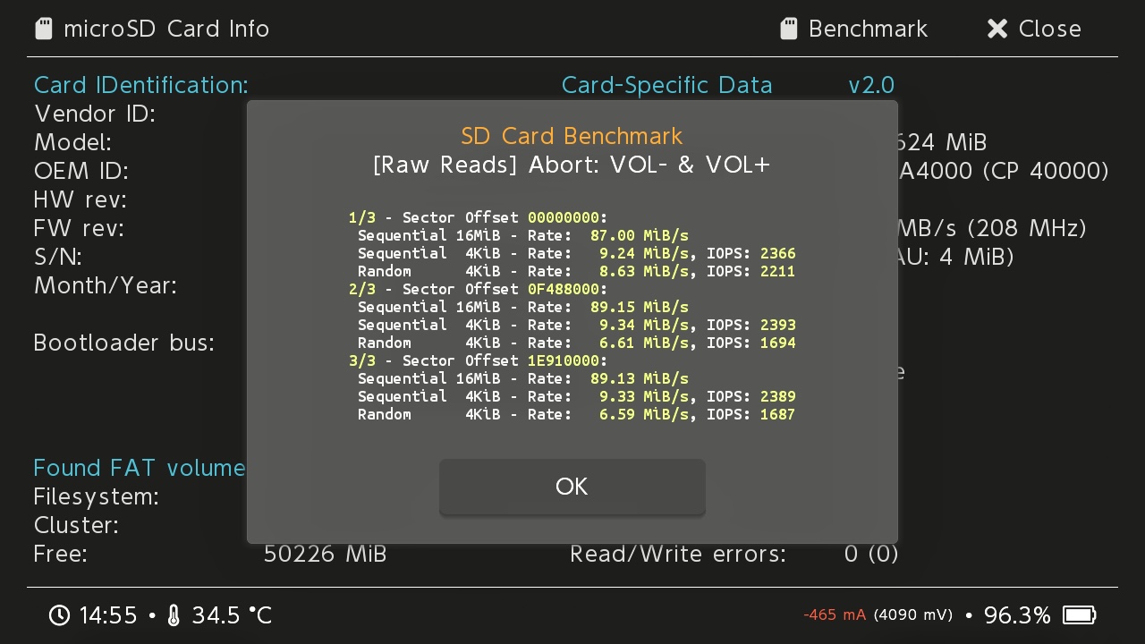

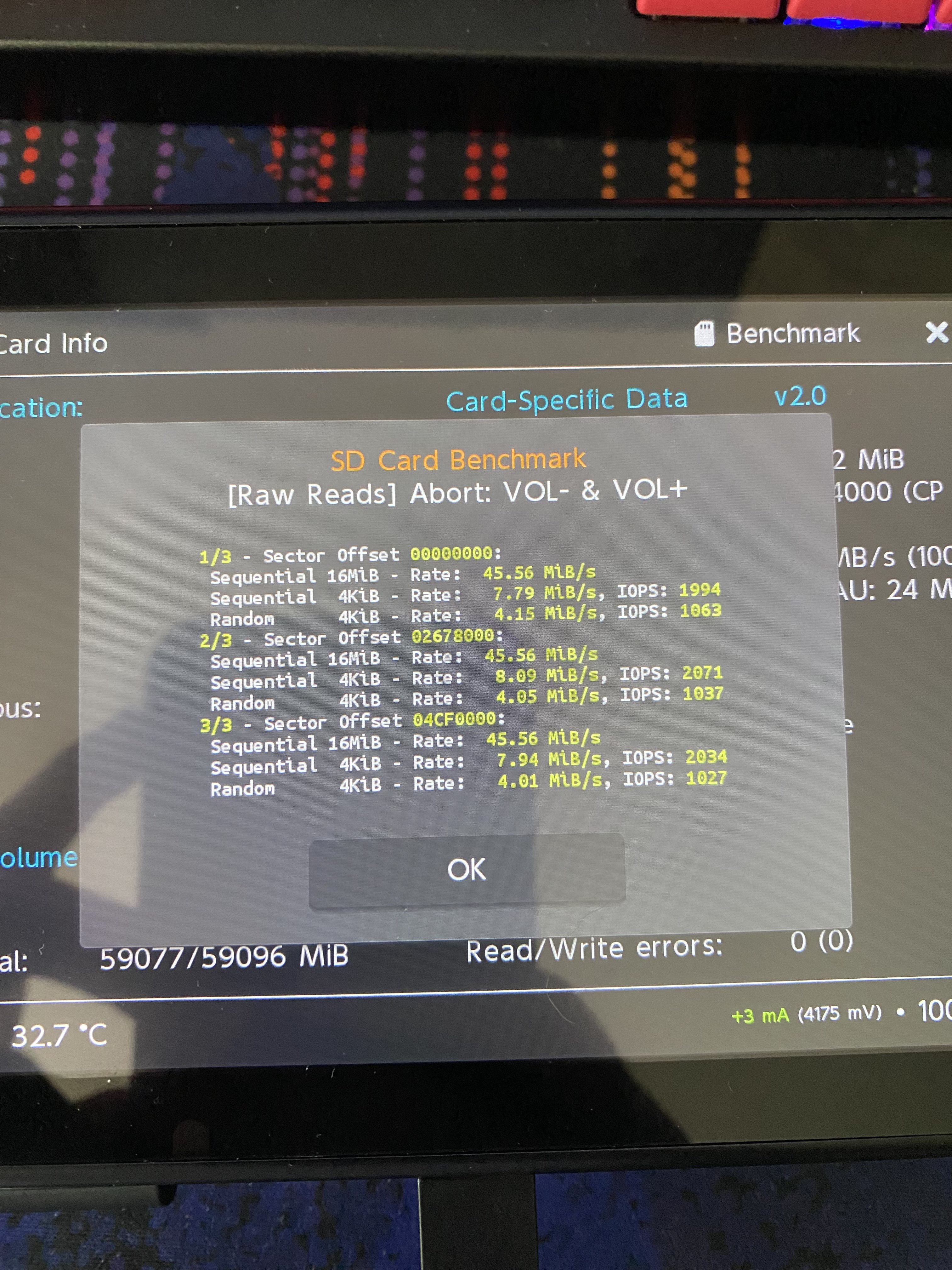

Hello! I have no clue what is happening with my Switch and CFW. I originally hacked my switch in April of this year, it was fine for about 2 months and then the CFW side started to get really sluggish and eventually stopped booting into Atmosphere. So I decided to re-hack the switch in mid June and everything was fine!
Or so I thought, because now the Switch is doing the same thing. CFW is extremely slow (took 4 minutes to launch Smash Bros Ultimate installed on my SD Card). I turned off the switch, tried to reboot into Atmosphere and it got hung up on the Nintendo Switch boot logo screen for 10 minutes before hitting a black screen and not booting into Atmosphere.
I did a SD card benchmark test in Hekate and everything seems normal to me (unless it isnt then plz tell me). This is a 512GB Samsung Evo Select U3 SD Card. Hekate also read the SD card correctly showing that it was a Samsung and not a fake. I tried getting a fresh copy of Hekate, Atmosphere and the SigPatches but it has not fixed my issue.
Lastly, I tried downloading a game on SFW to my SD Card and it booted up instantly (game in questions was Mario Odyssey). I really do not understand what could have happened to make my CFW completely unusable.
Please help :)

Your numbers aren’t really consistent.
Here’s mine…notice how they are all about the same.
Sure can, but don’t you want to format it first and the copy fresh atmosphere and Hekate on it?
Looks like it was the Samsung SD card that is either counterfeit or faulty. I tried a Gigastone XC SD card and the results as shown here are consistent. Time to contact amazon to get a new one! Thanks for the help :)
Good stuff! You bet. Glad you had another card at the ready.
Yeah, it’s either shot or getting there soon. Better to act now before you lose everything.
If you want proof, you can run h2testw on your old card and it will confirm/deny our suspicions.
