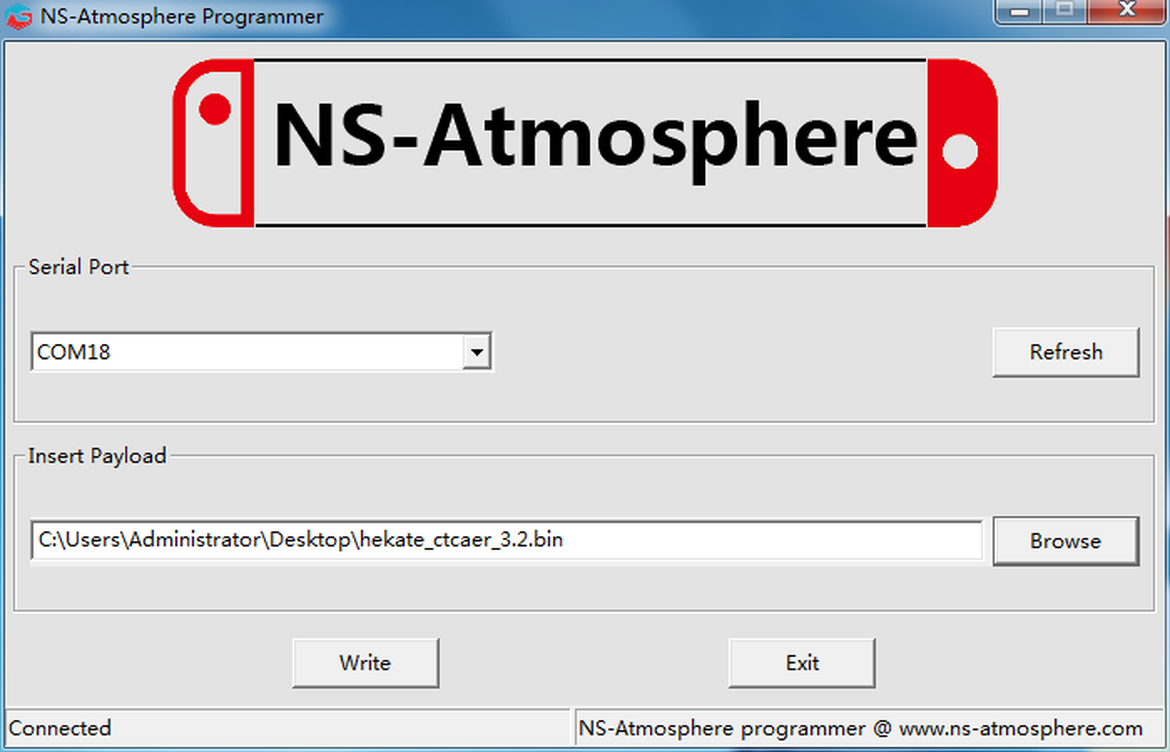

You‘re using this, right?
https://web.archive.org/web/20200629205538/http://www.ns-atmosphere.com/en/
And where it says Hekate 3.2.bin above your replaced it with Hekate 5.7.2.bin, correct?
Uhh no, this is my first time seeing this lol.
My switch (using SXOS dongle) never needed this but I'm guessing my brother's switch (AMS dongle) will need to utilize this?

Well updating the dongle worked. It launched into hekate and I loaded the fusee.bin. Thank you! My 3 hours of troubelshooting aimless was not in vain.
