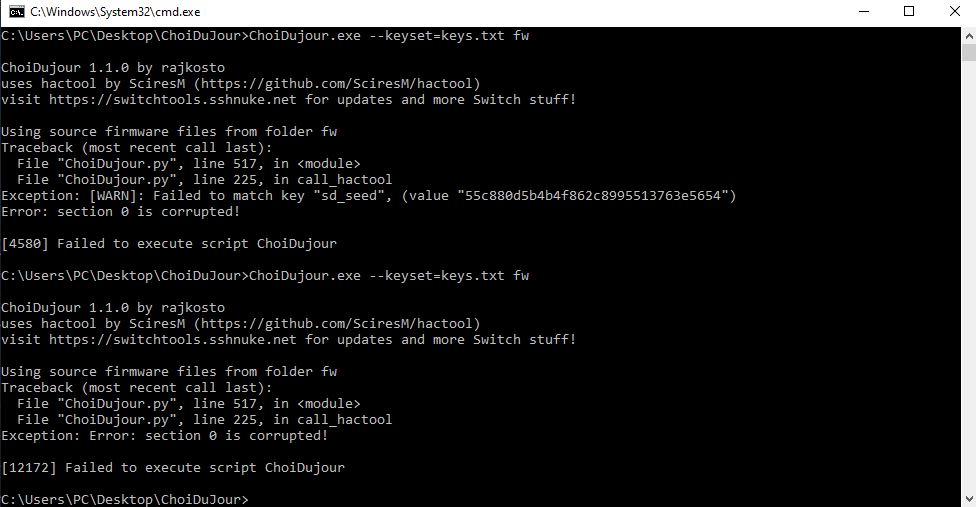

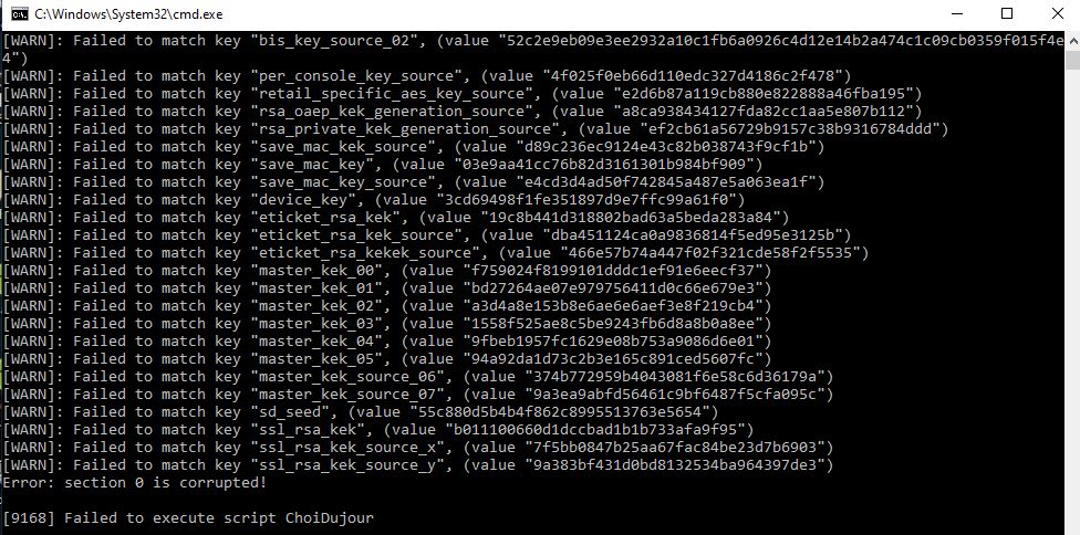

hello,
I'm trying to use ChoiDuJour to update my firmware for my Switch (it doesn't load Atmosphere because I downgraded mistakenly). I'm on Step 4 in the manual where I need to convert my firmware files but when I input my keys, I get an error in cmd (see image)
Are my keys incompatible or is it something else? Do I need to get new keys and if so, how can I do that if only Hekate will boot?

hello,
ChoiDujour seems to have issues when there are a lot of keys it doesn't recognize. Open your keys file and edit it such that only the keys listed here are remaining.

I tried that sadly, similar error
Where did you get the keys from?
No that folder is not automatically updated as you have to make the subfolders yourself for whatever games you're trying to modify.
From my SD card titled: keys.txt. The file is said to have been created back in December 2017
Might be worth creating a fresh dump with Lockpick_RCM.
Yes, I thought about that but I cannot launch Atmosphere at all. Only Hekate.

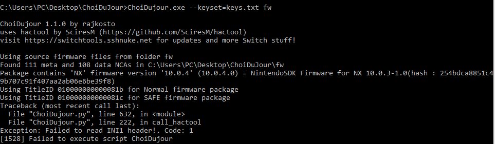

I took the new keys and the difference was that I was missing a few more master_key_#s
However, I am still getting errors. No more corrupted issues, now just something else.
ChoiDujour only supports up to firmware 6.2
Oh, I just read the image and it says I'm on 10.0.4! I thought I accidentally downgraded it to 1.0 or something. I don't really need ChoiDuJour if I'm on the 'right' firmware.
That said, I cannot seem to get atmosphere or OFW to launch whatsoever. Any help troubleshooting this as I have the latest atmosphere installed.
No the image says the firmware you are feeding ChoiDujour is 10.0.4 which is not supported. ChoiDujour says nothing about the firmware that is currently installed on your system.
