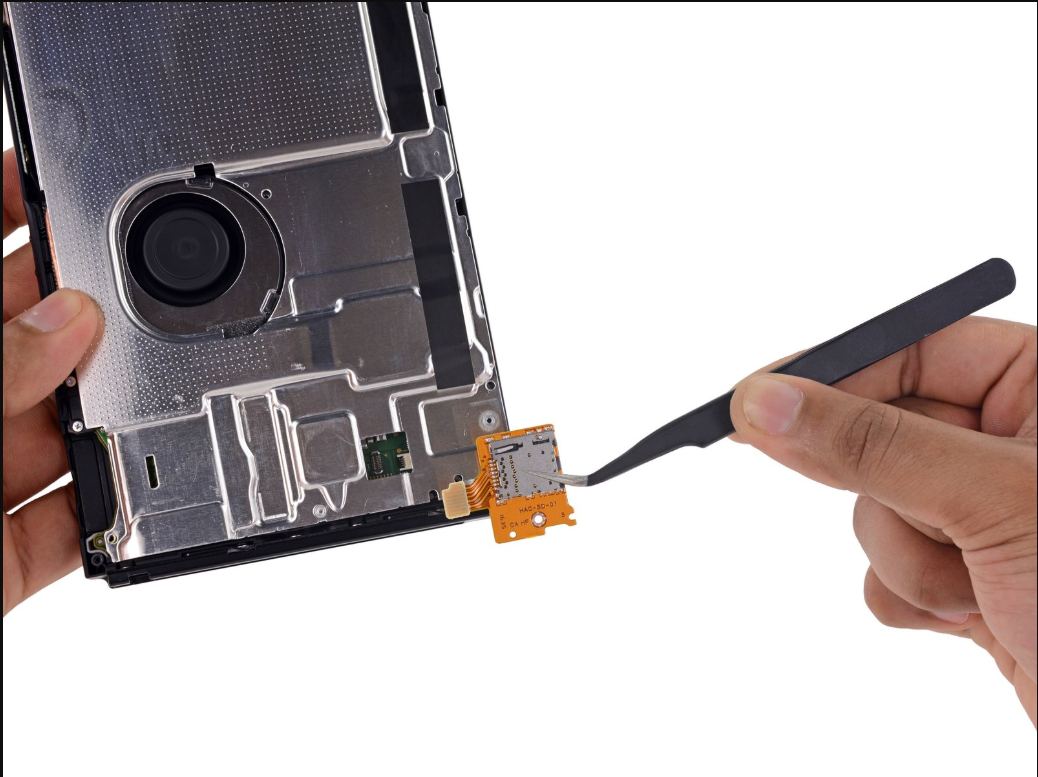

I would check actual slot, may be something get in.
You can reach card slot very easy just by taking back housing off:
One screw on the top (Philips)
Four on back (Tri-Wing)
Two on the bottom (Philips)
One on each side(middle one on the rail) (Philips)
When you will open console you will see card slot flex-cable, may be connection is bad or water get in, pins in a slot might be bent also.
Either way i hope that is not a motherboard issue.

Yesterday I tried taking of the slot, cleaning it a little with isopropyl alcohol and put it back in to no avail.
I also swapped the piece with a friends slot and did nothing to fix the error, my piece worked as intended in his console.
I removed the shield to take some pictures, here they are:
I am out of ideas, i would check elements around, compare multimeter readings with working switch to make sure hardware is good.
Over all pictures looks good for me, may be it's a software issue or maybe cards are faulty, did you tried to check those cards in your friend switch?
