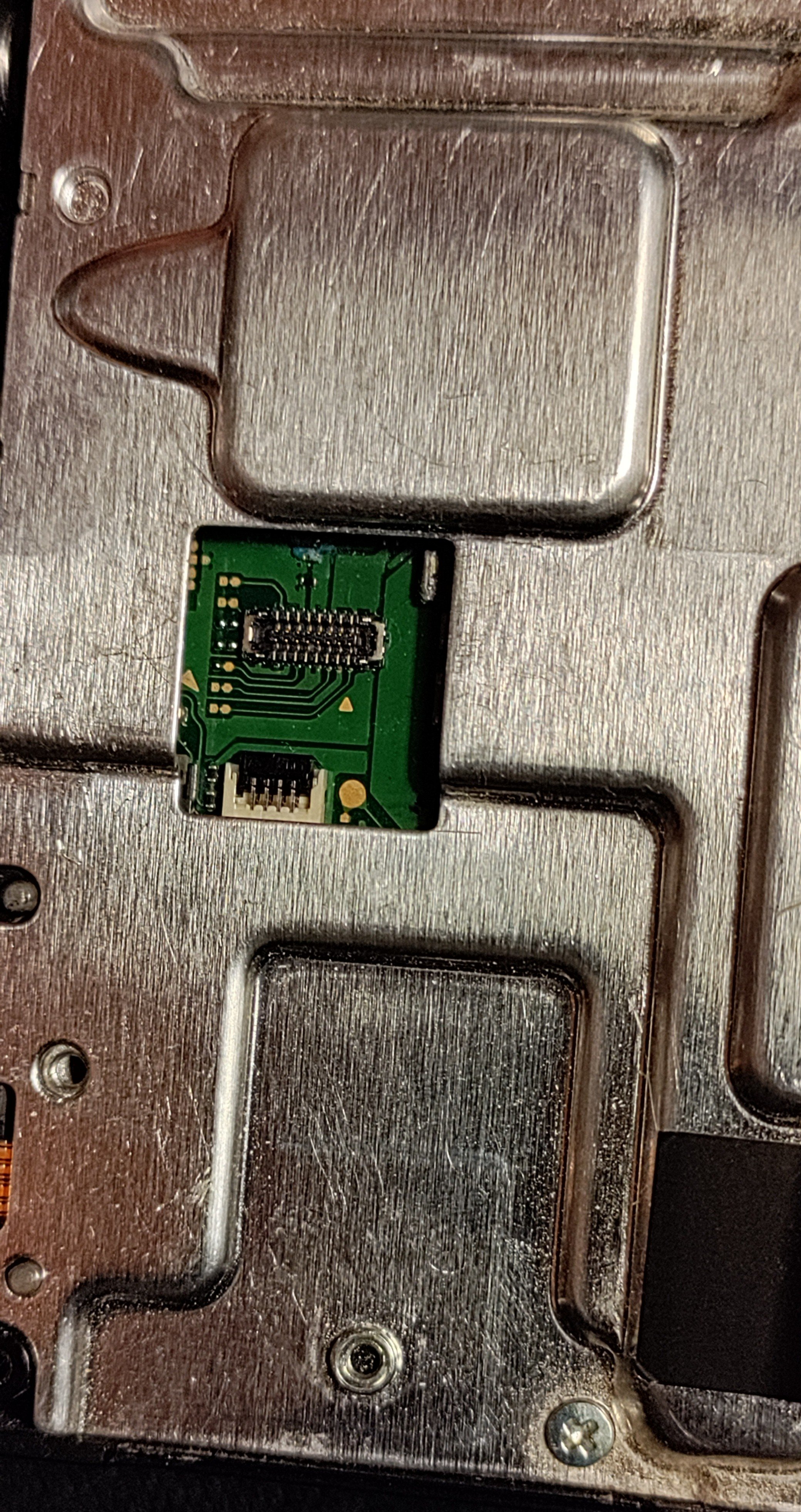

The connection for the microsd reader is notoriously flimsy and prone to ripping the pins out. Mines has broken 5 (FIVE!) times and I just had it fixed a few months ago again.
If you're lucky it MIGHT just be the reader is faulty. That's a $5 fix for a new reader off eBay. Take the back off carefully and see if the reader is connected securely. Order a new one and see if that fixes it.
If you're unlucky the pins are damaged on the FPC connector on the motherboard and will need to be replaced and micro-soldered a new connector on. The connector is just $5 but you'll need to pay $40/50+ to someone to solder it if you can't do that yourself.
8 pins on top and 8 on bottom. If any are broken it'll need replaced.

A few of them are ground and it doesn't matter if one of them is broken/missing. Most commonly, it's the corner ones that break. Keep in mind even if it looks visually perfect and nothing is loose it can have cracked solder joints preventing normal functioning. In my case everything looked OK and tested OK with a multimeter (one of the ground pins were missing but other than that) between the test points and FPC legs, so there must have been a cracked solder joint causing intermittent fault but the pressure from the multimeter probe while testing was enough to make contact.
You can solder wires from the test points directly to the microSD slot, bypassing the FPC connector rather than replacing it, but the pins are very small and difficult to solder, I did not have much luck with it, I could get the first wire soldered on but trying to solder a wire next to it would always desolder the first one because the space is so tight. Or a wire would simply break off at the solder joint while trying to maneuver the wires or the SD reader board. It's a highly frustrating repair.
