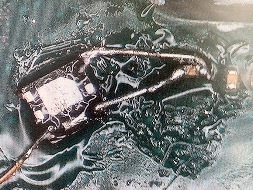

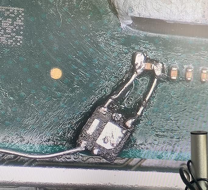

Need the 2nd mosfet. Had this issue with 2 mosfets and after replacing with a hwfly flex it worked. So my fet installs were wrong. I'm pretty sure I need a thicker wire due to the 10A draw. Gonna try thicker wires on my next one.

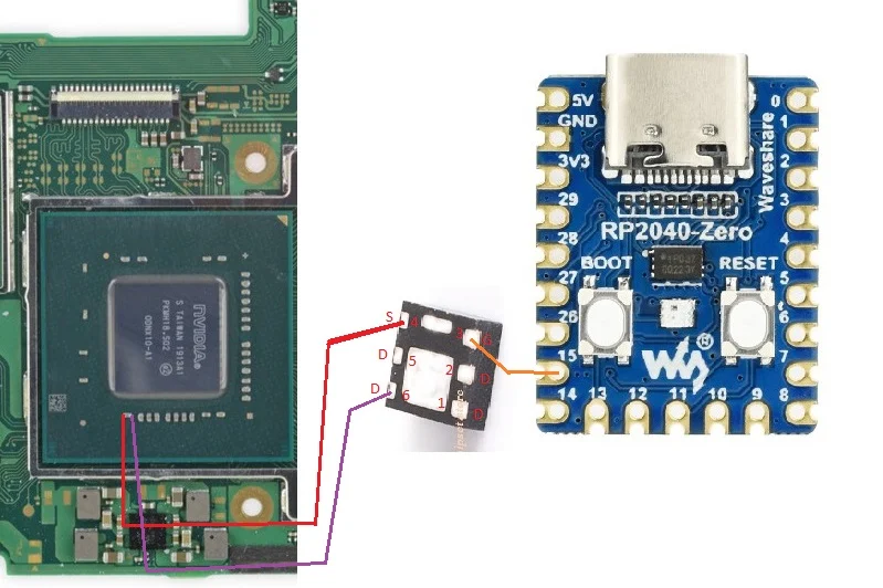

Well, I can now see a discrepency in the Mosfet tutorial pictures. There are two wiring schemes.
0.jpg is how I wired it
Mosfet Edit2 is the tutorial picture I followed.
1679414050593 is how I see most mosfet installs.
Now sure whats going on.

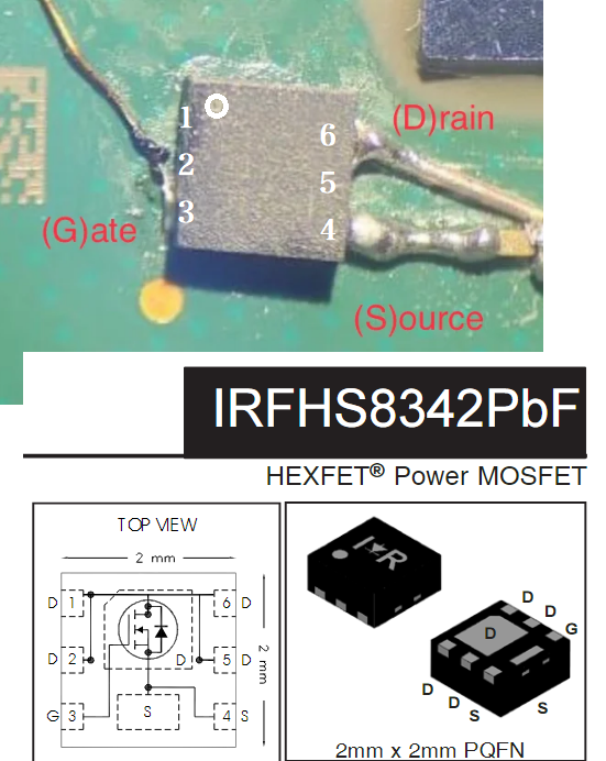

I was able to fix it. The picture under the name "Mosfet Edit2" is wrong and dangerous. It's circulating around many forums.
This is "picture :Success"how the Mosfet should be wired, booted first try with only 1 FET.
first 2 images are grong
