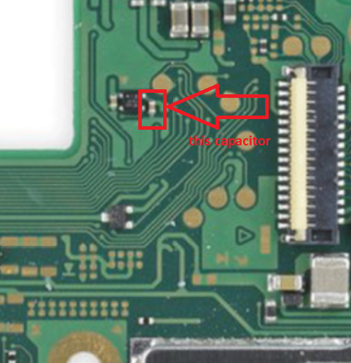

Hello,
I tried to solder a Picofly chip onto a Switch Lite, but I messed up on the capacitor at the 3.3V point, and I accidentally desoldered it. I believe it’s a 0201-size capacitor, but I don’t know its value. If you could tell me what it is, I’d appreciate it.
Does a 1 µF, 6.3 V capacitor in 0201 size do the job?
Also, is there any technique or something to make soldering easier?
I’m not sure if I'll be able to put it back in place. Thanks.

Reflow hot air station is easiest for surface mounted components rather than using your soldering iron.
Yeah i don't have it, i should buy it a day
I try with a 1uf 6.3v 0201 and it's work !! I hope it will ok a lof of time !
If you know what value of capicitor it is i would like to know it
