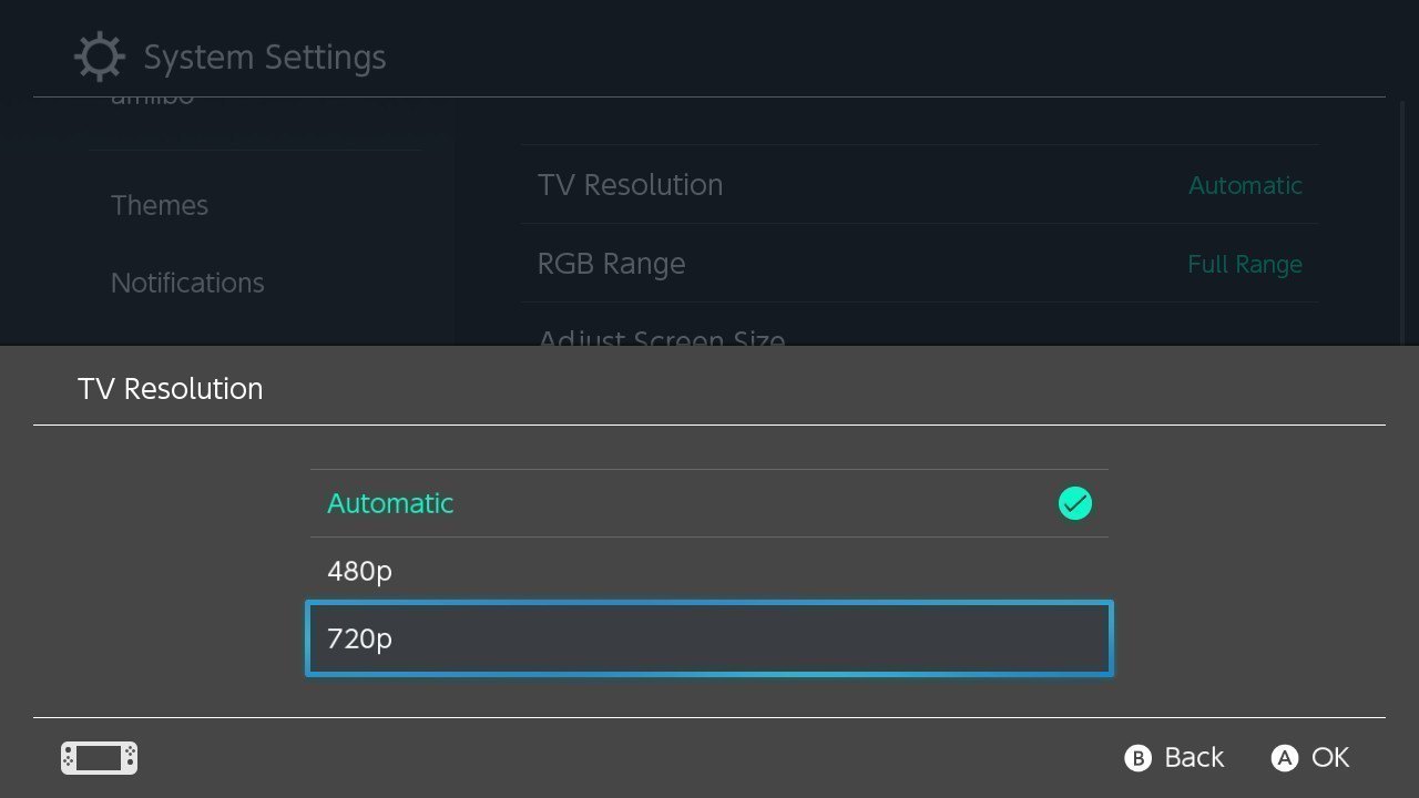

    I noticed that when I go to my settings in system menu, I don't have a option for 1080P. Does anyone else have any problems or knowledge of this?

    Can you post a screenshot? Every screen I've seen of the Switch's TV Resolution option (including the one posted earlier in this thread) shows Auto, "480p", "720p", and "1080p".

    New York

    Is your TV a true 1080p TV or is it a 720p TV that allows you to downscale from 1080p to your tv's native resolution?

    Add to that: What's the brand and model number of the TV?
    It could very well be a bad EDID. This was notorious for causing all sorts of problems on Linux systems some time ago. (One Samsung TV caused my ThinkPad T60p to run ridiculously slowly due to a broken EDID.) The Linux kernel's EDID parser nowadays is more robust and full of special cases to handle these broken EDIDs.

    your Tv is a 720p (1360x768) my tv doe the same with ps4 pro show 1080p but when i add a switch it did the same as you the switch detect the maximum output resoultion which is 720p...a full hd tv with 1360x768 is still sharp enough to think it is a 1080p but hey 720p is still nice and if it is full ips like mine that a plus!
