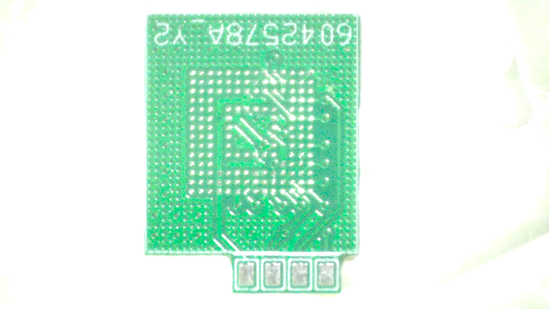

Is it possible that a reball could be enough to make the eMMC work again?
Does it make sense to use such an adapter if the eMMC has already been replaced?
I would like to buy a new eMMC. Should it be the same as the one already installed?
(i.e. the SKhynix) or can it also be a different one, e.g. SanDisk?
