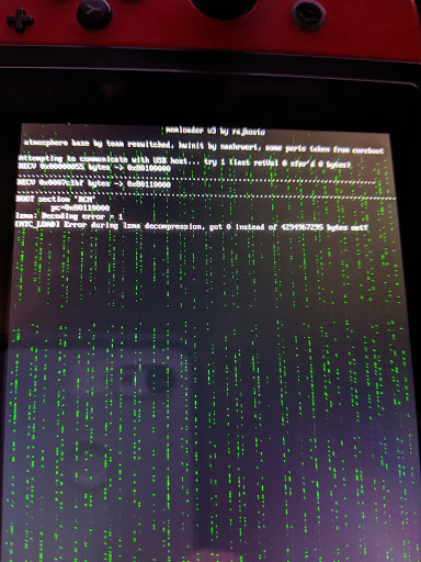

    When I try to use memloader it gets all crazy looking like the matrix and gives a weird error. I attached a picture showing what I'm talking about.
    I am going to open it up again tonight and check the connector where the SD card reader connects. I've seen in other forums that the connector pins can come off. Hopefully that's not whats happening.
  18. Canna
    Canna Bad Ass Poisonous Mushroom
    Joined:
    Jul 14, 2018
    Messages:
    1,379
    Country:
    Format the sd card to Fat 32 and try again. please
    And does the console boot into OFW without sd card inserted >?
  19. Jamie Jenkins
    OP Jamie Jenkins Member
    Joined:
    Dec 7, 2015
    Messages:
    43
    Country:
    Okay, I tried formatting to Fat32 and tried to make a backup of the Nand but it still says Failed to init SD card and I have had no luck getting into OFW with or without the SD card. If I go into Console Info in hekate and click on "print eMMC info", it says Failed to init eMMC.
    What's weird is that the SD card reader does seem to be working for some things. In hekate under Console Info, I clicked Print Fuse Info and is showed that it saved 2 files to the SD card. I removed it and there are folders and files on the card and it was completely blank when I booted into hekate. On the card, there is a folder named: BOOTLO~1 with 3 empty folders and a file named: HEKATE~1.INI. There is also a backup folder with another folder with the I guess console ID, it's the same folder setup I got when I originally made a NAND backup. In that folder there is another folder named dumps with 3 files named: V]CEWA~1.BIN, V]SE_C~1.BIN and V]SE_C~3.BIN which I am assuming is the files it backed up after clicking Print fuse info. All of the other print options freeze the console.
  20. Canna
    Joined:
    Jul 14, 2018
    Messages:
    1,379
    Country:
    Right so here goes,
    Originally i thought you had said that OFW was working fine, that you can get in or to the nintendo main menu without a sd card in..
    Now..
    If you cant boot into OFW then sir you have bigger issues then a sd card..
    The sd card and or reader maybe fine, but a bad diagnosis.
    That said, its time to look at or fix nand.
    Try something for me.
    Remove SDcard.
    And go into hekate and take screenshots or pics of the emmc information.
    If it does not work. Then we need to look at the emmc module,
    Could you be a little gentle and remove the EMMC module, check the pins on the zif socket.
    and reseat it.. Do you get emmc info in hekate now ?
    If not . Try this.
    Use memloader payload but this time mount the EMMC
    Then use Nx Nand manager or hacdiskmount. and see if you can load the pyhsical drive..
    Im thinking now that you have Emmc issues,
    Get as much info out of Hekate take pics and post, also same with memloader and or any errors you get along the way.
    If you cant boot ofw, then you def have hardware short,failure or corrupt emmc or dead emmc, il say it how it is..
    You was playing a game and it froze, now you cant boot ofw and your getting Weirds emmc or sd issues, Im hoping you didnt overheat and cause a cold solder joint..
    I dont mean to scare ya or think oh ffs. But we need to look at nand now..
    If your able to restore or not or even boot into OFW should be our first step.
    You say you have a backup,? Did you backup boot0 boot1 and your system keys ?
    You should.we may need those.
    Also thinking about it, try sending the LockpickRCM payload also, with sd card in. See if you can dump keys Without getting errors of unable to read package 1/2 etc..
    Report back. Hope i made some sence..
    Jamie Jenkins likes this.
