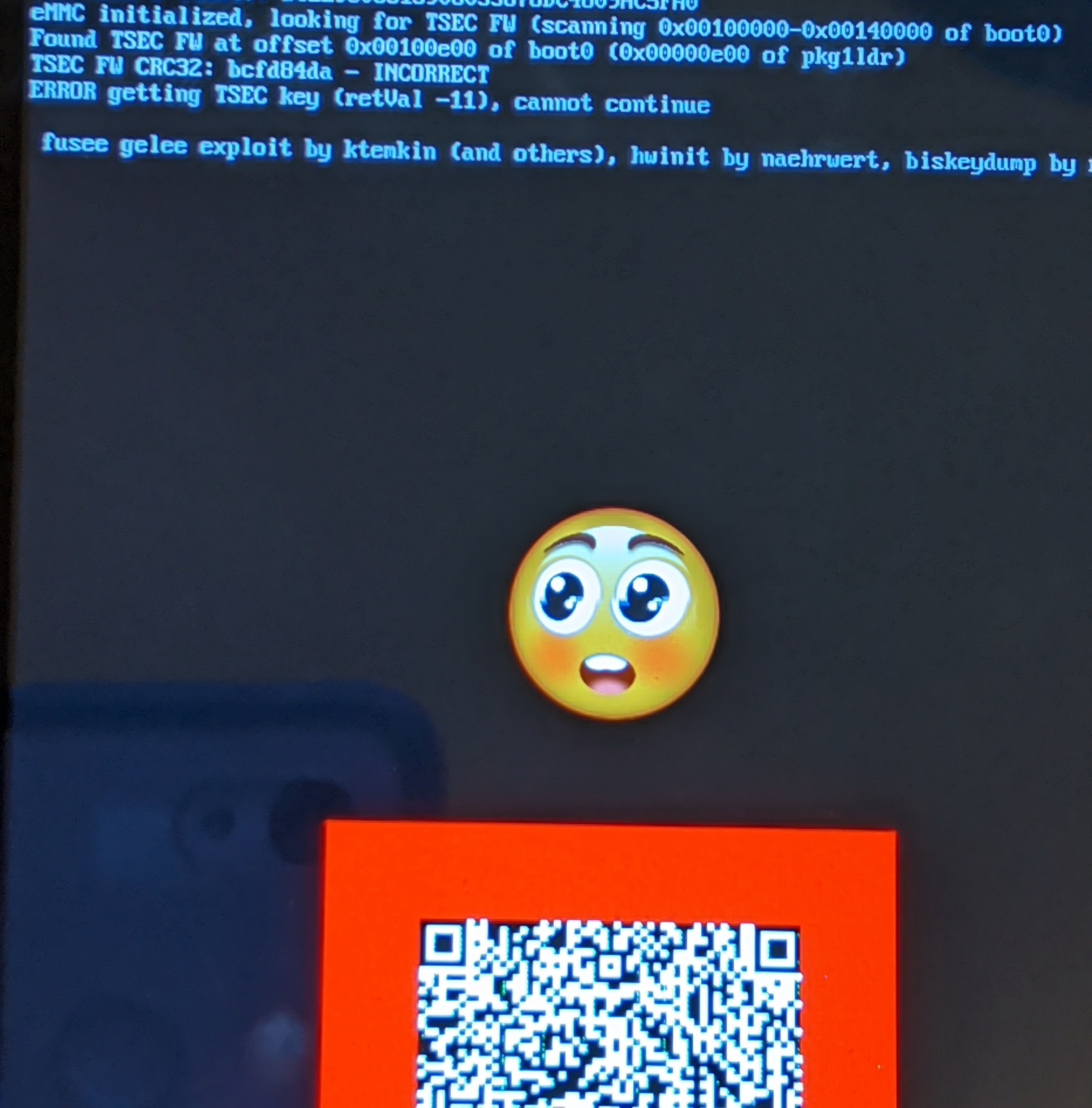

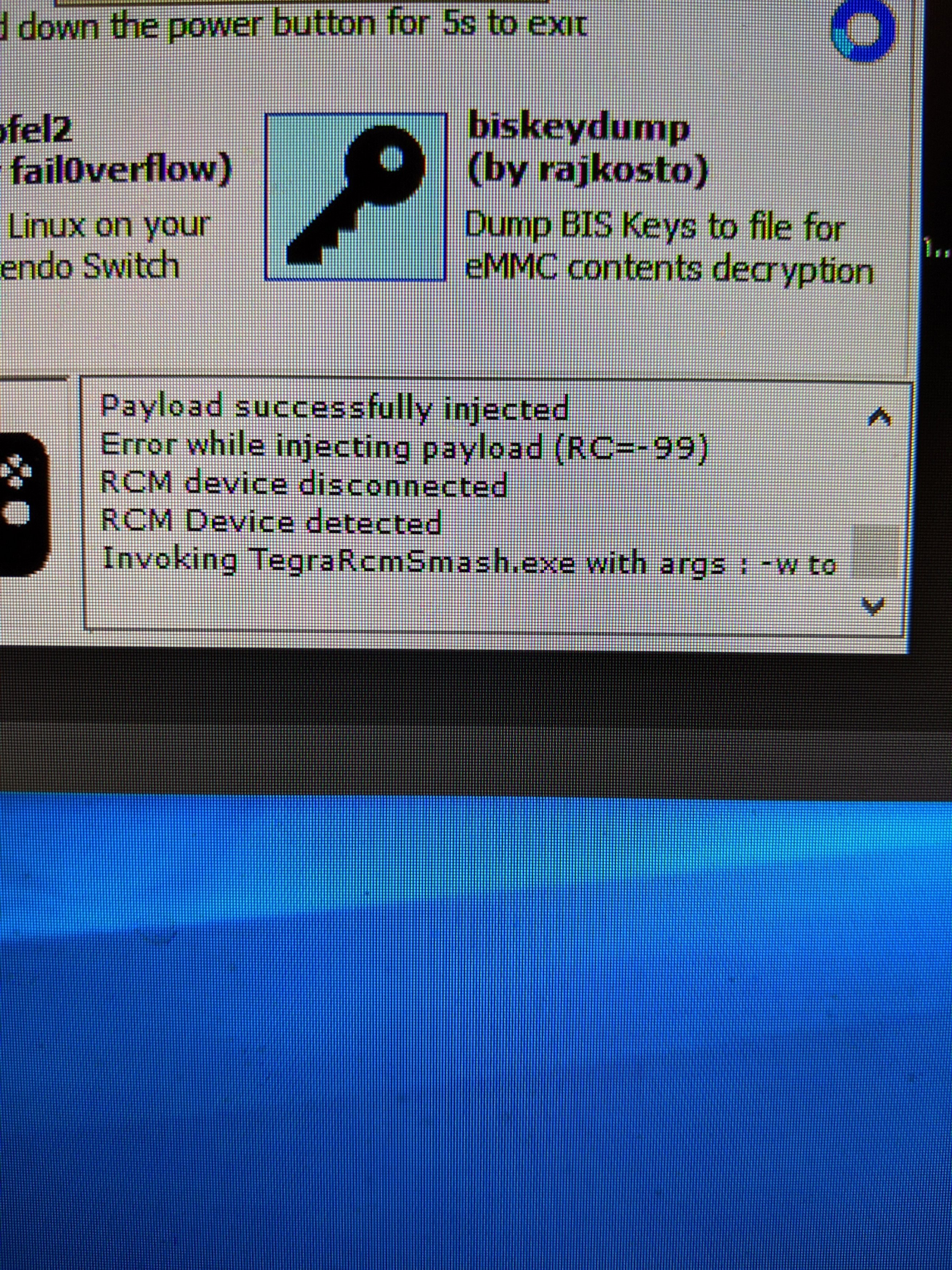

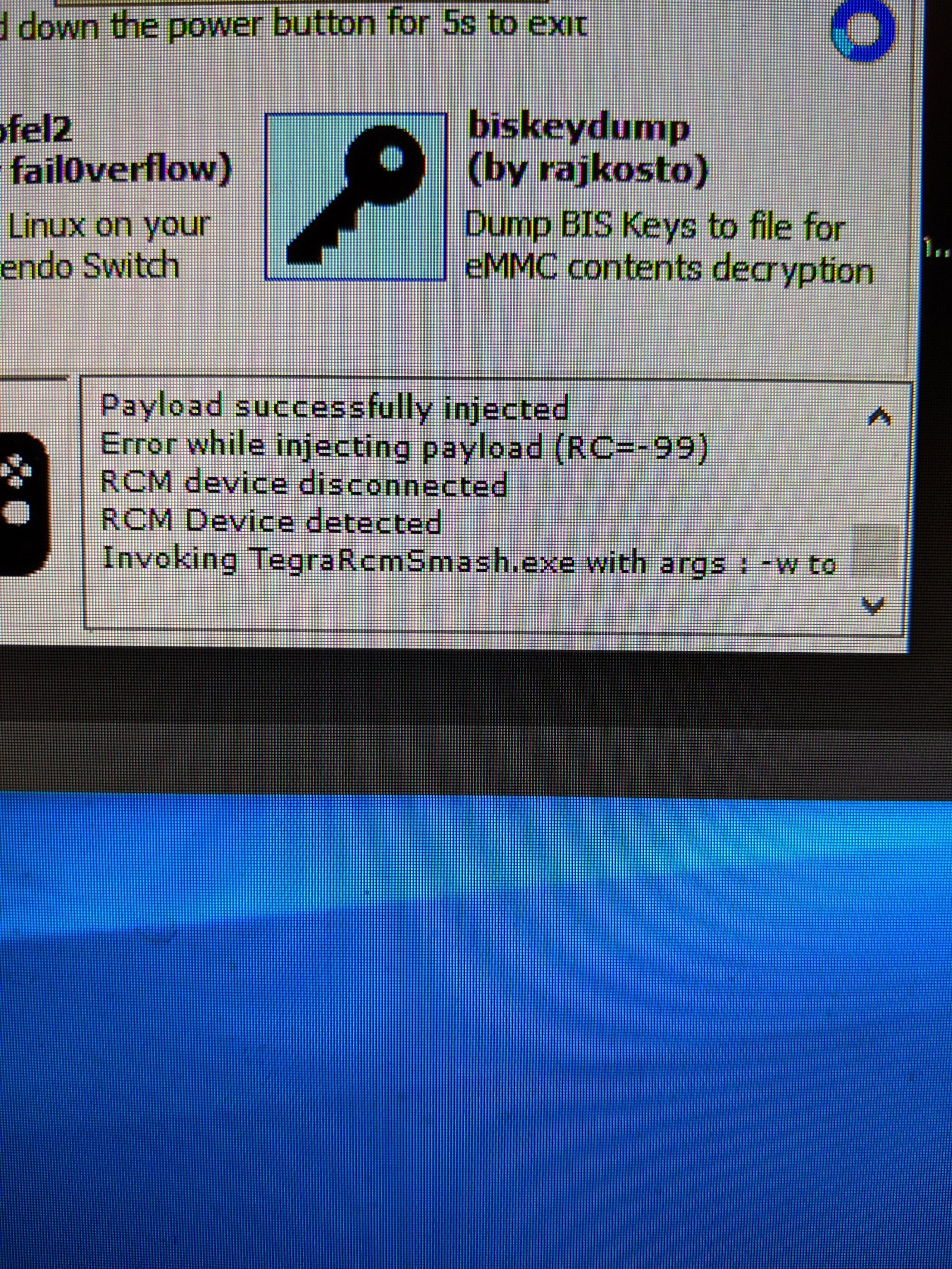

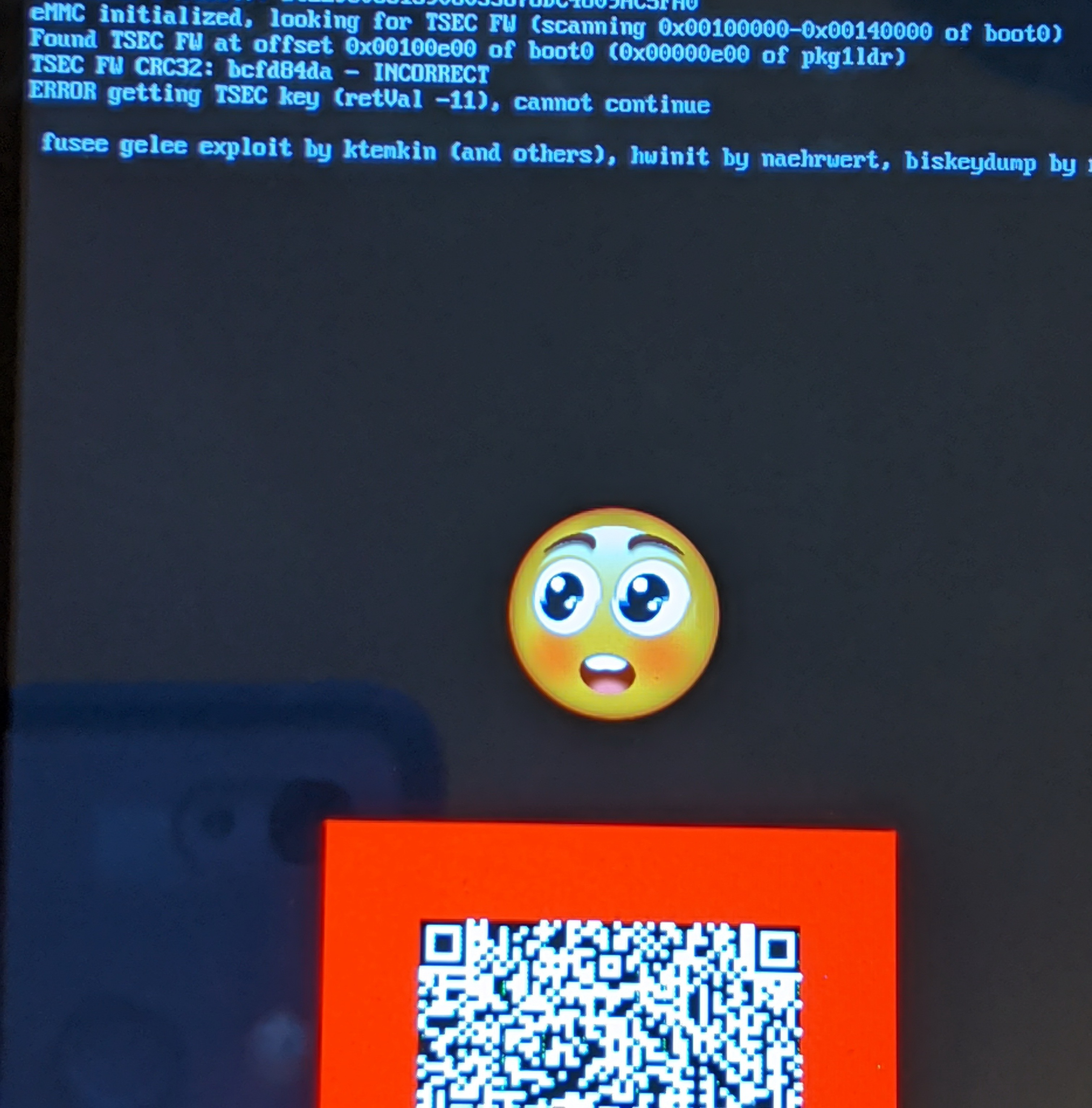

@mattytrog I don't know if this is any useful info but I tried dumping the biskeys and it creates a text file but it only has the HWI and SBK numbers in the file. It shows "ERROR getting TSEC key". I attached a picture of what it shows on screen and on the PC.
Also for some reason, before today when I would select "print emmc info" in Hekate it would show Failed to init emmc or just freeze, but today I got it to actually show all of the correct info like it is supposed to a few times.

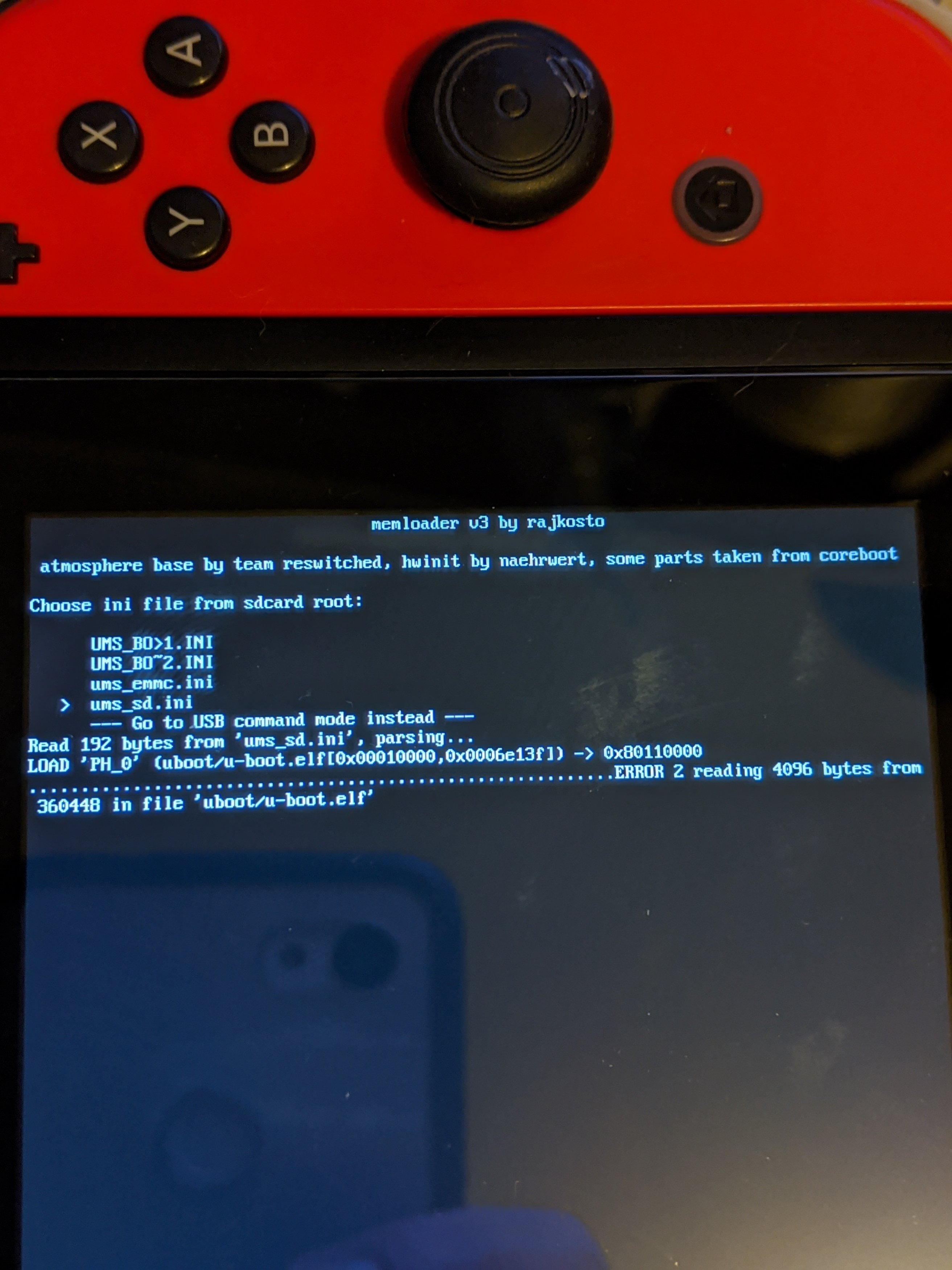

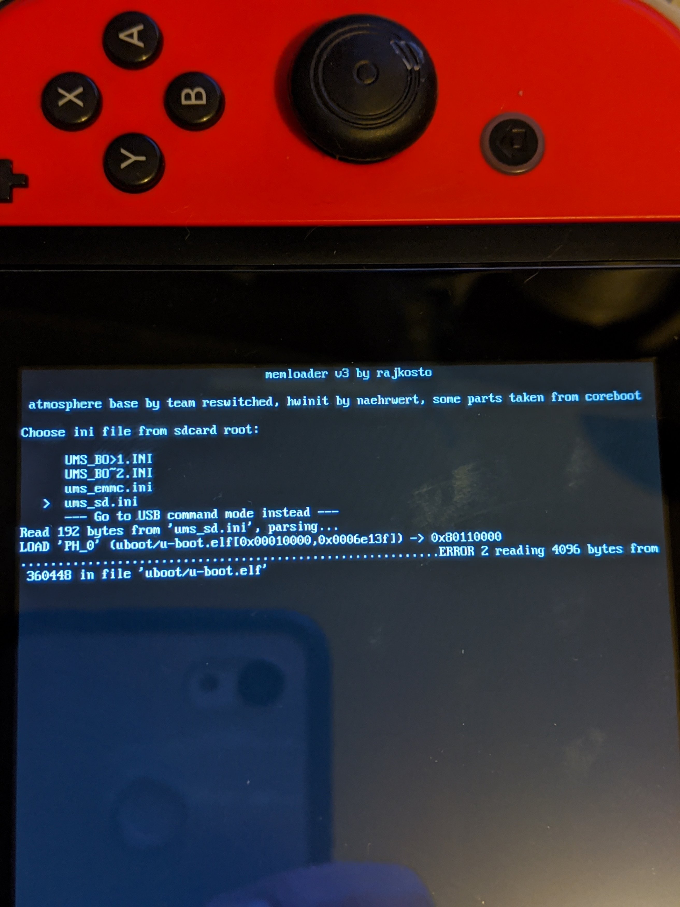

I was also able to get memloader working a little better now but it does give error 2 and I attached that picture as well. Maybe this additional info will help shed more light on the issue.
If I were to buy an emmc module replacement, would I even be able to get it working correctly without all of the info from the biskeys?
View attachment 190347 View attachment 190345 View attachment 190346
see if you can run emmc from memloader and backup on pc with nxnandmanager,
