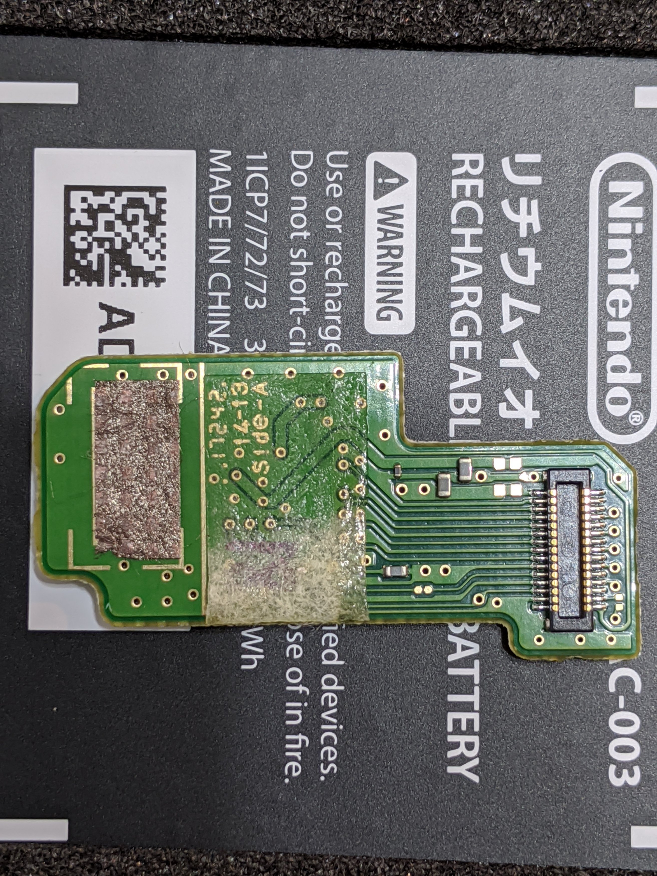

Okay, so when I try to view the emmc info, it will either tell me, Failed to init emmc or the screen will freeze. I opened it up and removed the emmc module and took a look at the zif socket and all of the pins look good to me. I am attaching a picture of it and the connector for the SD card reader. I reseated it and ensured it had a good connection and put it back together but had the same results.
When I try to do anything with memloader including mounting emmc, it always says Failed to mount SD card. I attached a pic of that too.
I do have a full backup of the NAND and want to try to restore it but don't know how I can do it without memloader working.
Also when loading LockpickRCM payload, I am unable to dump the keys as I get errors for the SD card. I am also attaching a pic of that.

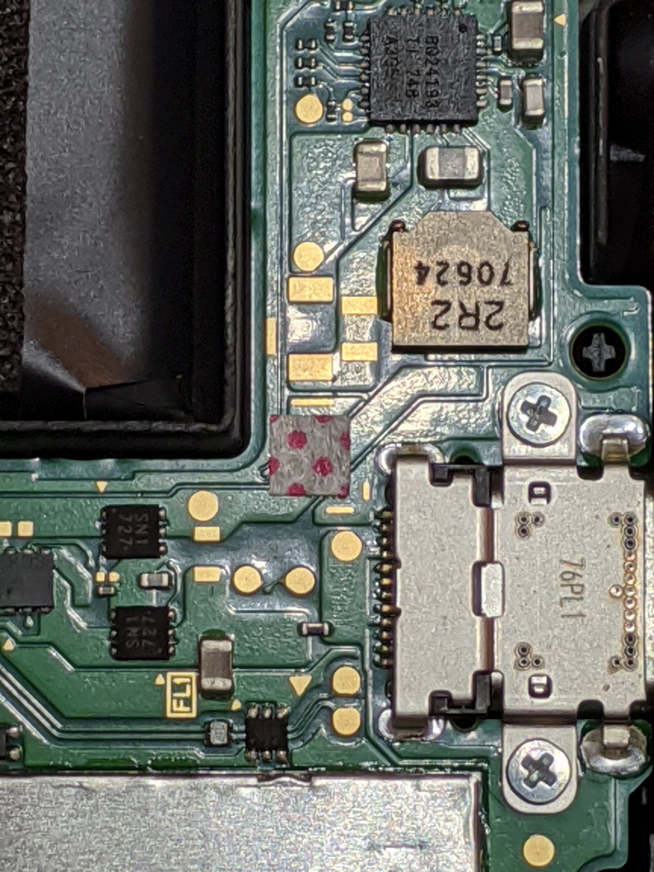

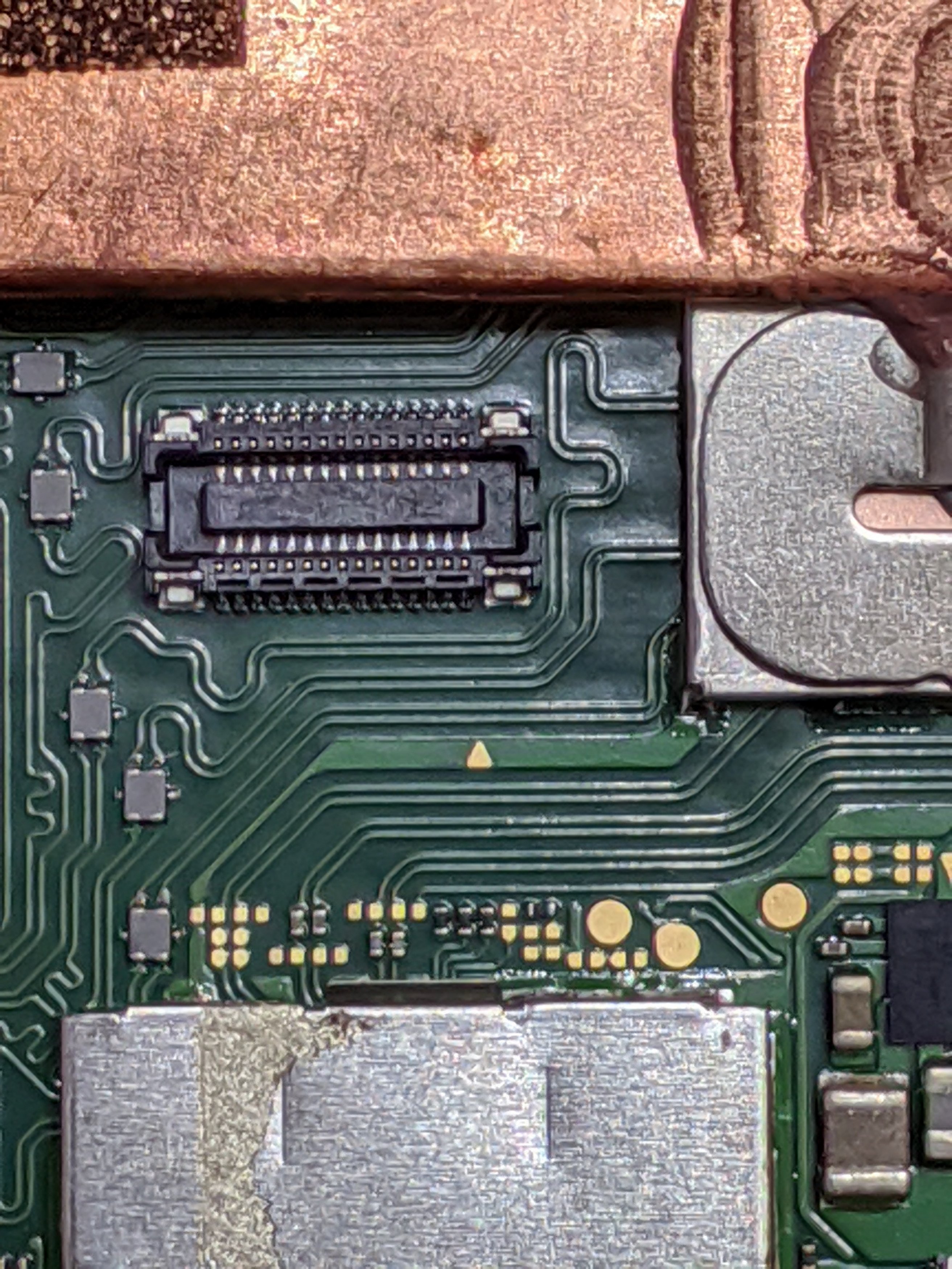

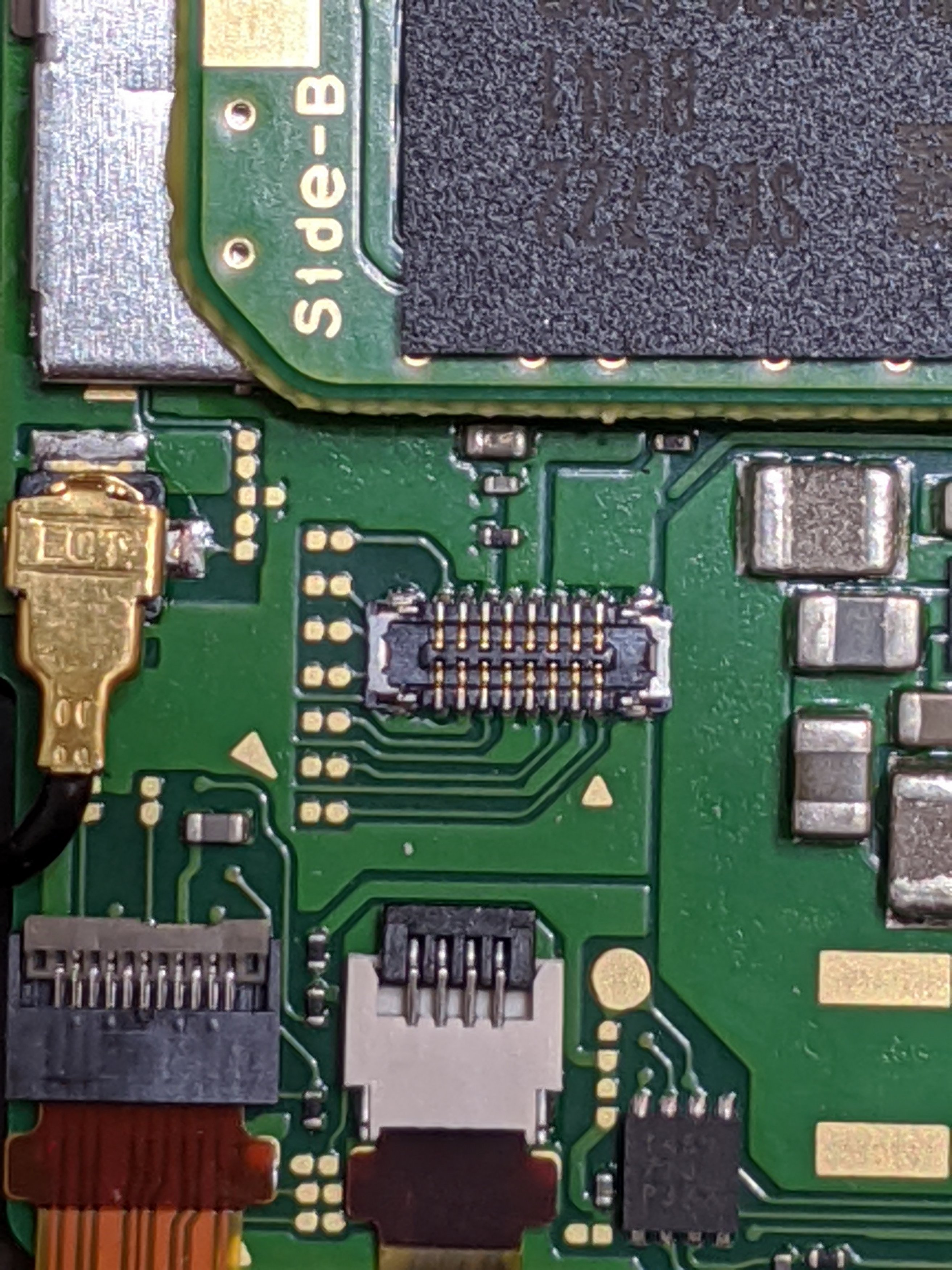

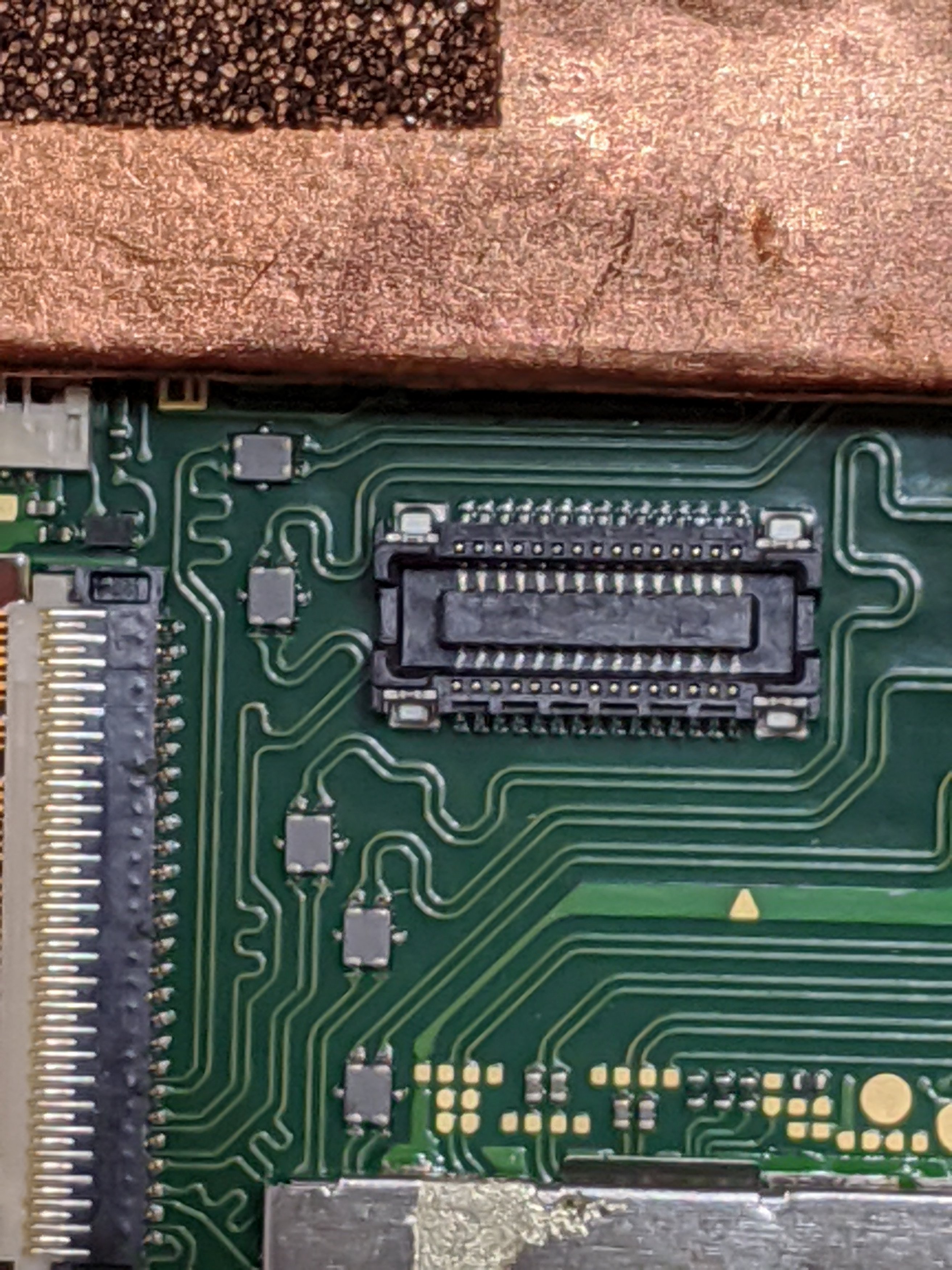

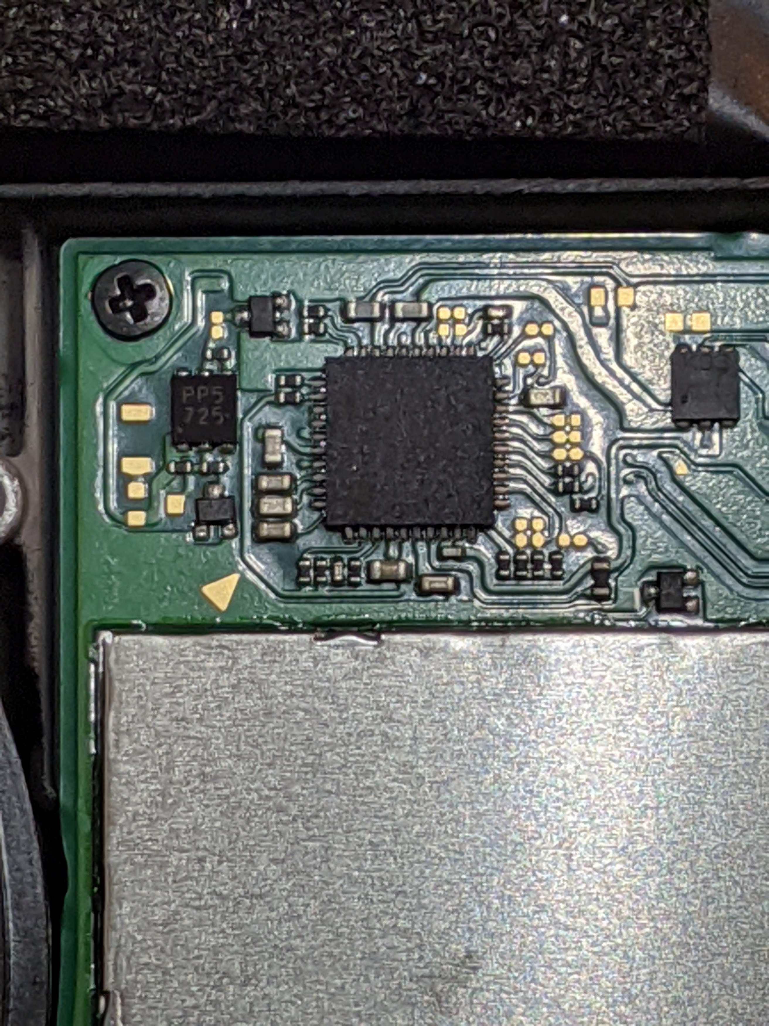

Need some better pics of board. Ideally around SD btb connector and about an inch all the way round it.

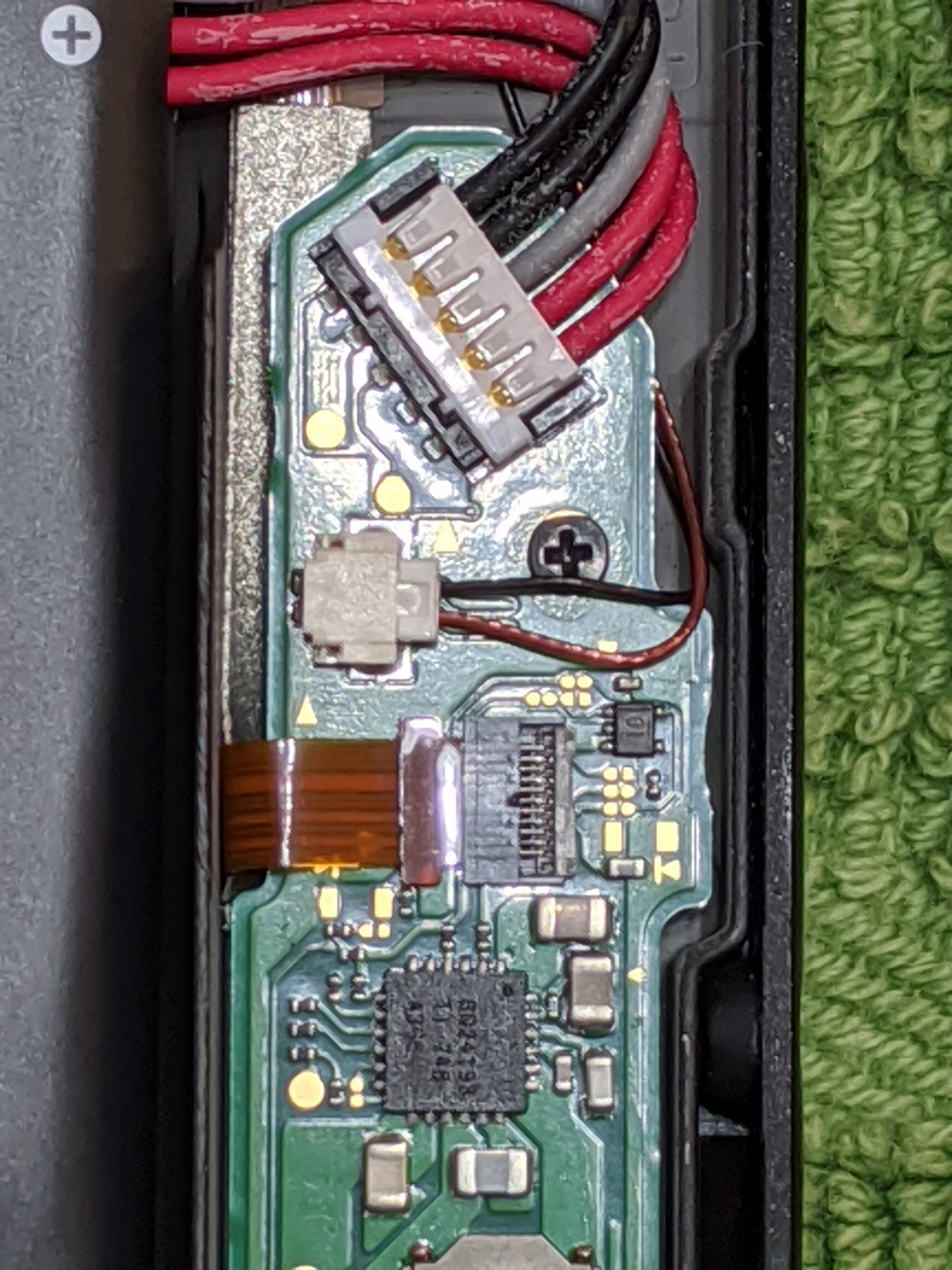

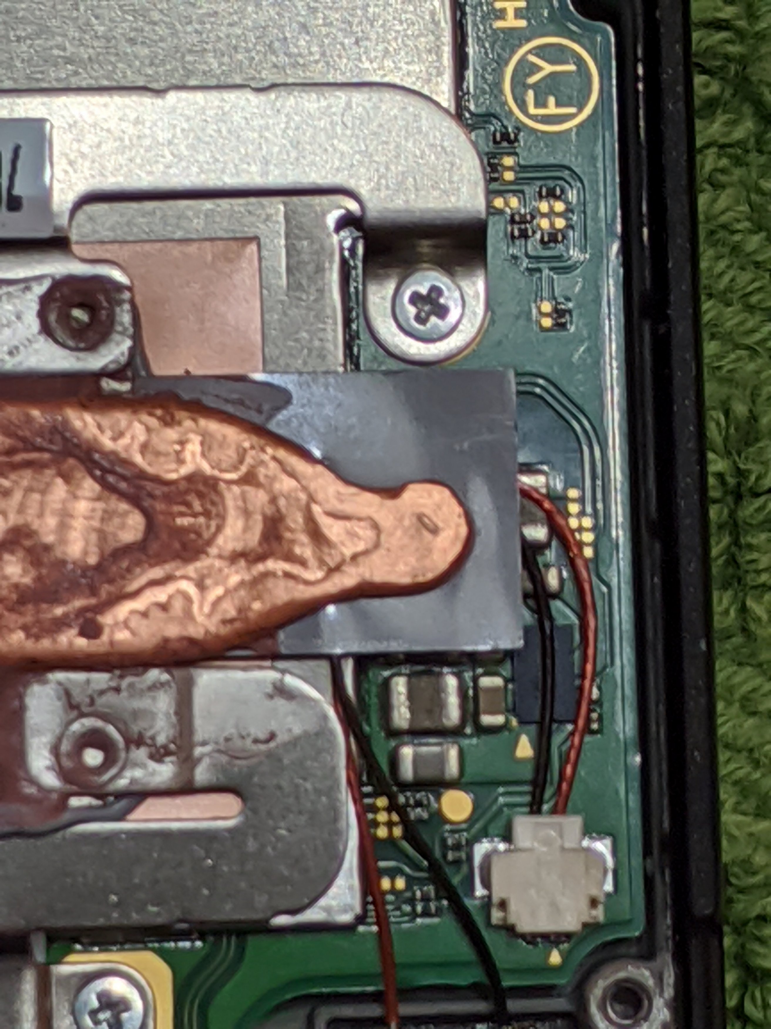

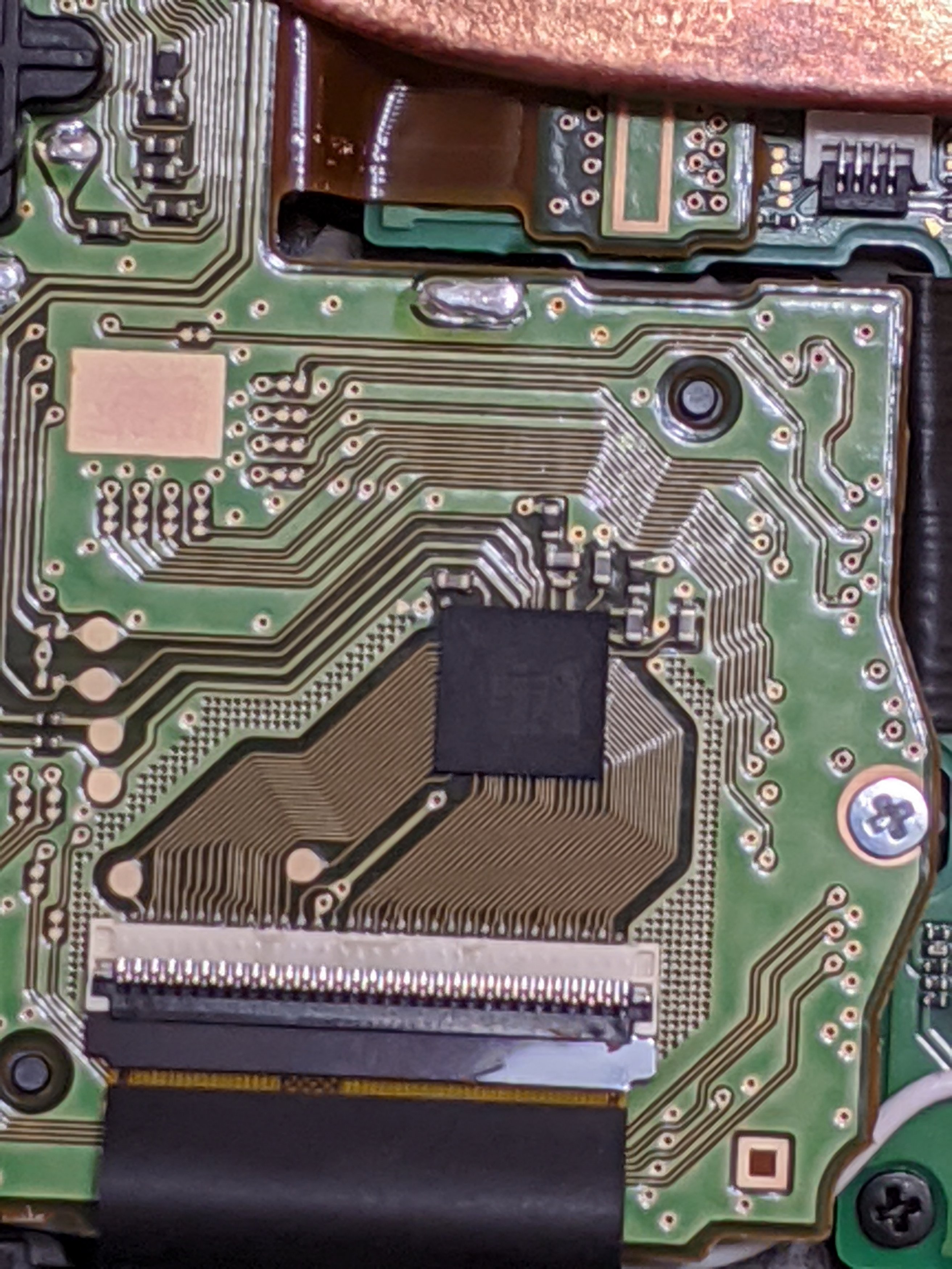

Hey mattytrog, thanks for looking into this for me. No mods have been done to the console. The first time it was opened was the other day when I replaced the SD card reader. I also have not had any charging problems except for not getting a green light anymore when plugging in the power/placing in the dock, which started when I first posted about the issue.
I am attaching some pictures, I just moved around the motherboard, and the emmc module. Hopefully these will suffice. If not, please let me know and thanks again.

Your welcome, wish id of known about the no green light before the mention of sd card lol.. I think matty's right a short or blown cap probably, matty will help track it down, your gonna need a multi-meter budd
