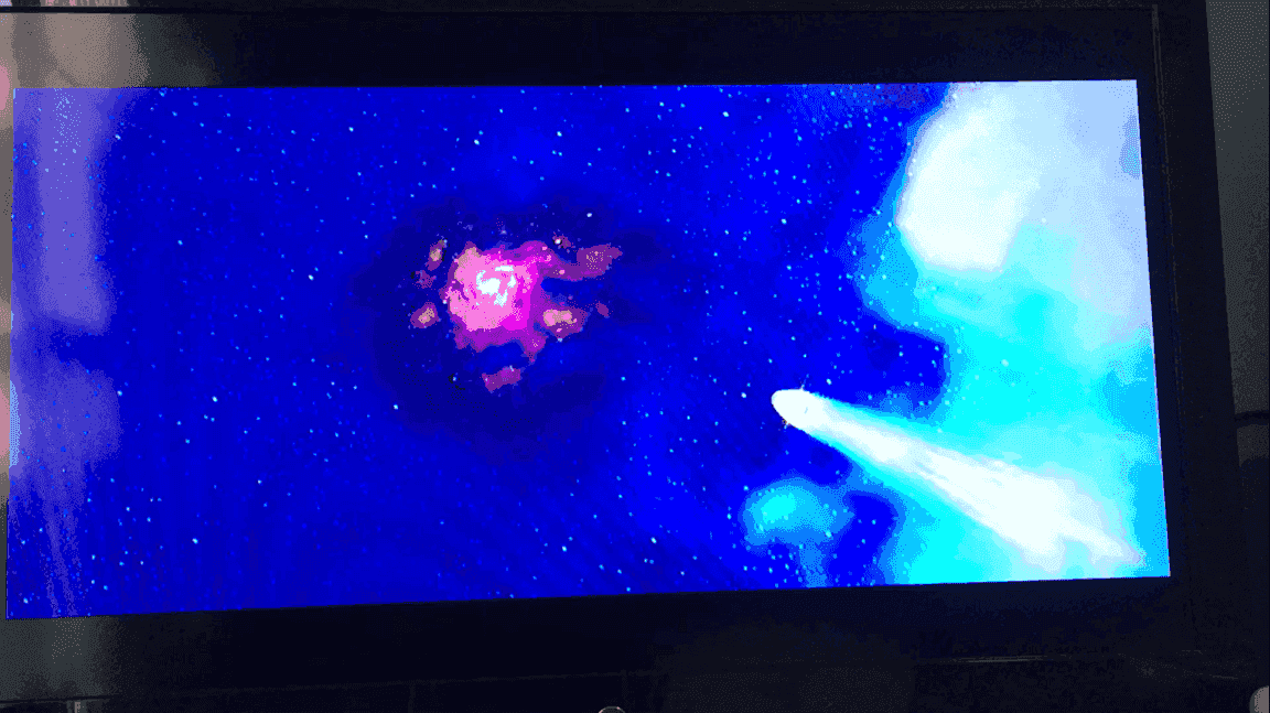

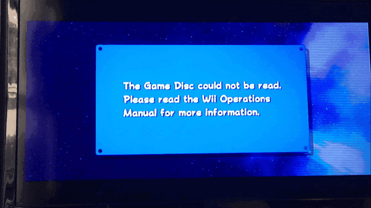

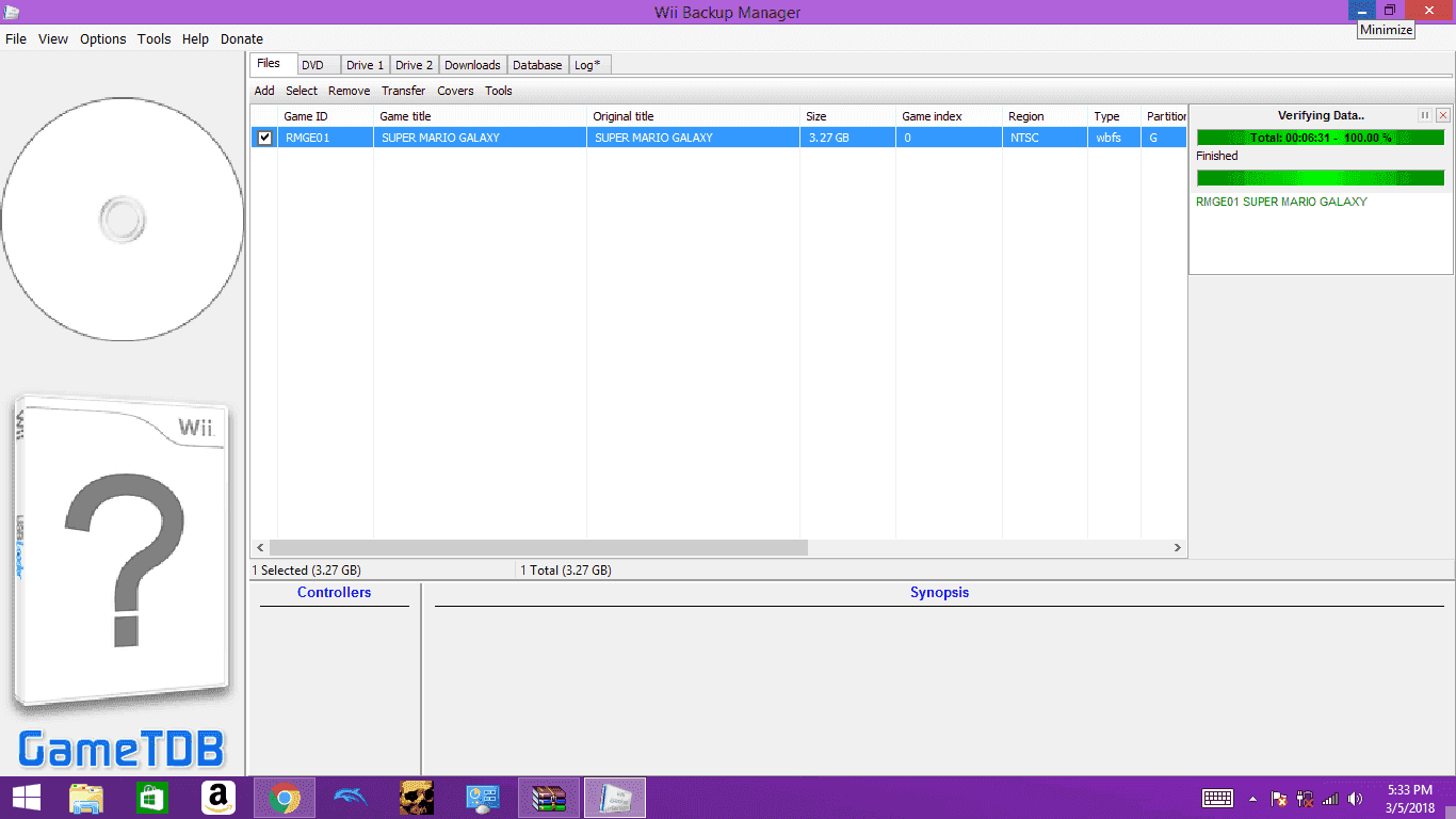

It does freeze during a cutscene or video, and I think I did everything you said, unless i was supposed to "export" the checked wbfs or something. It still freezes even though WBM showed a completely green bar. I've attached images of what happens when I play it through disk and what happens when i play through a loader. The second image is for the loader,and stops at the same place the disk version does. Also, I'm probably uploading images incorrectly, because when I preview this I apparently don't have permission to view the images, so if that's the case please let me know (Fixed it I think)

if WBM detected no error, it means the problem is not your ISO. all files have a checksum value to verify if the file is good or bad. If a single file was bad then WBM would mark it red, not green.
When playing from disc, it could be the disc reader (laser, dust, etc.)
but if you have the same error when playing from a loader it's strange. you dumped the game yourself? you didn't edit or apply any patches to it? (generally using WiiScrubber)
If it's not hardware failure (uncommon that the hardware happen always at the same location in the game), it could be a setting.
Do you have cheats/ocarina enabled?
which cIOS base/version are you using? (some games crashes if using a wrong base, for example Arc rise Fantasia needed base56 and froze with base38, when entering a specific battle later in the game).
