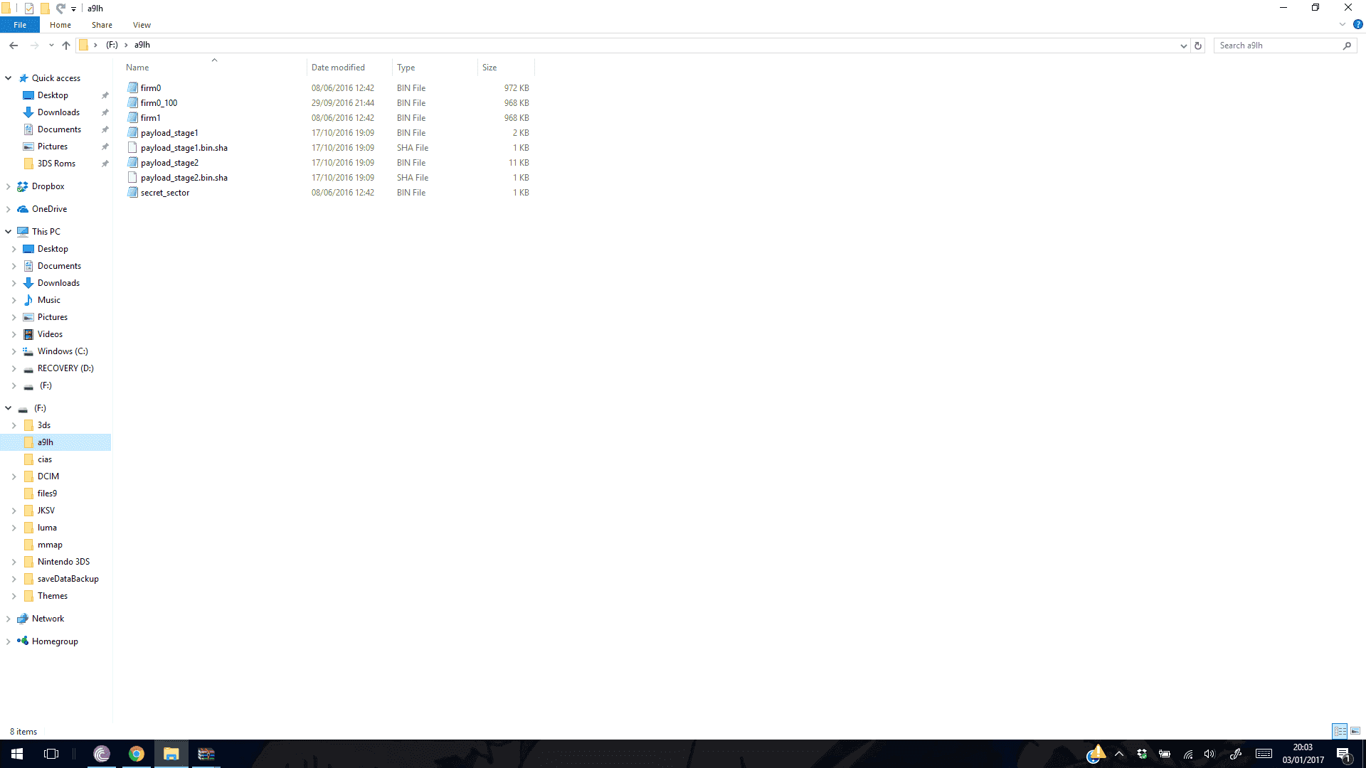

I got onto 2.0 but when following the arm9loaderhax I do the SafeA9LHInstaller part but get the error: firm0.bin doesn't exist or has a wrong size.
Thing is the tutorial said delete the a9lh folder and create a new one with the files of release.7z
Post screen of your a9lh folder.

you need to place the arm9loaderhax.bin from luma zip on the root of your sd, instead of the installer arm9loaderhax.bin
Found the missing files but still don't have a otp.bin file
