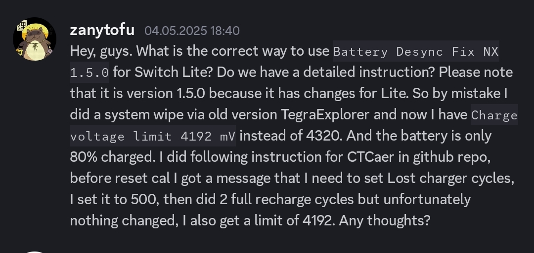

As long as calibration data fits your device, you don't need to worry about it. Issues start when it doesn't fit. Most people are waking up to this after wiping their nand without any backup which results in complete lack of calibration data.
Fresh example:
After that no homebrew will help you. Dunno if porting from one similar unit to another can help and if it's possible at all. We know only that it's possible to fix this with I2C, but not permanently since this would need to run as sysmodule constantly in background.
Maybe I just worry too much and there won't be a need to do any replacement, just have it in mind when you see battery charging issue after emmc swap.
Fresh example:
Fresh example:

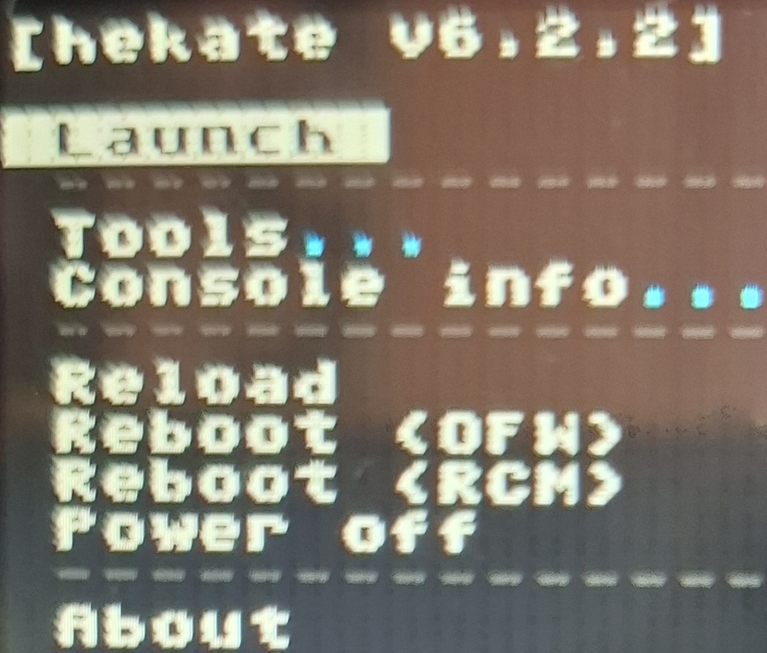

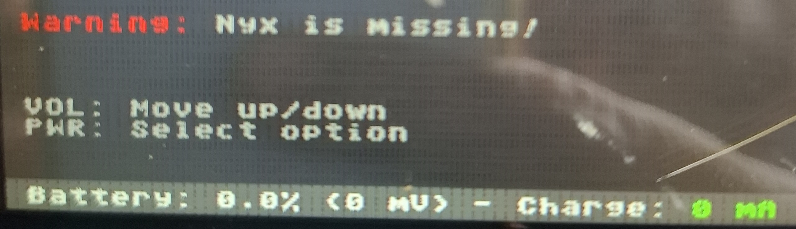

New update:
Some erros:
You didn't put all Hekate files on sdcard
Yep, that sd card works in another switch without problem
Some times, give sd read errors, like no sd card (this was bad conection, solved)

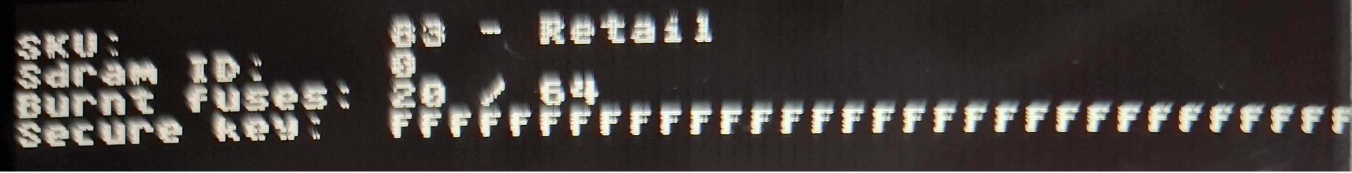

Battery, soc and emmc info, compared to a god console:
sdram_bad:0 vs sdram_good:12
Battery_info_bad:0 vs Battery_info_god:values
emmc_bad: no gpp data detected emmc_god: yes gpp data
