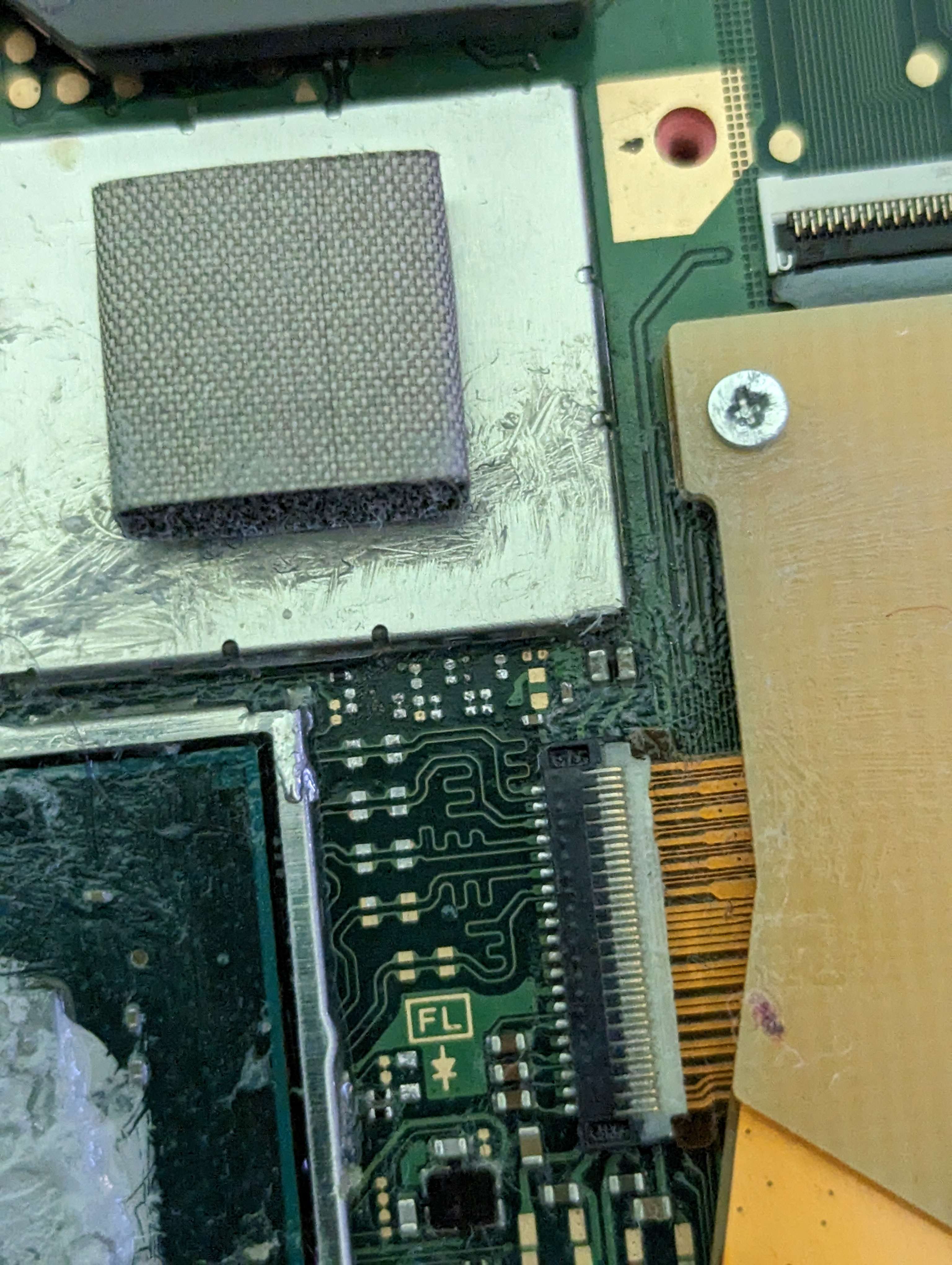

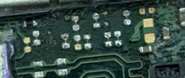

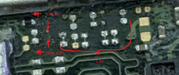

Hello all. While trying to install the HWFLY in a lite, I accidentally ripped the CLK/D point pad. I still get a diode reading of around 550 on each side of the pad, but with the battery plugged in I get 0V on top and 0.9V on bottom. All pads to the right get 1.8V, just the CLK/D and everything to the left towards the APU get 0V. Anyone know how to go about repairing the pads?
Any help is much appreciated! Thank you
EDIT:
The top half of the CLK/D point reads about 0V to 0.07V at times. Bottom half is consistently 0.9V. Salvageable?
The top half of the C point on the right also looks ripped, 0V on top but bottom is still getting 1.8V and so are the pads between the D and C

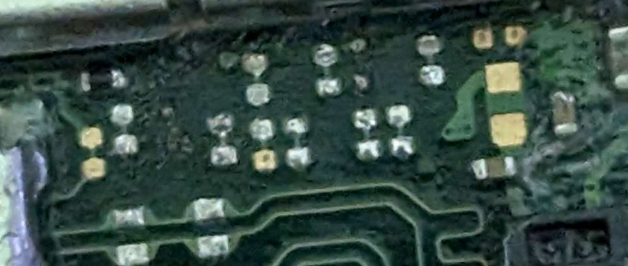

Hi, my current board has exactly as the same missing pads as those shown here (also due to hwfly mod 2nd time round).
Previously, it only have 1 missing pad (ie left pad) and once I bridge it to the pad on the right (which was intac before), the switch boots.
I then tried HWfly mod again but this time, the other pad (ie right pad) ripped off. There was exposed wire so I thought just bridged the 2 exposed pads so I tried by melting a "pool" of solder paste but that didn't fix it.
While doing diode test to make sure the copper are really exposed (get 0.774 and 0.65), I discover that there is a really really tiny copper exposed to ground in the middle of the 2 pads. I didn't want to scratch the middle area too much for fear of exposing the ground too much.
I have just put a small bit of pcb green mask and am going to try bridging it with a very thin wire (vs using pool of solder paste to ensure no short)
Reason why I'm sharing this (before "completing" or actual doing it) is because I'm having a REALLY HARD TIME getting the 0.1mm wire to stick to the exposed copper on the pads.
I thought I'll share this to see if others with the same problem but with better soldering skill (and with better equipments) had tried this (ie bridge the 2 pads avoiding the ground in the middle) to fix the problem.

Success and works!
Just to share:
- I used green pcb mask and masked off the middle (several layers)
- Bridged the 2 points using solder paste
Switch Lite sprung back to life.
In summary, if you lose 1 or 2 or the pads as shown, make sure middle of the 2 pads are not touching ground and just bridge them.
