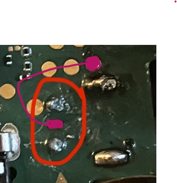

I was unplugging the battery from my Switch Lite so that I could install a mod chip. However I accidentally ripped off the entire battery connector and the middle solder pad with it. I’ve reached out to a few repair shops but they replied and said that they weren’t sure where the solder pad led to. Here is a photo of the damage.
If anyone could help with where they go or what I can do to fix this it would be greatly appreciated. Thanks!

The center wire is the thermistor, jump it from the leg to the test point that appears to have solder on it already... ? Did someone attempt this already?
Ahh! It had solder on it already because I attempted to reattach the battery connector before I realised that a solder pad was missing, and I accidentally got a bit of solder onto that test point.
Thank you for your reply that really helps!!
