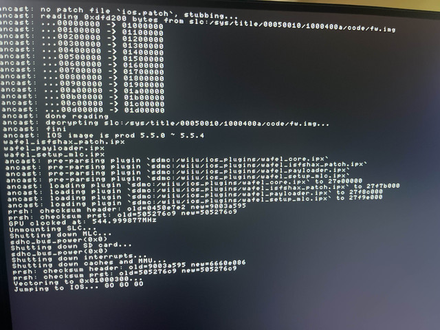

  5. Go back to the main menu and select Patch (sd) and boot IOS (slc).
  6. Wait for the LED to start blinking blue, this means the setup has started. Wait for it to stop blinking, that is when the setup has finished.
  7. Shut off the console and put the SD back into your PC.
  8. Check the wafel_setup_mlc.log file on the root and make sure there were no errors (everything should have 00000000, except for SetInitialLaunch, which will have a 1).
  9. If everything looks right, delete the wafel_setup_mlc.ipx file from sd:/wiiu/ios_plugins.
  10. Boot the console again, select Patch (sd) and boot IOS (slc), and you should be greeted with initial setup. Success!
