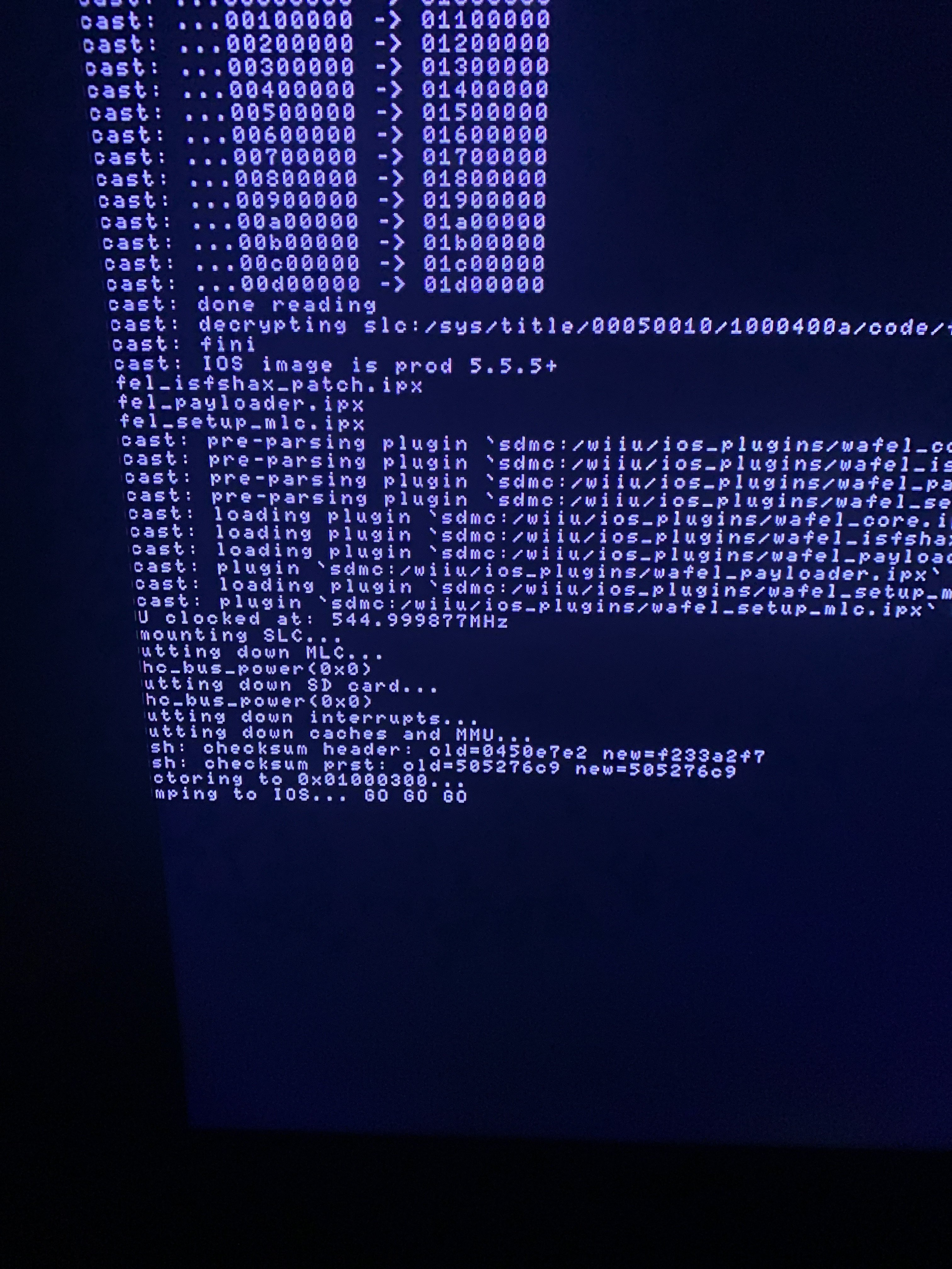

I got it working
but now on the 5th step at the end it says GO GO GO but I havent seen any blue light
This is what I’m stuck on
i forgot to mention the way i got the mlc in my sd card is by copying over the usa folder from the downloader then renaming it

I already erased the scfm.img before so it won’t allow me to erase it again it usually gives me a -1 error. And eMMC im not sure what that is
Hopefully I can fix this issue
This is my sd card, am i missing something?
Make sure the download is complete. e.g. for USA firmware, make sure there are 779 files and 52 folders.
Maybe just move the files, start another brand new download and compare.
eMMC is the MLC. Make sure to use the latest version of minute
I alredy am using the latest version of minute maybe its my sd card?
I can confirm its 779 files and 52 folders and i alredy did a brand new download
What else is their for me to do :(
I might try it with another sd card because i remember when i tried modding my 3ds the sd card wasnt working untill i got a new one
