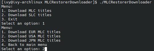

  5. Run the application (ie .\MLCRestorerDownloader for Linux/Mac users). Windows users can just double click the .exe
  6. Type in 1 the for MLC titles.
  7. Type in the number for the region you want to change to (ie 2 for USA).

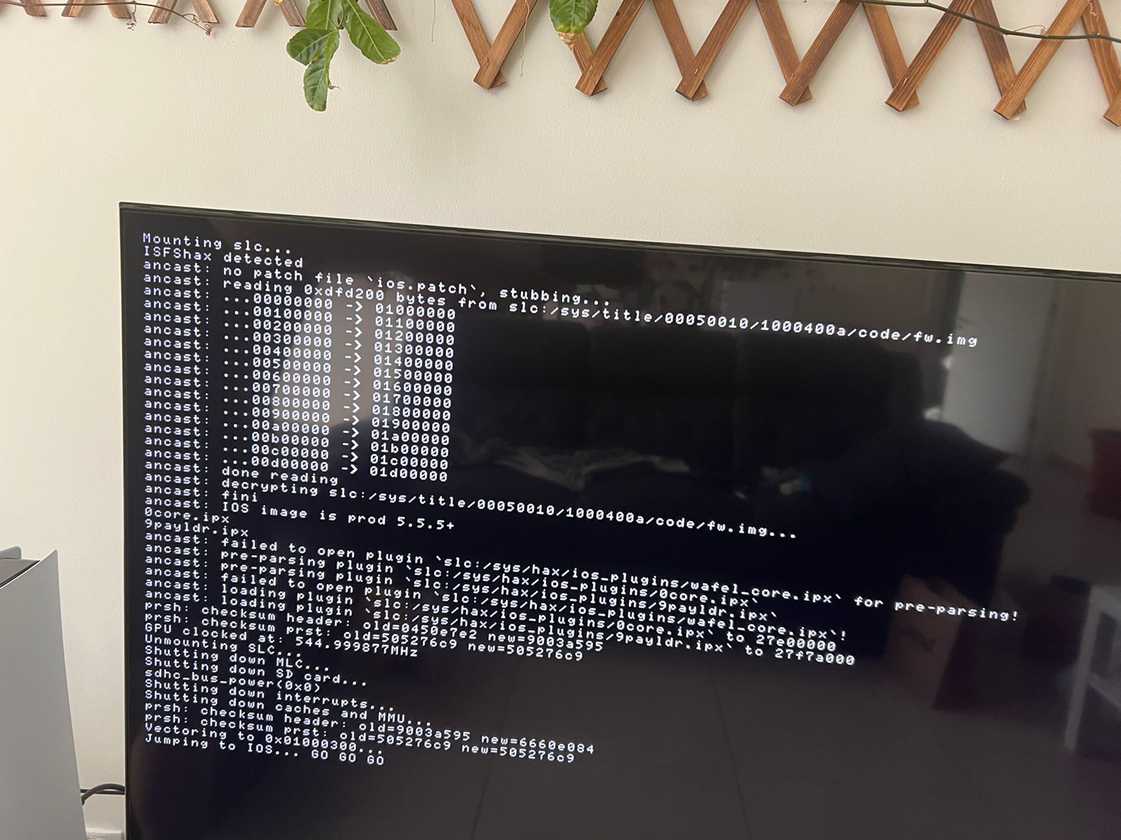

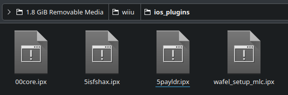

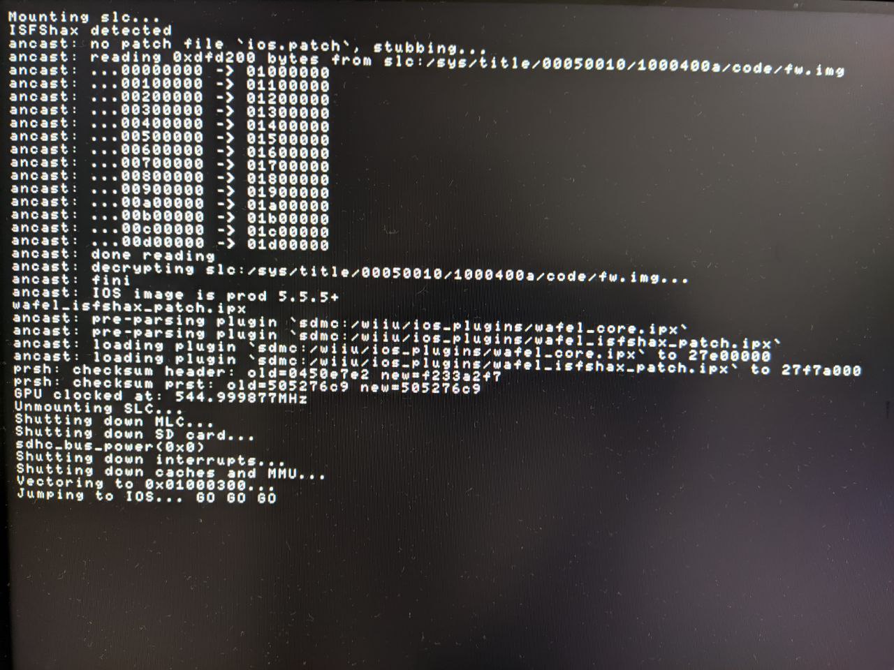

My console is getting stuck at this point:
5. Go back to the main menu and select Patch (sd) and boot IOS (slc).
It stays on this screen (after hearing the disc eject twice) I left it on over night and nothing changed. I also went ahead and redid steps 1-4. Any help?
No log is being created.
Here is my SD card as well.
All 52 MLC inside folder. I even redownloaded them to be sure it didn't miss any.
**Apparently i was missing the wafel_isfshax_patch.ipx from my plugins.

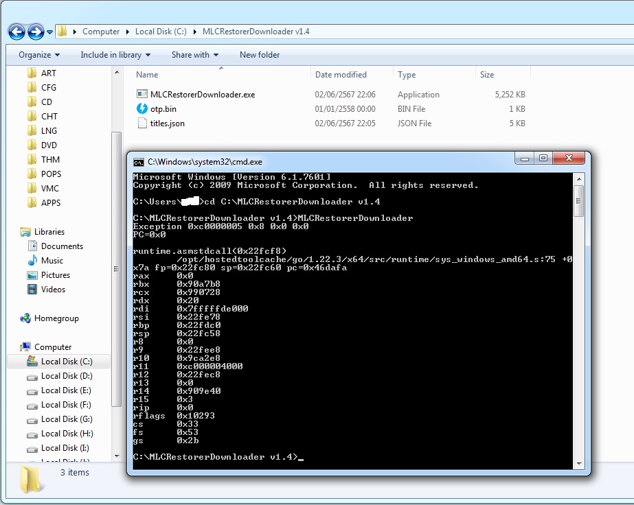

I tried using MLCRestorerDownloader on cmd but I don't understand what to type.
It looks like it crashed for some reason.
Looks like you are on windows 7. Not sure if that is supported by the downloader.
Using Windows 7 on the Internet isn't a good idea anyway, since it's not getting security updates from Microsoft anymore

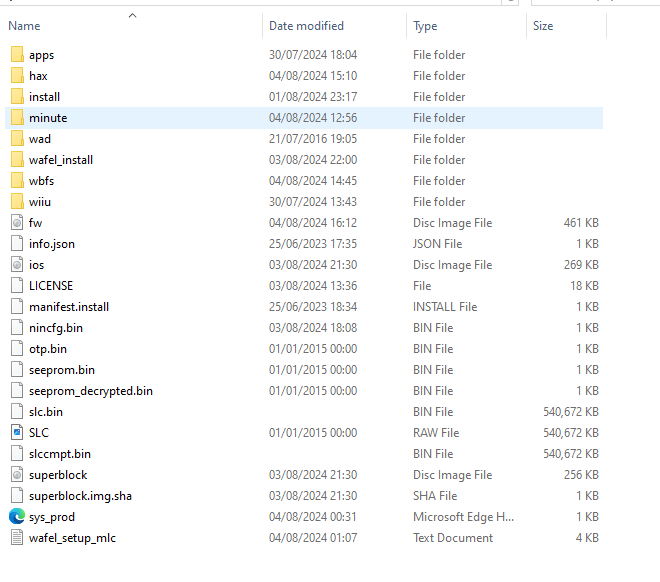

I have looked at changing the region from Mr. Lazr1026, so I know that I didn't have to install the MLC2SD and it worked fine.
After that, I got error 155-0206. A member recommended using UDPIH. Which one should I choose? Because I don't know what happened.
I'm going to go see. Manually fixing the sys_prod
So I see Set region to 2:, FFFBFFEE. That means I have to change the sys_prod manually. correct? Doing JPN system to US.
If I follow the manually sysprod update, do I have to still delete wafel_setup_mlc.ipx before running that?

hey everyone, I am getting the same error shown here. I checked all the ios_plugins files multiple times and everything is up-to-date.
I followed the guide and everything was working perfectly until I tried "Booting without SD" section. Since then, I cant load back in to wii u or get passed the "Patch (sd) and boot IOS (slc)" button
Currently I am trying to delete and re-install MLC in case it would help but can't get past this "abort type: Alignment" error.
Since "booting without SD" had something to do copying the hax folder to the slc, is there anyway I could recover my dumped slc through minute?
Sorry if they are dumb questions, still trying to grasp the procedures

it just looks like you are either missing the plugins on the sd card or the sd card isn't detected.

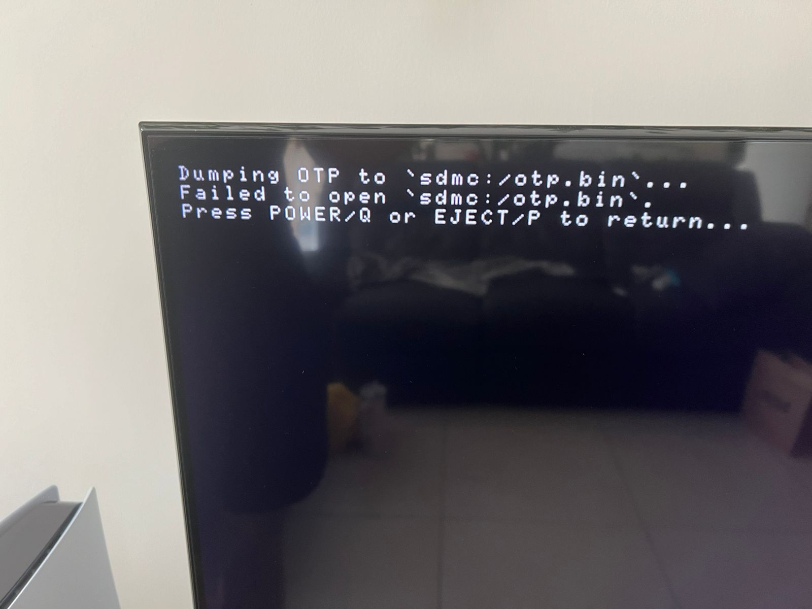

Try dumping otp and seeprom and see if that works or if it gives you also an error.
Also check that you have the wafel_core.ipx in the ios_plugins folder in the wii u folder on the SD.
Also since you copied the stuff on the slc, did you try to just boot the first option, loading everything from slc?
Thank you for all the suggestions SDIO ^^ I have spent the whole weekend wrestling with this.
When I try booting the first option, loading from slc I get to the "Jumping to IOS... GO GO GO" and nothing happens.
It failed to dump otp and seeprom. Does that indicate an issue with the sd card?
All the plugins seem okay :(
You are missing the isfshax plugin on the slc...
And yes that looks like for some reason your SD card doesn't work properly in minute. I guess that has something to do that minute is now loaded from slc so the SD card wasn't initialized by ISFShax. Normally it should work, but the SD stuff is always a little finicky.
You should be able to use the Patch ISFShax and boot IOS (slc) to boot with minimal patches. You can then load Aroma either from the browser exploit or from the H&S app if you had the Payloadloader installed.
Then you can use FTP to add the isfshax_patch plugin to the slc.
We already saw that once in the past, maybe I make a minute later, that allows us to see where it fails.
You could also try another SD card just to see if that makes a difference.
