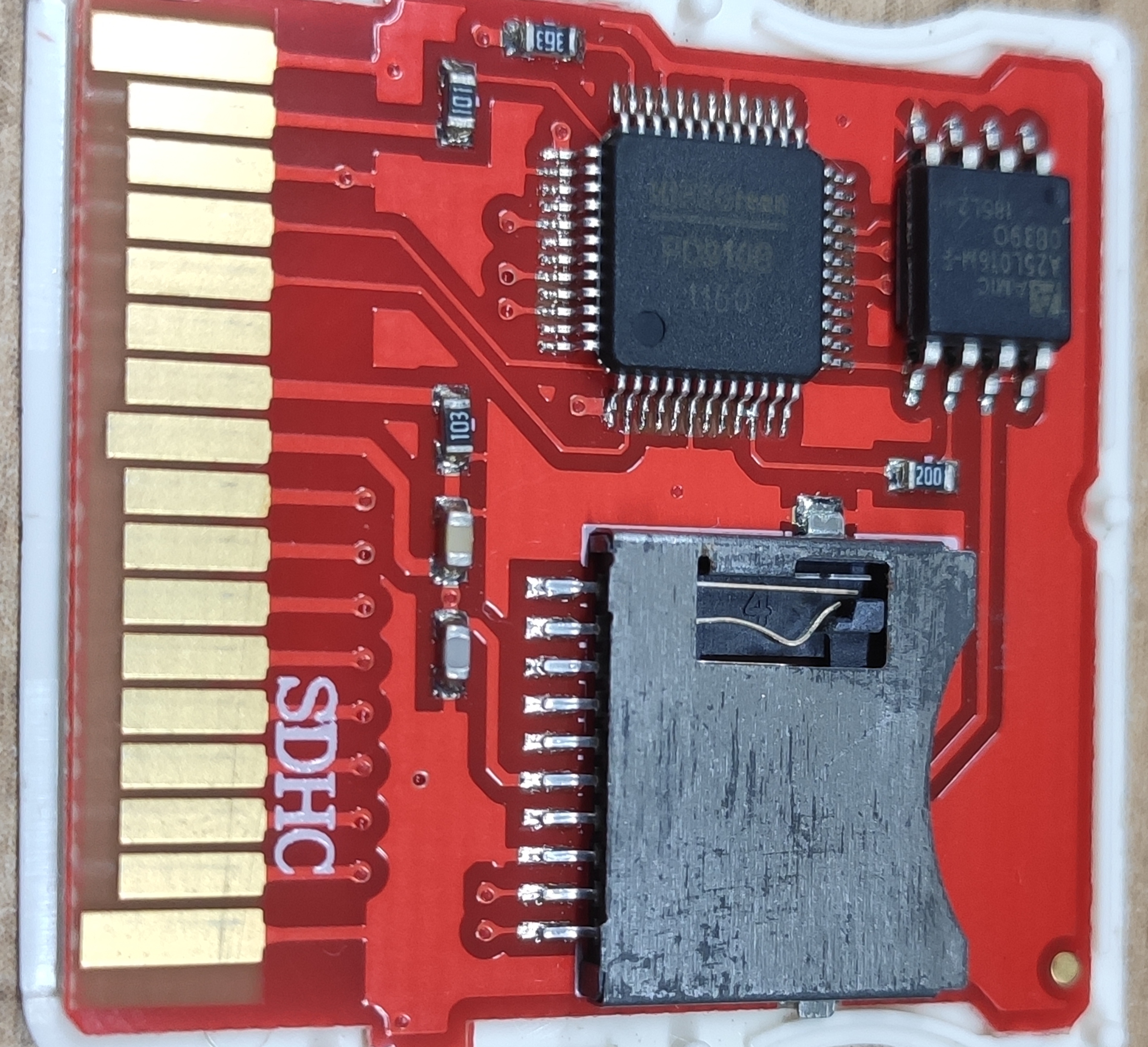

Here is the board.
Here is the board.
And here is the "face" of the card
Here is the board.
I have the original software that came in the sd card because I copied it. But the card is not recognized in the ds or the 3ds.

So I saw a post that said it was able to revive a card by using SPIPGM.EXE to fix it. Although i dont know how to use it. My dad has an Elnec MEMprogL machine and I was wondering how to use the EXE if no one can help me with an easier solution.

Tried reading the chips memory and found out it was wiped. No information was writen inside. After trying to put 2 backpups i found here in the website i gave up. It didnt write the whole backup. always some lines short. Ended up ordering a new R4 card. A gold this time. When the gold gets here ill try the hot swipe with the old card and the .nds file from the r4isdhc on the bad card.
