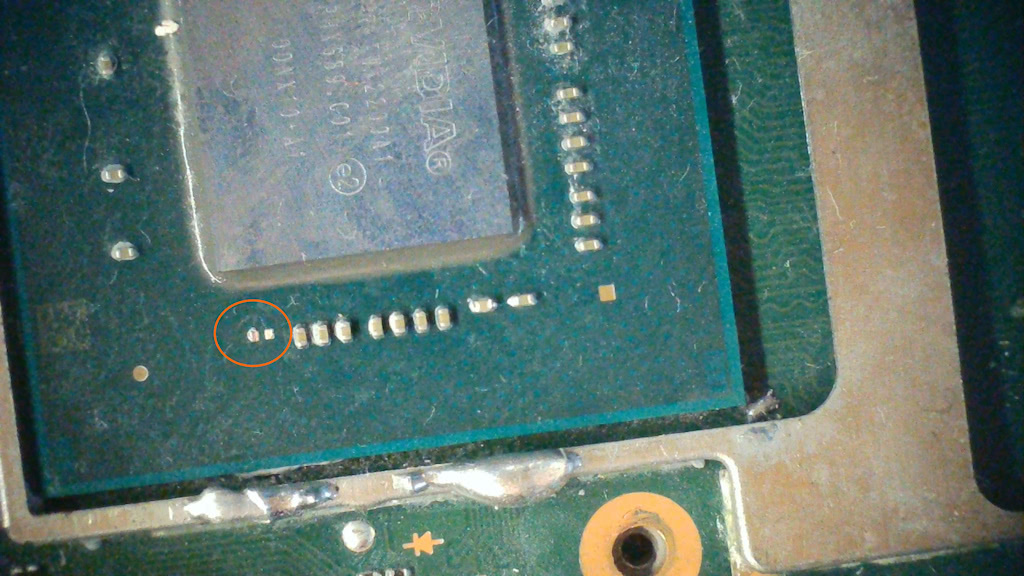

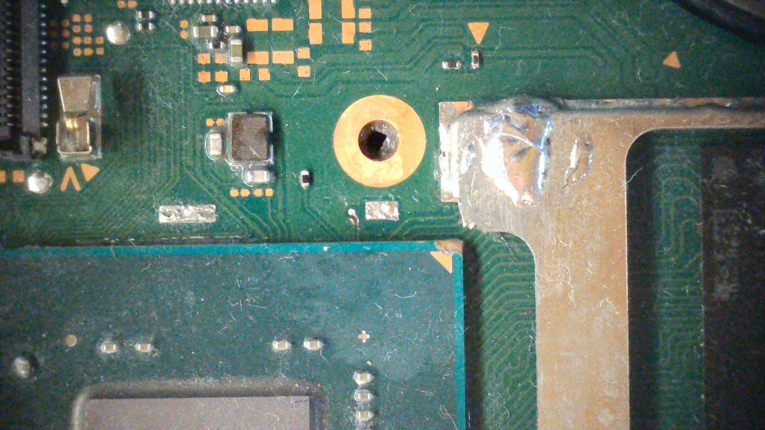

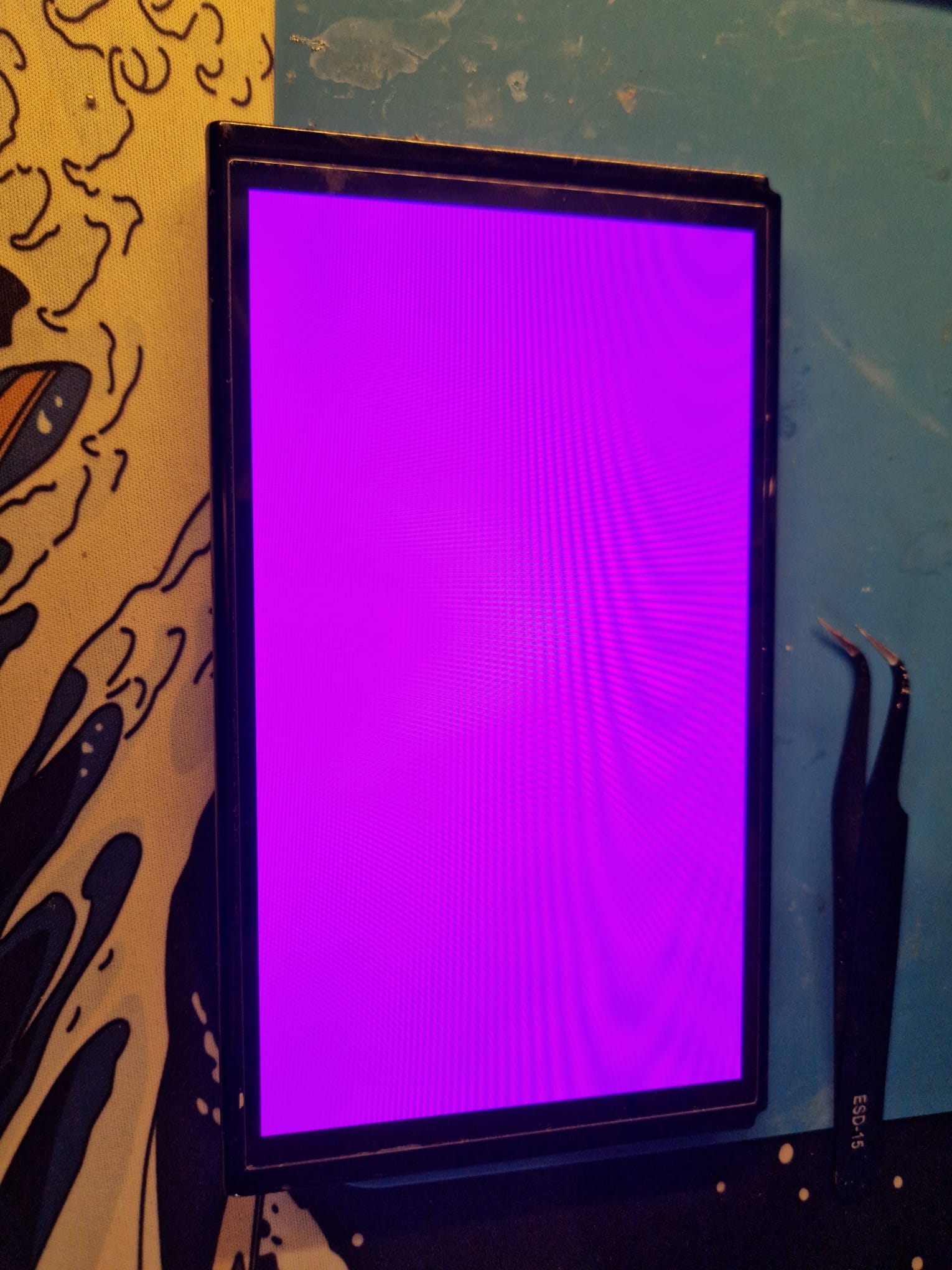

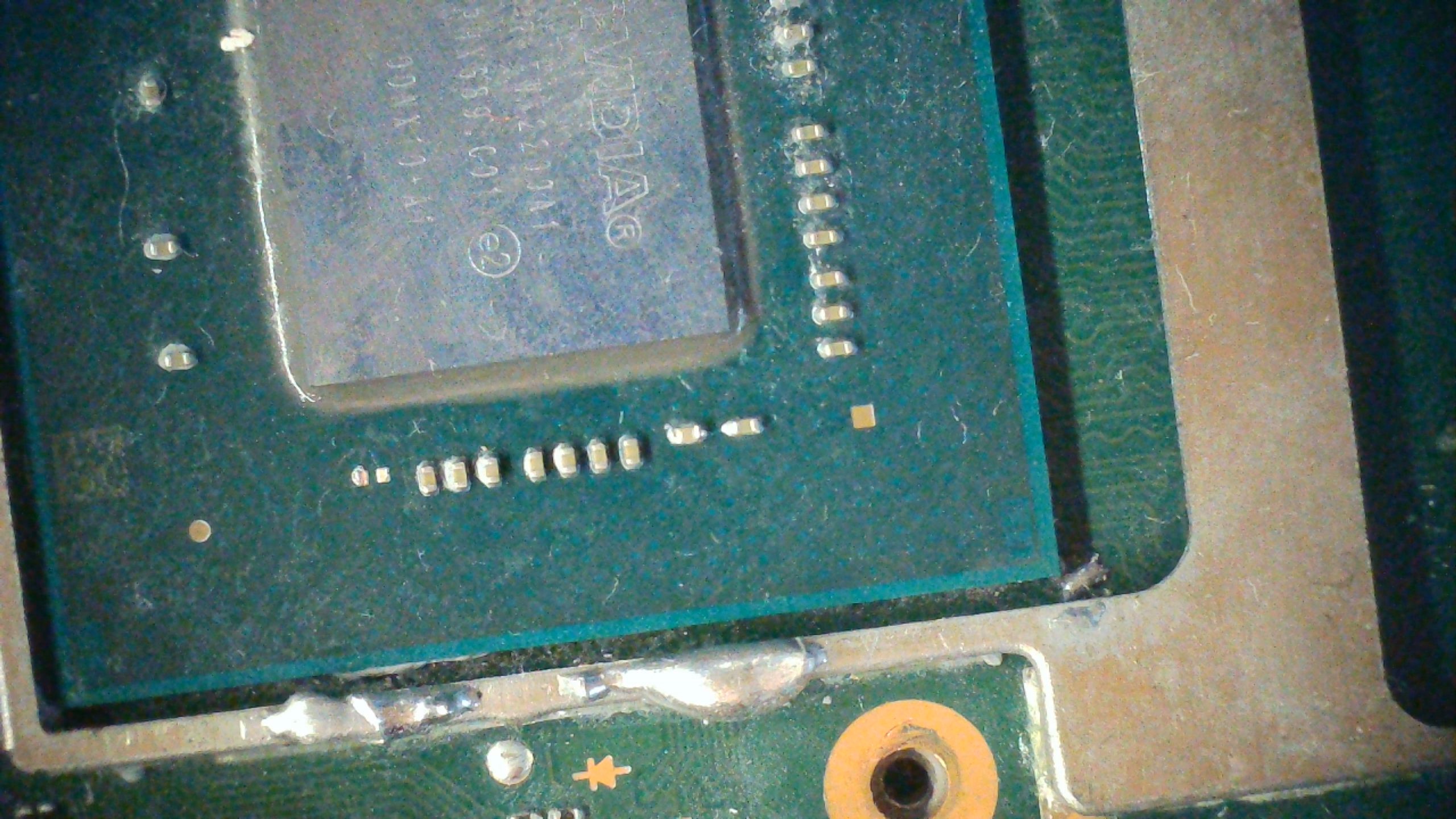

So after installing a new chip and checking all the values in diode mode on first boot the purple screen appeared, purple screen is here also after removing all cables
Before turning on in both occasion i checked the connection in diode mode and they were all good, the sp1 point is not a pr
oblem since i have been running the switch without it for more than 1 months
Before turning on in both occasion i checked the connection in diode mode and they were all good, the sp1 point is not a prView attachment 455108View attachment 455109View attachment 455110oblem since i have been running the switch without it for more than 1 months
The cmd resistor is most likely the cause of the people screen. It's 4.7k ohm 0201. The missing sp1 cap is just a filter from what I've seen and should still be ok without it.
