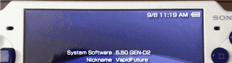

I have a System Software: 5.50 Gen-D2 if that helps.

If your Data Code is below 8B (you can find it under the battery next to the serial number) then go nuts and update to 6.60 OFW, then install PRO-C2 CFW. If you're over 8B, update to 6.20 and install PRO-C2 CFW. All are Googlable.
http://gbatemp.net/threads/how-to-softmod-hack-your-psp.293978/
Take note that you should not install OFW straight away since you're on outdated custom firmware - first you have to roll back to 5.00 OFW and update from there. The thread above will help you with the process.
