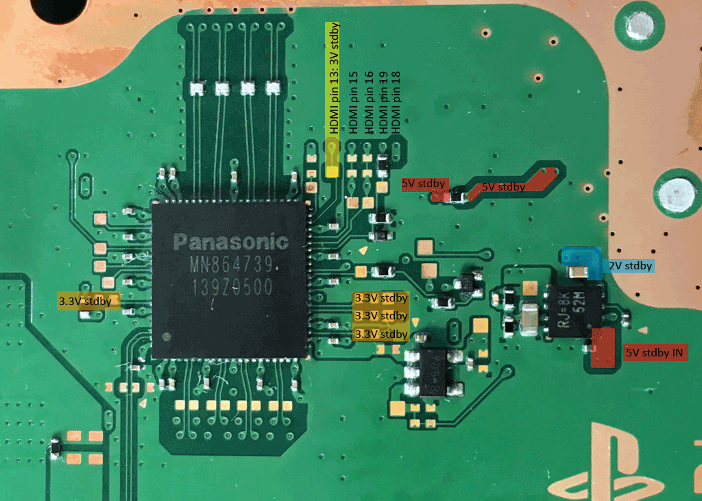

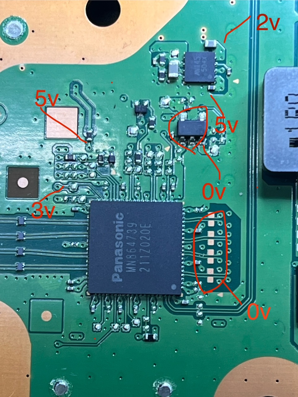

checking carefully I noticed that some voltages standby are missing in the hdmi circuit, I have already tried to change the panasonic chip
those circled are not present.

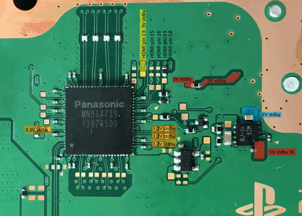

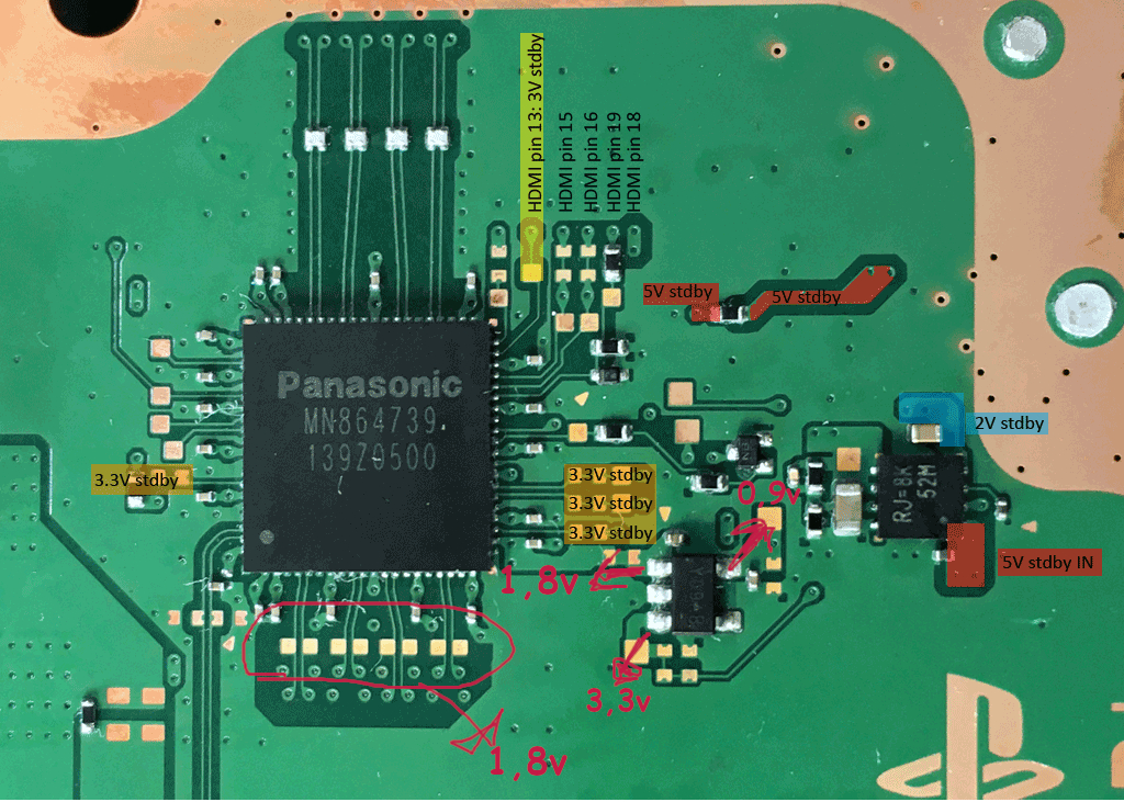

Could be a major change in this ciruit at the edm-03x boards. But from my previous messurements as shown in the image, the 1.8V are not present in standby and are not switched on by the southbridge before 'Start'-button is pressed.

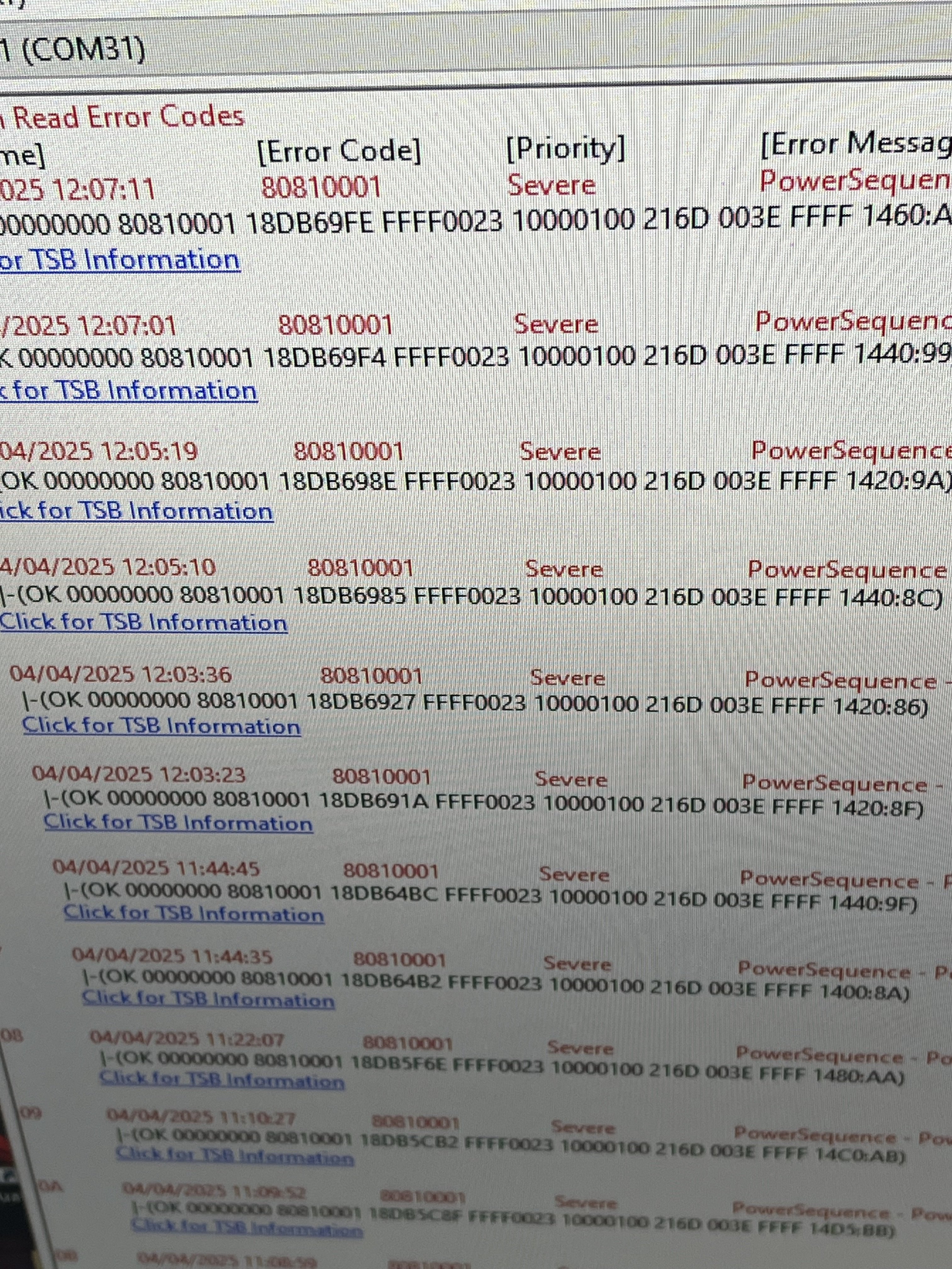

Hi could you help please.I have the same 80810001 but the prefix is 213C what does it mean?
Thank you in advance.
