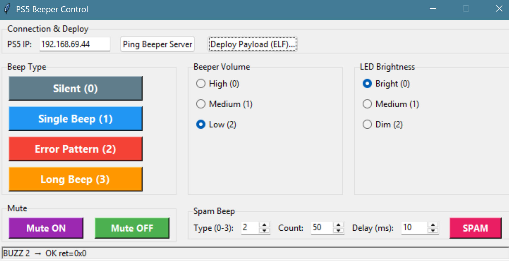

beeper_server.elf + beeper_gui.py​
A persistent TCP server payload (beeper_server.elf) and a Python tkinter GUI (beeper_gui.py) are included for interactive control over the network. Deploy the server to your PS5:
make deploy PS5_HOST=192.168.1.x
Or use the "Deploy Payload" button in the GUI. Run the GUI:
python beeper_gui.py
The server listens on port 9111 and accepts newline-terminated commands:
CommandEffect
BUZZ <0-3>sceKernelIccSetBuzzer(n)
VOL <0-2>sceKernelIccSetBuzzerDimSetting(n)
MUTE <0-1>sceKernelIccSetBuzzerOffSetting(n)
LED <0-2>sceKernelIccSetDynamicLedDimSetting(n)
QUITShut down server
Response format: OK ret=0x0 or ERR
