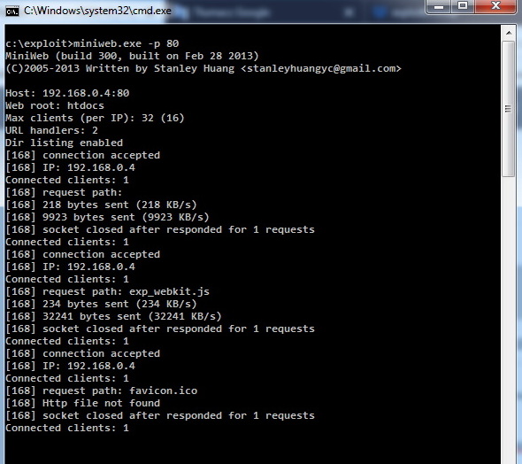

If anyone have ERROR CE-30391-6 and have 6.72 firmware in PS4 and don't want to update to the latest version and don't mind wrong time and date, use HEN version 2.1.3b.
Download 6.72 Leeful v8 from link to Dropbox: (uploaded by me):
https://www.dropbox.com/s/w84zze5hfbz944t/exploit6.72.zip?dl=0
Extract, go to folder name "exploit" and run exploit.bat.
In new terminal window You see HOST: xxx.xxx.xxx.xxx:80 x's is Your ip address to write in URL BAR on PS4 web browser (without :80 - this TCP port number default for http protocol, its mean not nessesary to write).
PS4 and PC/LAPTOP must be in the same network.
Tested on Win7 x64, used by me in my workshop.
