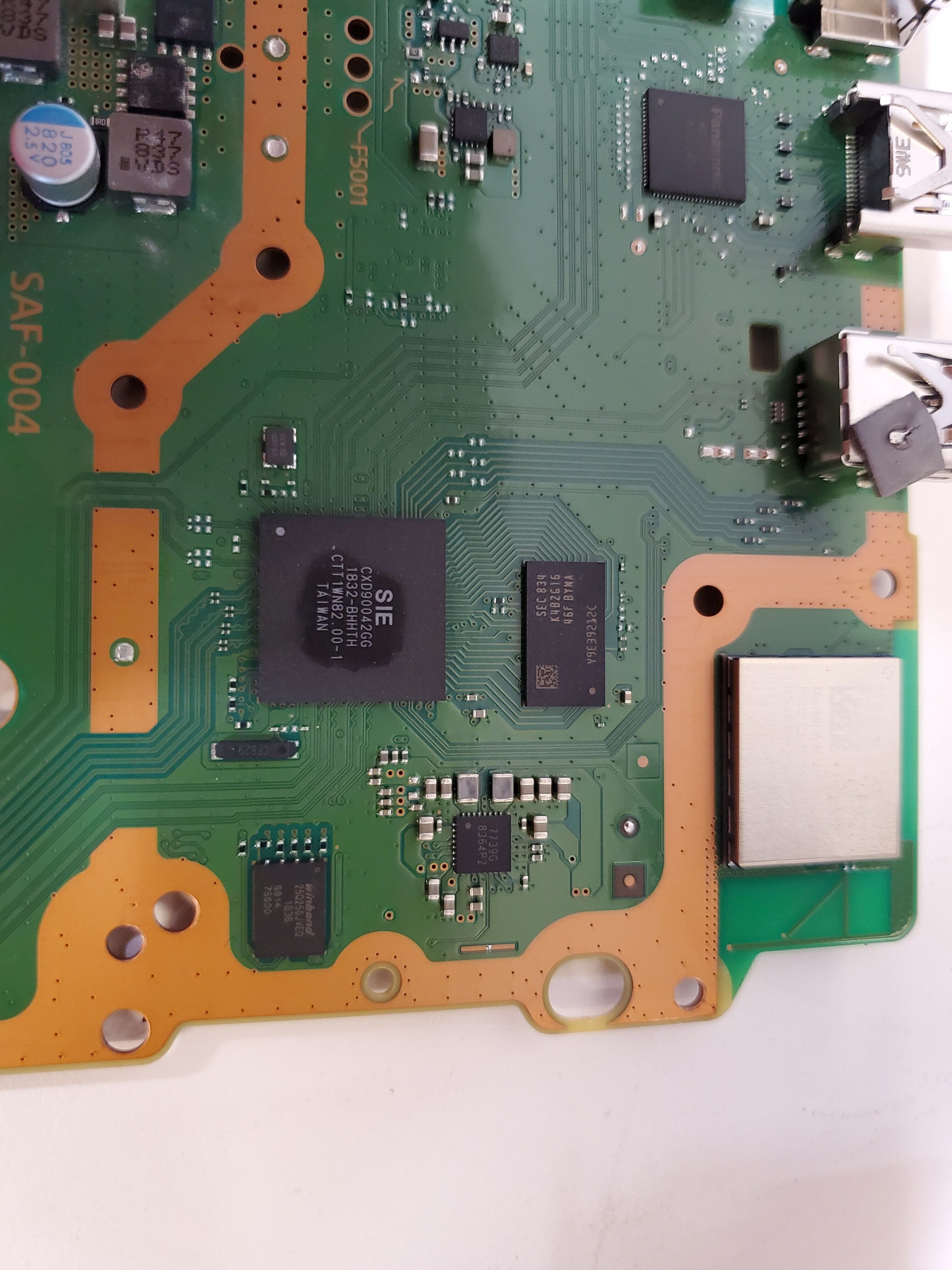

I'm wondering if the Southbridge IC on your motherboard is CXD90042GG? (it's the chip in the picture below)
Reactions: Amrun522
I don't think so, but every time I had PS4 Slim with a failed CXD90042GG revision chip (that wasn't turning on, and I had to replace it), afterwards I was greeted with the same error, so it's interesting that you've having it on a virgin system, and i'm starting to wonder if this error only occurs on PS4 Slim systems with this particular revision of the board, because most Slim boards use CXD90036G chip (like the previous PS4 model, which was CUH-1215A), and I've never encountered this error on those models, though they are very similar in board architecture.
So, if you can check which model of this chip you have - that would be very helpful to know
It looks like I do indeed have that same chip. Attached a photo as well. What did you end up doing to fix that error?

I've ended up replacing the crystal (on the left side of the chip), and the black rectangular component on the right, and it worked fine after that (obviously you need to have a spare board to fix this)
Reactions: SCORPlON
Thanks for the reply. Was it these 2 components? I don't have a spare board but I wonder if we can identify the components, I can order them from digikey or a similar chip merchant? Otherwise I can pick up a dead board on ebay I suppose.

yes, those are the right components, but I wasn't able to identify them, and it might be quite hard to find a dead board on ebay, because you need it to have the right Southbridge IC (and those are not that common), plus broken boards are not that cheap. If you can't find the replacements, let me know if you want to send the system in for repair to get it fixed

make sure to use hot air station (at 425C/110LPM) to remove and replace the components, do not use soldering iron for this because it will damage the board and components
Yes, I have a Hakko station. I've already removed the components and sent them out to my sales rep at digikey for identification. Haven't been able to properly identify them myself there or at mouser. If I do get them identified, I'll update the thread.
any picture of those components would be quite helpful to identify them on spare board.
