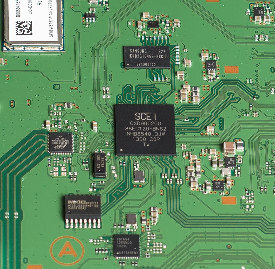

Maybe it is possible to solve the problem by making a reflow on the 2 components?
Which 2 components to reflow ? I have a CUH-1004A ps4 fat which has different components than Slim version which was talked about previously in this thread. If you find out what components to reflow on my board. I can try it a give you report on if it helped or not.(I have smd rework station.)

Hello, I'm having the same problem. My console is CUH-1004A ps4 fat. Southbridge is CXD90025G. System Software 6.72
tried:
Replaced CR2032 battery
Rebuild database
Initialize ps4
after ps4 turns off and I unplug the cord, time will set to 1:00 and date to the year 1970.
I also tried recent 6.72 JB+ MiraHen and on some apps/games it freezes the screen and I have to reboot it. On others it takes longer time to display the error code and it just logged outs me.
I think the problem has to be that Mainboard doesn't receive 3V from the battery.
Does someone have a schematic of PS4 trace lines ? or know where those 3V from the battery go ?
I will be very thankful for any suggestions.

So I did some research again and found some clues what might be wrong and possible solutions. Basically Real Time Clock (RTC) is not functioning which throws a flag and it prevents some games from launching (games will launch but after a while it throws error). So it doesn't really like clock issues. If you replaced battery and it's still not working than problem might be between southbridge and the battery( my guess it goes through a crystal which may go bad). I haven't yet tried identifying the crystal but it will be my last choice. Currently I am waiting for a Kernel Clock payload(originally made for reactivating expired PS+ games) to be ported on 6.72. This payload might help this problem but it is just a guess. Another possible solution although to me highly unlikely is to check and if bad repair NOR chip. ( gbatemp net /threads/ps4-nor-chip-repair-that-displays-signs-of-a-blod.569955/#post-9132816 ) Also found out that all Demo games, Homebrews, PS2 games work without a problem so maybe it has something to do with license files? Correct me if I am wrong and please share your findings and theories.
Hello everyone, i gave up with this issue. I don't think kernel clock payload will fix this issue as it will only display the clock on your screen permanently (just based on what I understood).
By giving up on this issue as I really got frustrated, I updated to latest firmware (Coming from 6.72 FW Jailbreak and yes, it really hurts). To my surprise it worked as soon as I booted from 7.51, clock has synced without even setting up the internet yet. I also tested a disconnected internet and shutting down the PS4 overnight and the clock still remembers my time. (I also have the issue of newly replaced CMOS Battery)

I tried to reflow the southbridge but nothing, still this damn error.
If anyone resolves please post the solution
Did you tried reflowing components surrounding Southbridge too ? What PS4 model do you have ? (CUH-XXXXX)
