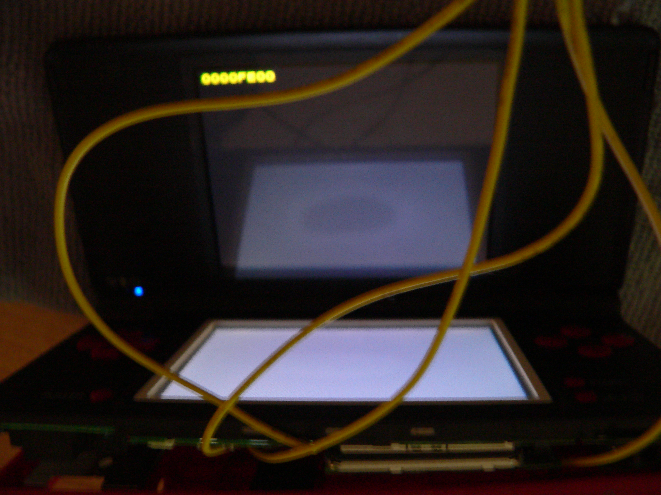

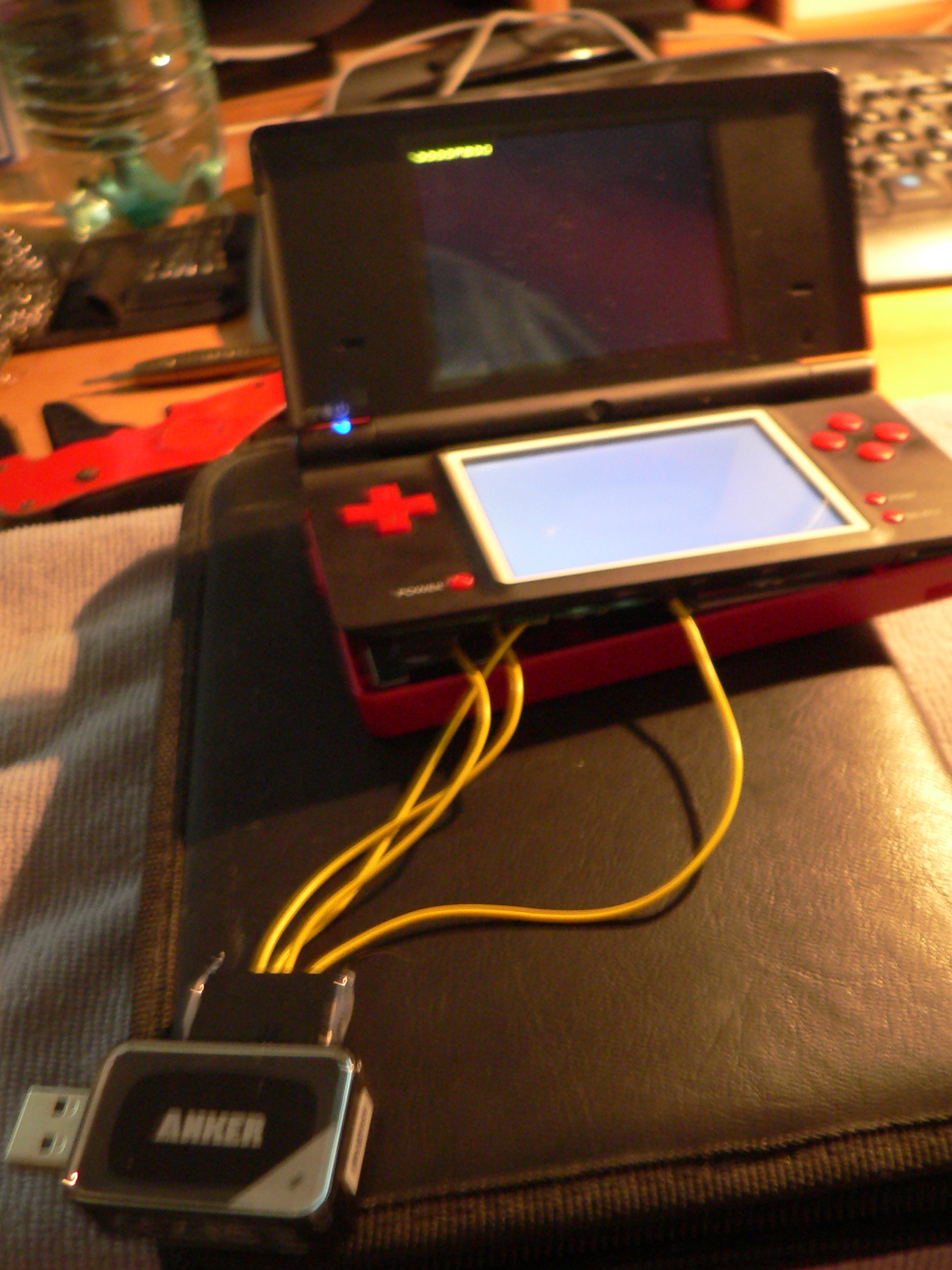

Update:
- soldered the SD Adapter
- soldered the DSi
seems ok,but no Device detected in Windows
Tried 3 different Card Readers included the recommended Anker Modell.
Tried 2 Windows 10 (32 and 64bit) and Windows 7 (32bit).
Tried different USB Connectors (Front/Rear)
Tried first connect the Reader/SD Adapter and powered the DSi on and vice versa.
A little Pictures (do not expect Profi Work please....):

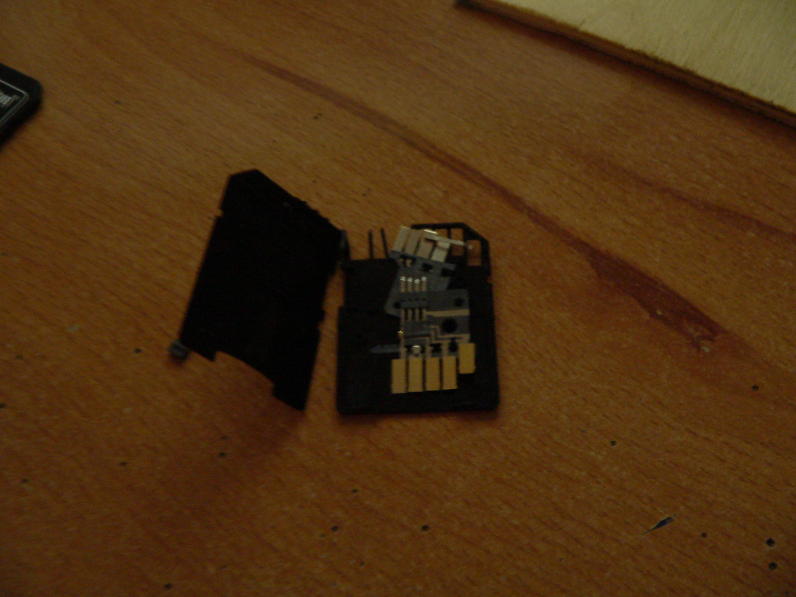

A little Word about microSD Adapters:
"Some" says,there are no Difference.....
maybe...
The first was a SANDISK and it brokes after Opening....
Thank you for Reading.:)

Can we get a better picture of the motherboard? Your camera is not able to deal with low light situations and has far tooooo long exposure times for holding it in your hands
Either use a tripod with self-timer to minimize in-movement unsharpness… or more light (best go outside and use bright daylight).
As you already know: I failed trying to solder to R113 and lost the resistor.
Reactions: ManuEcheveste
Did you get the Screen with "0000FE00" ?
Anyways,Project is actual "dead"...
(PM,Sinchen).
(PM,Sinchen).
Yes. As far as I know the bootloader error is expected while the DSi is connected to the computer. Though I've read from hardmod attempts that resulted in permanent error even after removing the cables (NAND shorted while trying to connect to computer??)
I can't even continue my attempt until I get a new resistor and/or another cheap motherboard. Not a big loss. My test DSi was pretty much unusable before my failed soldering attempt. Great way to get some experience anyway.
