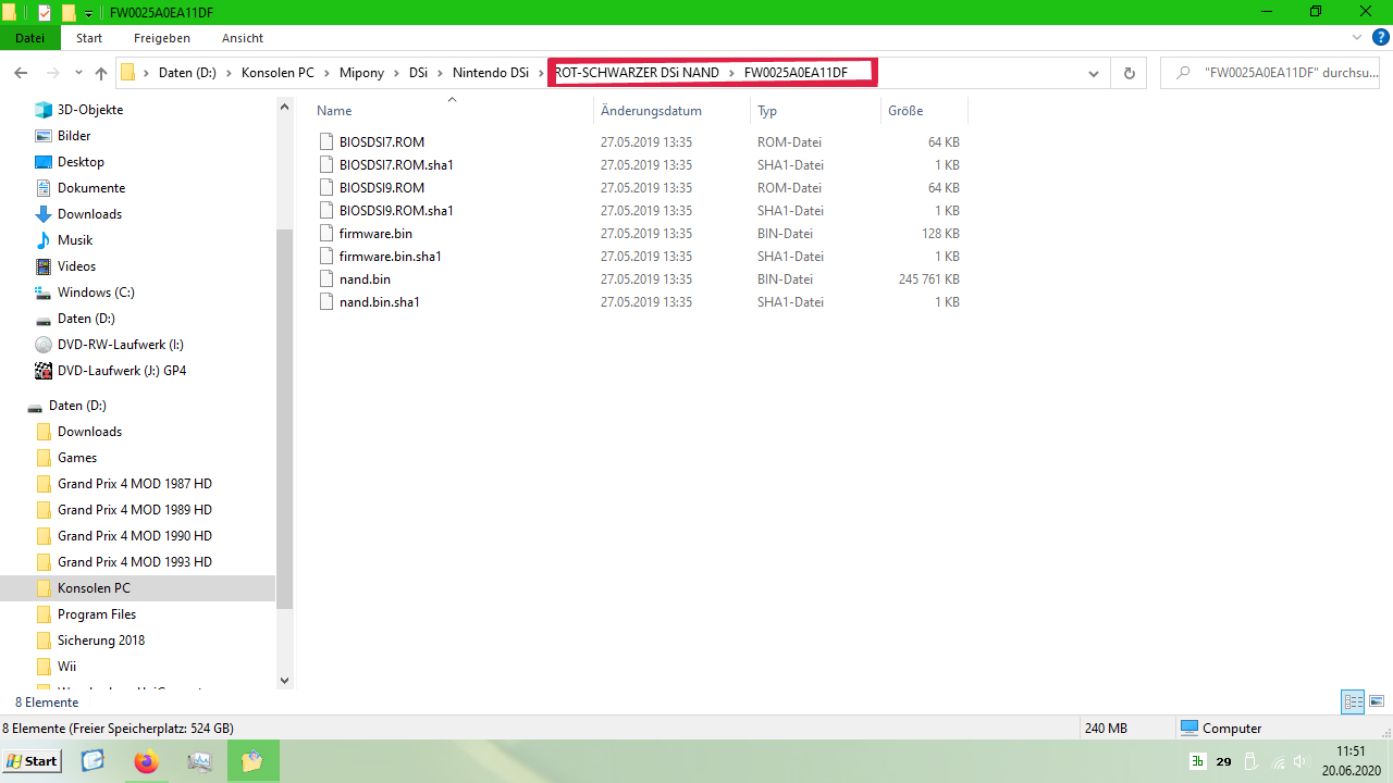

I can do a HARDMOD,I have NAND Backups....all is ok.

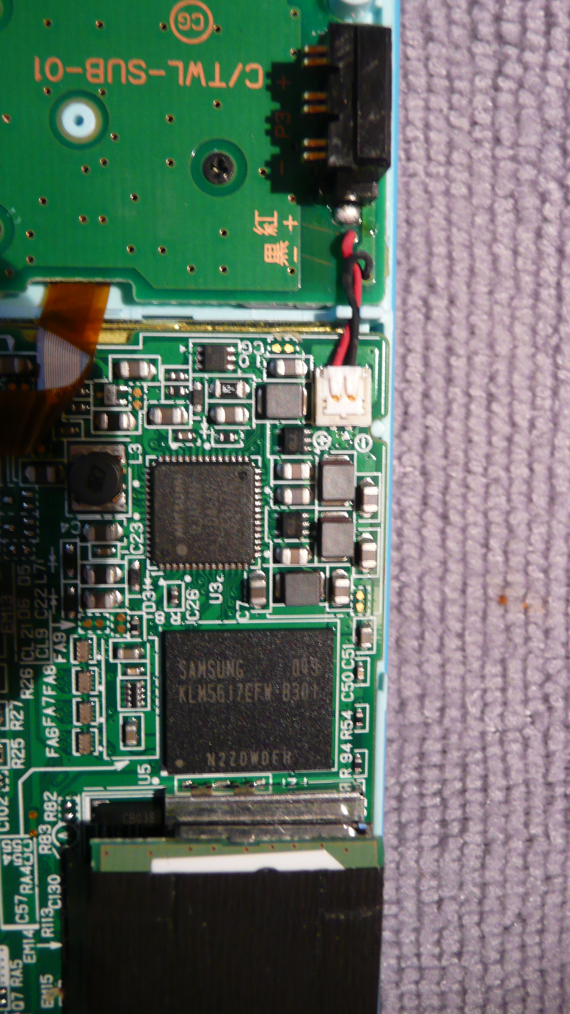

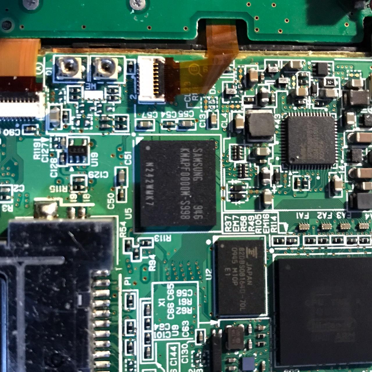

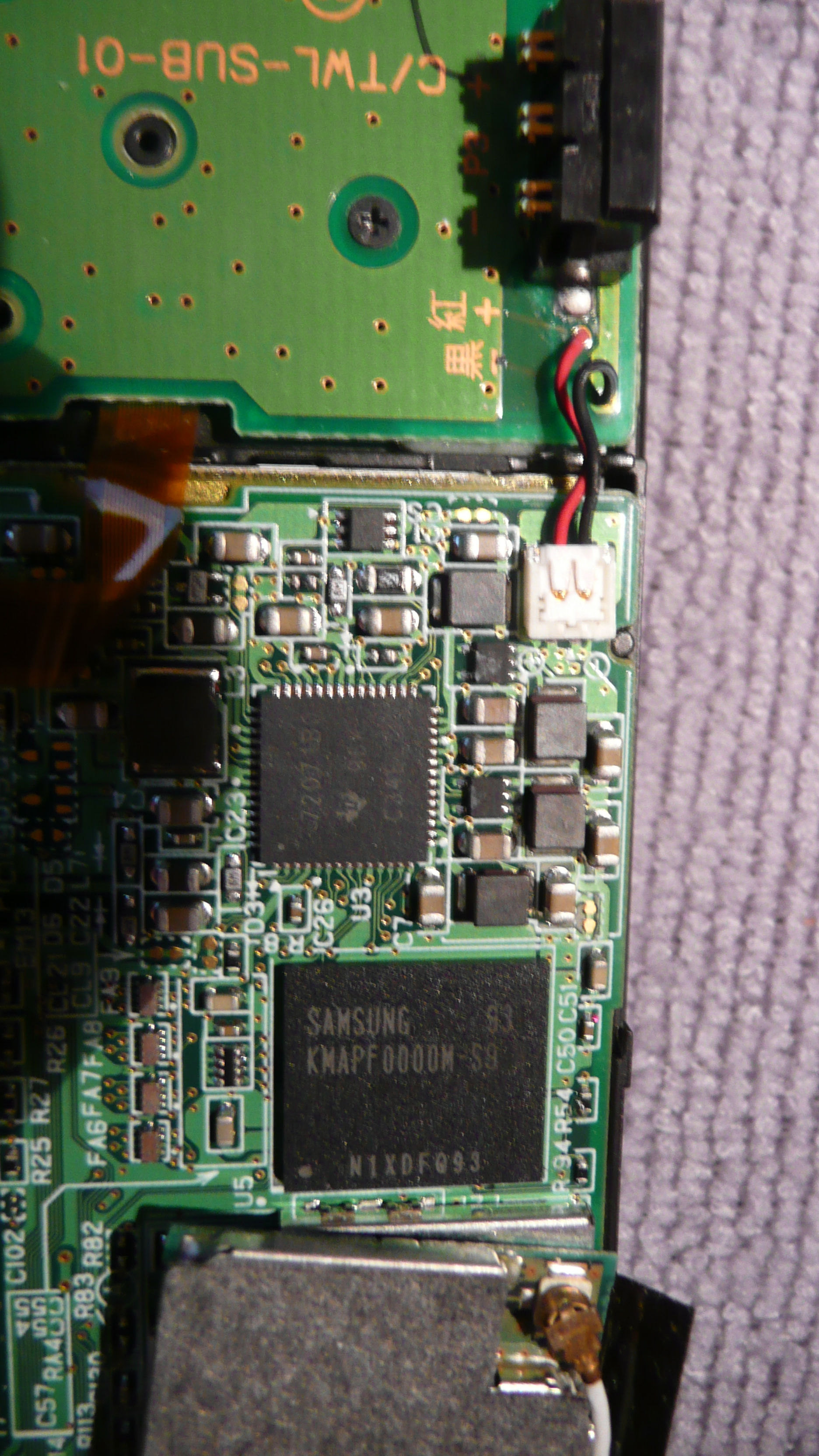

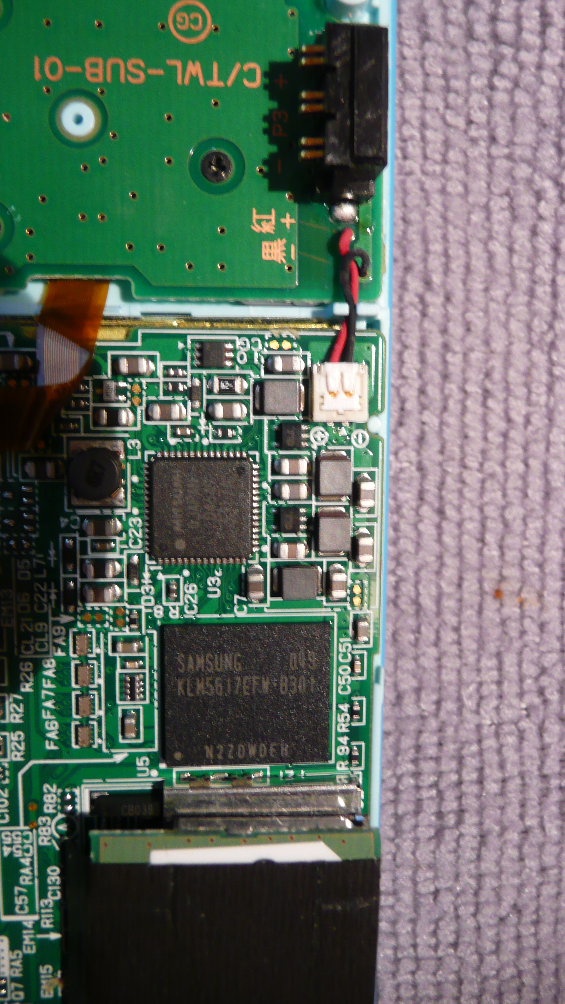

Blue DSi original:
Black/Red DSi (assembled from 2-3 broken DSis)
Two different Samsung NAND chips.
