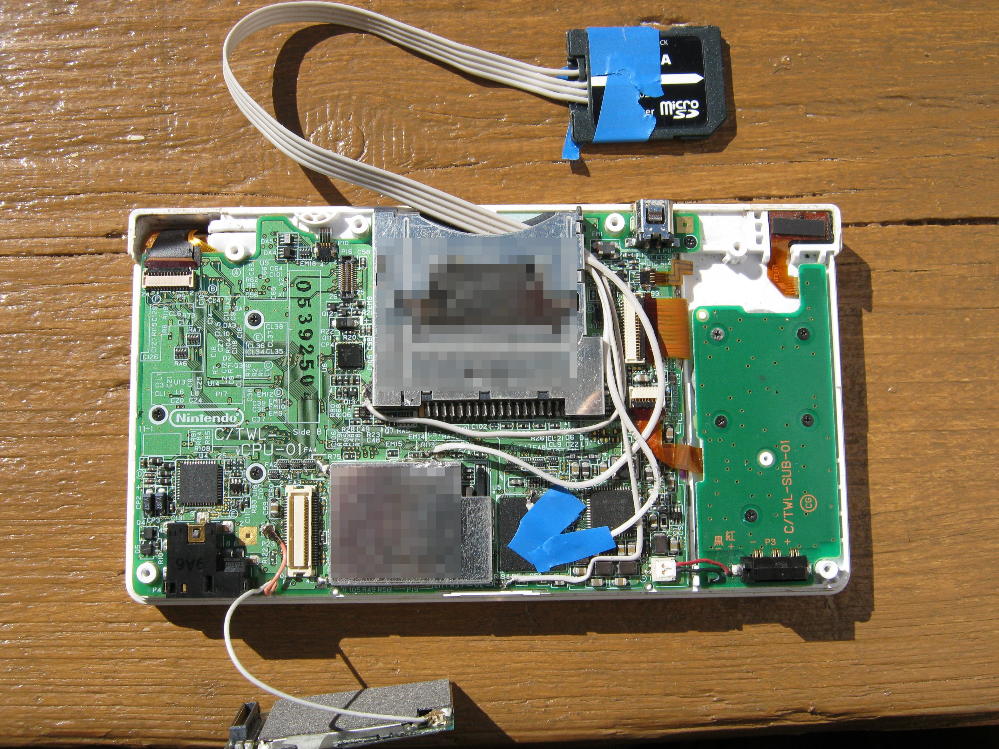

Good news everyone! I now have a working DSi hardmod. The poor thing actually survived the mistreatment with the soldering iron. After finally getting some 120Ω resistors the console finds its NAND once again. So does the computer. Reading the NAND was possible. Tests (including writing to NAND from PC) will follow as soon as I'm able to do it (if my very fragile setup does not fail).
root@riesen-klappi:~# dd if=/dev/sdc of=dsi3.dd bs=1M
240+0 Datensätze ein
240+0 Datensätze aus
251658240 Bytes (252 MB, 240 MiB) kopiert, 51,5254 s, 4,9 MB/s
root@riesen-klappi:~# md5sum dsi.dd dsi2.dd dsi3.dd
68216e3917c3b51bf1e80e63c128f6a0  dsi.dd
68216e3917c3b51bf1e80e63c128f6a0  dsi2.dd
68216e3917c3b51bf1e80e63c128f6a0  dsi3.dd
Sorry for German language in terminal output I guess it's clear what the output means. Took the image three times and md5sum is the same each time.
Speaking of images… how about a photo of this? I did everything wrong. My cables are far too thick (old IDE cable), far too long, not single wire, the soldering job is done very poorly. But it seems to work for now.
Slow connection warning: 3.3MB photo:

Good news everyone! I now have a working DSi hardmod. The poor thing actually survived the mistreatment with soldering iron. After finally getting some 120Ohm resistors the console finds its NAND once again. So does the computer. Reading the NAND was possible. Tests (including writing to NAND from PC) will follow as soon as I'm able to do it (if my very fragile setup does not fail).
I guess it's clear. Took the image three times and md5sum is the same each time.
Speaking of images… how about a photo of this? I did everything wrong. My cables are far too thick (old IDE cable), far too long, not single wire, the soldering job is done very poorly. But it seems work for now.
Slow connection warning: 3.2MB photo:
Congratulations !! :toot:
Finally a Picture !! Thank God.:bow:
We are very grateful for this Contribution,Sinchen.
Thank you very much for your outstanding Work and Endurance.:)
