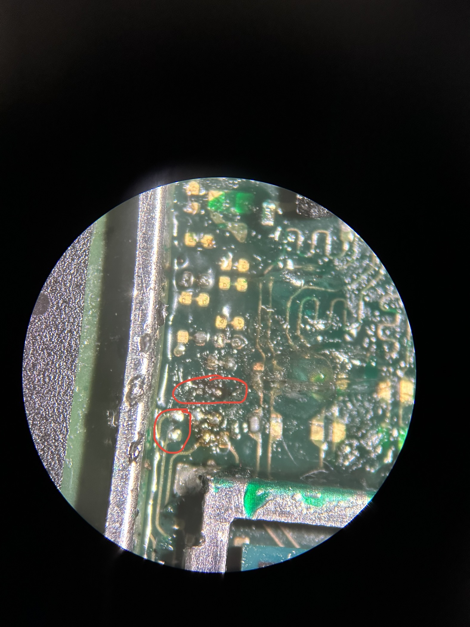

Can somebody help me, i‘ve broken the pads for clk and somehow even lost the resistor? next to it. Is there an alternative point so i can fix my switch and what is the value of this resistor/diode?
can you clean those pads up more. If its the left most pad you are screwed but if it the right pad, you are lucky... as for the resistor idk
We are on the same boat hahaha... same thing here
100 ohm resistor, I believe. Happen to be working on a Lite and this made me finally solder needles to the end of my DMM probes to check @Dee87 ;)
